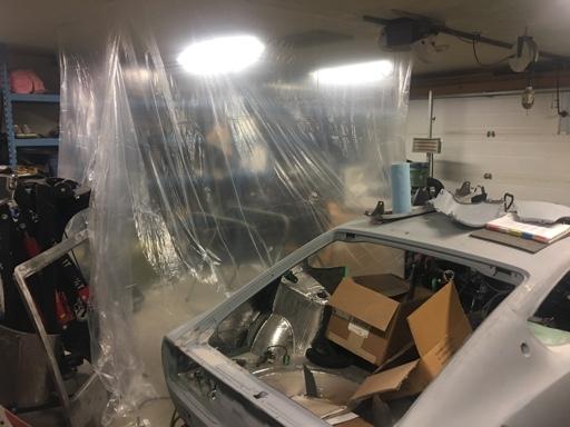

October 2, 20195 yr Author comment_585025 Well now that temperatures are below freezing, I have got the furnace tuned up and the shop ready for some paint work. I will use the small paint booth I set up here to prime and prep all the panels. I may end up doing the finish paint on the interior sides of the panels so they can stay mounted for finish body work and final paint. I lose sleep over this sequence. My gut tells me that having the panels painted and mounted for final body work is the safest bet. No more welding and dollying etc. Just final finish smoothing and filling. Then I can paint the whole car assembled and blend the paint seams where it meets finished paint on edges etc. Link to comment https://www.classiczcars.com/forums/topic/50908-1976-280z-restoration-project/?&page=230#findComment-585025 Share on other sites More sharing options...

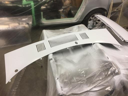

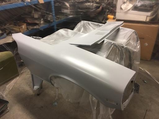

October 6, 20195 yr Author comment_585246 A little 2K epoxy work tonight. This is a good start! One full mix did a front fender, cowl and centre valance under the rad. Hood, hatch, fender, two doors to go! Link to comment https://www.classiczcars.com/forums/topic/50908-1976-280z-restoration-project/?&page=230#findComment-585246 Share on other sites More sharing options...

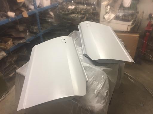

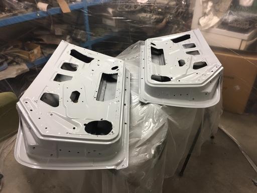

October 6, 20195 yr Author comment_585251 Half of two doors now... had to do a little more spraying while I was in the mood. Still some repair work with fibreglass filler needed on these doors but nothing outrageous. Mostly pinholes on the bottom trailing edges. Link to comment https://www.classiczcars.com/forums/topic/50908-1976-280z-restoration-project/?&page=230#findComment-585251 Share on other sites More sharing options...

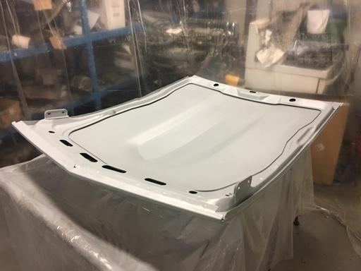

October 9, 20195 yr Author comment_585382 A little more hood work...And doors! Link to comment https://www.classiczcars.com/forums/topic/50908-1976-280z-restoration-project/?&page=230#findComment-585382 Share on other sites More sharing options...
October 9, 20195 yr comment_585394 9 hours ago, wheee! said: A little more hood work... And doors! How do you get into the nooks and crannies of specifically the hood? I'm getting ready to prep/paint one now and want to prevent rust the best I can Link to comment https://www.classiczcars.com/forums/topic/50908-1976-280z-restoration-project/?&page=230#findComment-585394 Share on other sites More sharing options...
