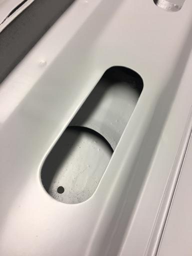

How do you get into the nooks and crannies of specifically the hood?  I'm getting ready to prep/paint one now and want to prevent rust the best I can
I scraped with a small flat scraper as best I could, then pushed a piece of sandpaper around with my finger. Not perfect but okay.
I will try and sand the primer a bit too to make it look nicer. Best you can do really.

Also you can rotate your fan pattern down to a small round dot and turn down the paint volume. If you dont reduce the volume alot you will have sags and runs. Keep a piece of cardboard close by for testing spray patterns and volume. That makes it easier to shoot down inside the holes to get it further inside the structure. Before I did any of that I used Eastwoods internal frame spray cans with the long tubes to help coat the insides of the structure on the hood and many other places on the car.

Thanks, I've really only spray painted.  There's a shop in town that will put "real" 99% VOC car paint in a spray can for you, and it ends up looking really good.  Another option might be to sand the loose rust (if any) and use the POR-15 brush on system with a small brush.  I used that stuff on my last car and it actually worked great and stopped the rust from spreading.  I think it's similar to some Eastwood products;  the tubes on the spray can is a great idea as well
The spray bomb cans are better than regular spray paint, but no where near the same as being able to spray from HVLP guns for consistency and quality. POR will do too, but the under hood area will be highly visible when the hood is open, so I am going for a proper colour finish in that area.
