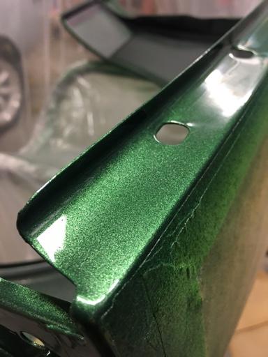

wheee! Posted October 22, 2019 Author Share #2815 Posted October 22, 2019 Found a run I didn’t see last night. It’s in the green so, oh well... Link to comment Share on other sites More sharing options...

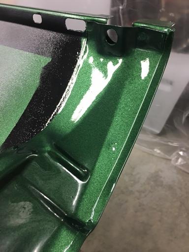

wheee! Posted October 22, 2019 Author Share #2817 Posted October 22, 2019 Did the inside edges of the drivers side fender tonight. Took three hours to sand, mask, clean and paint/clear just those edges... slow process. But I think it came out very nice! Link to comment Share on other sites More sharing options...

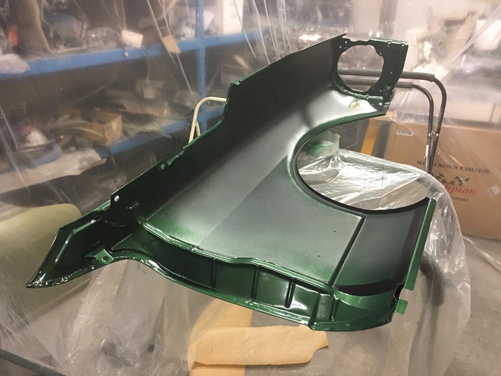

wheee! Posted October 22, 2019 Author Share #2819 Posted October 22, 2019 Oh my... So happy with the finish! 4 Link to comment Share on other sites More sharing options...
