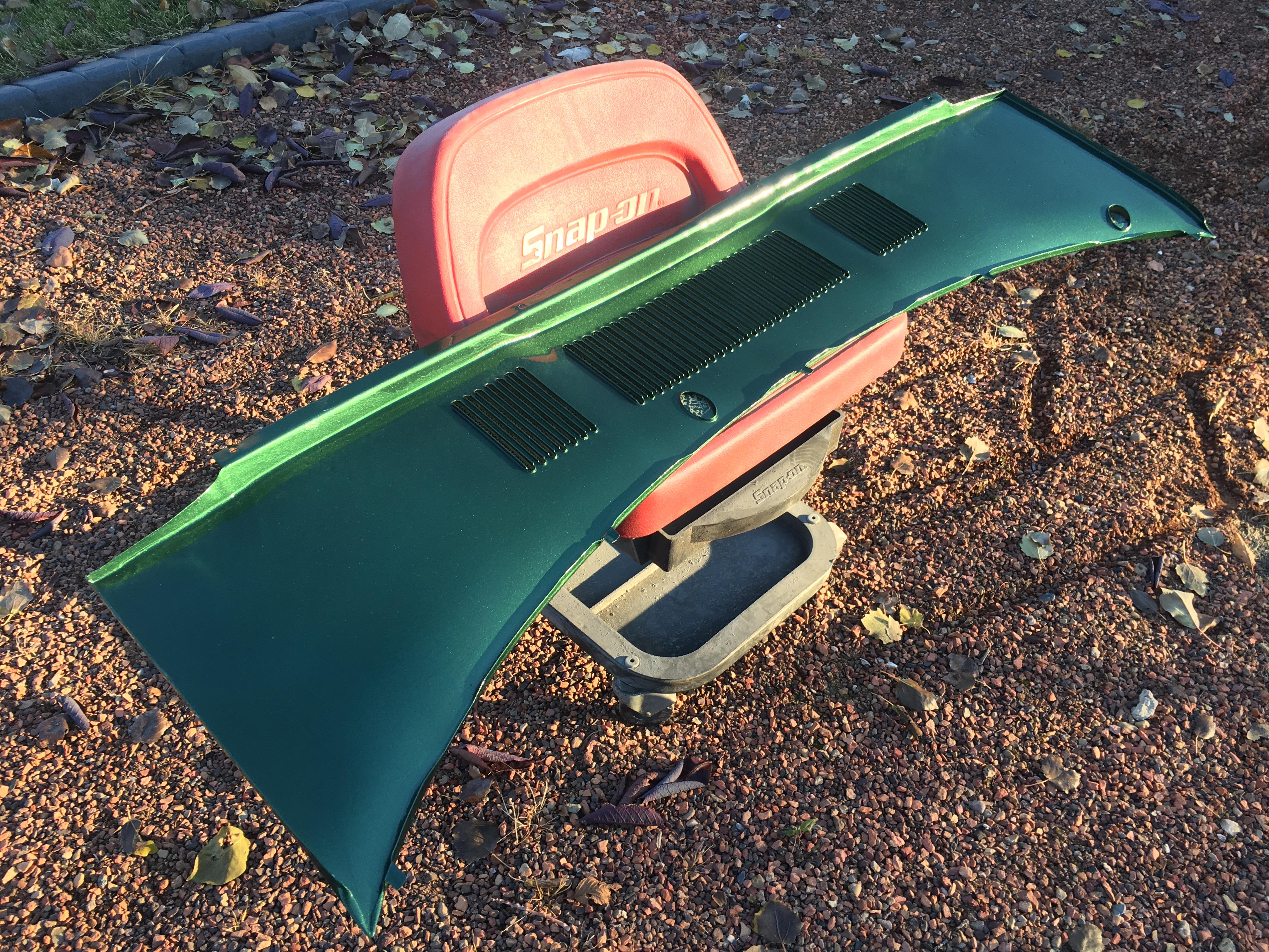

Green cars have somehow been sprinkled throughout my life and hold great memories. When I bought this car it had been resprayed a puke gold green. I was absolutely thrilled to see the original dark green underneath.
There was no other colour for me for this car after that. A slight change to fit the “restomod” theme, but overall the colour of my dreams.

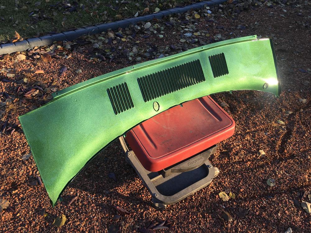

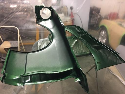

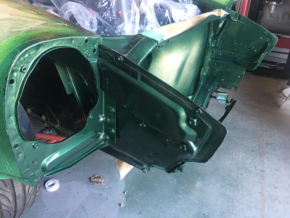

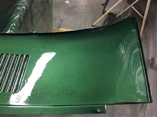

Well, that’s the end of the small one pint of colour I had. Managed to get the front end, both fenders and the underside of the cowl done though.
I will purchase a gallon now and have it packed in pints for use as I go forward. The finish outside coat will definitely be one mix to ensure the most consistent coverage. The edges are less of an issue even though the mixing system is super accurate.

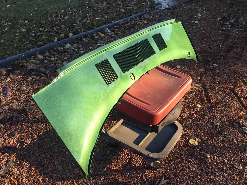

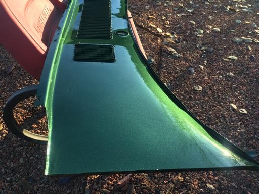

I bought four "green" colours and tested them on a spare fibreglas panel first. That way I could see how they reacted to  the cars curves and different lighting conditions.
... and then I let the wife pick! She choose wisely.
