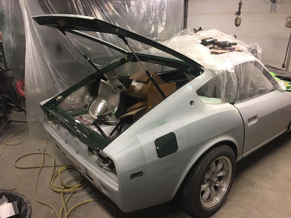

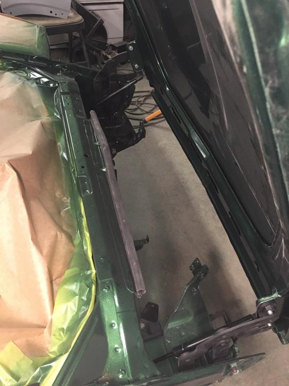

Hatch lined up nice. Refurbed (painted) gas shocks still work good.

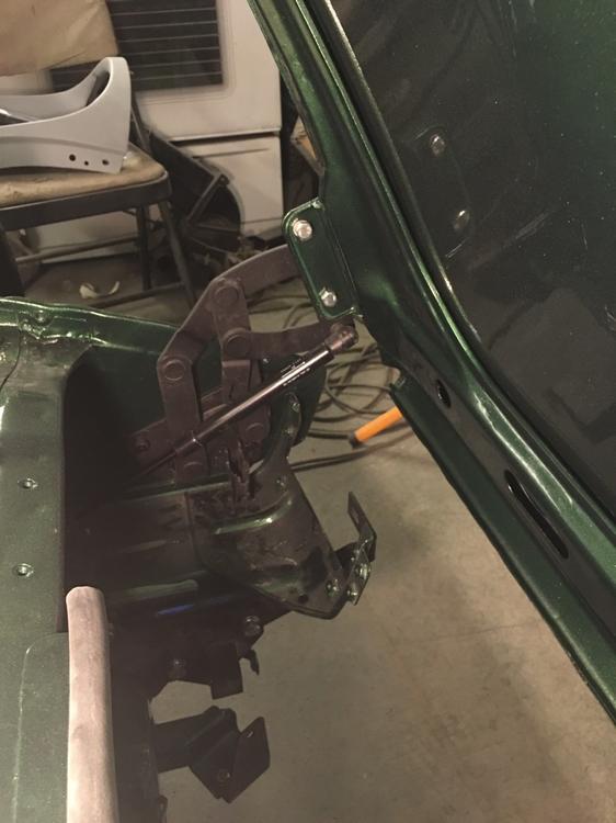

Only the outer seal installed as the inner seal won’t let the hatch close easily and will put off the body work. I will get the seals sorted later.
