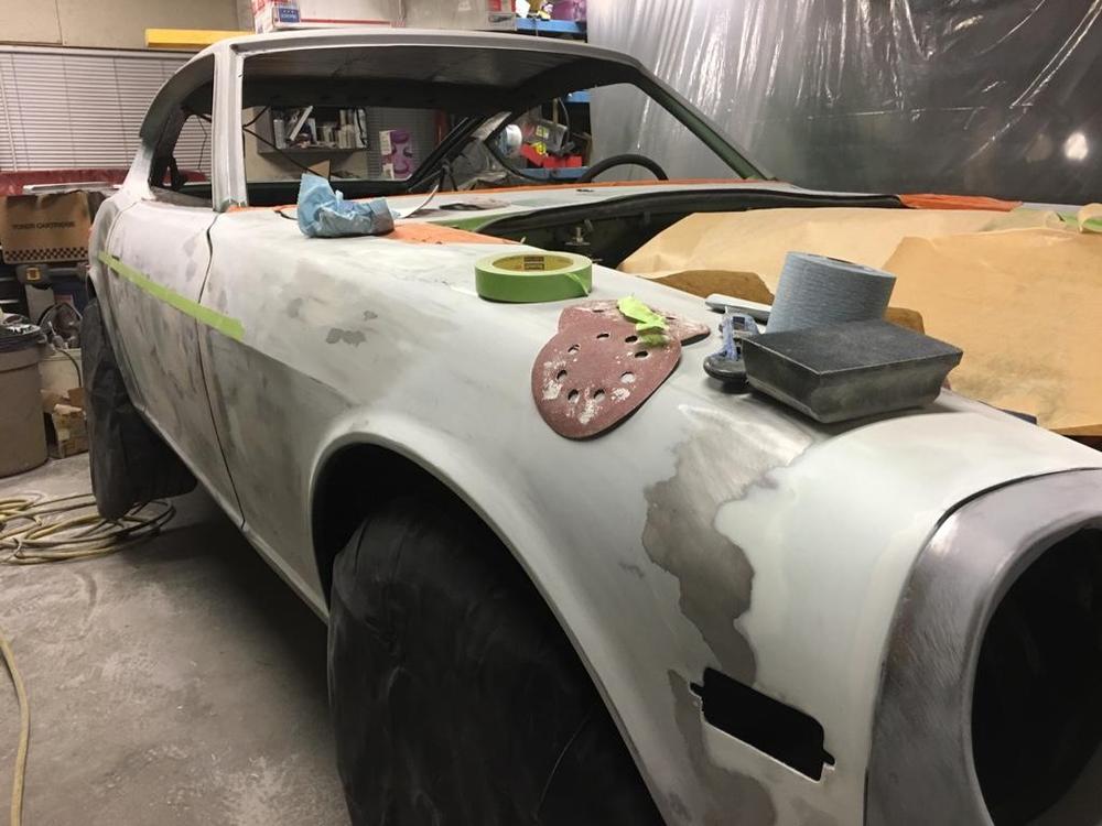

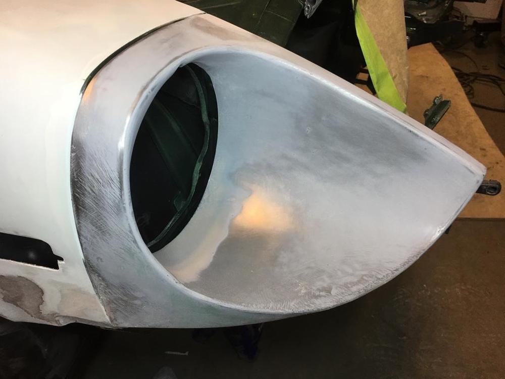

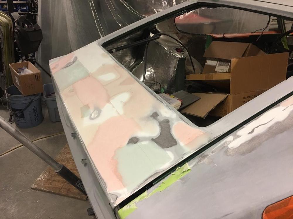

The edges and insides are done. The outsides are actually really good except for the Taiwan fender in a couple spots. The headlight bucket stamp area was too narrow a diameter to for the bucket so that had to be built up. The edge where the bumper notch was curled inwards too much, and the edge near the top of the door at the body line was dented in that could not be pulled out easily. That needed some filler. The driver side is almost a done deal as it fits very well.
The back hatch had too many waves from all the dents and abuse it had received. The multiple colours of filler let me see where I have done previous spot levelling. It’s not very thick at all, but I’m trying to get it as flat (smooth) as possible in the curved natural form. Lots of long block work.

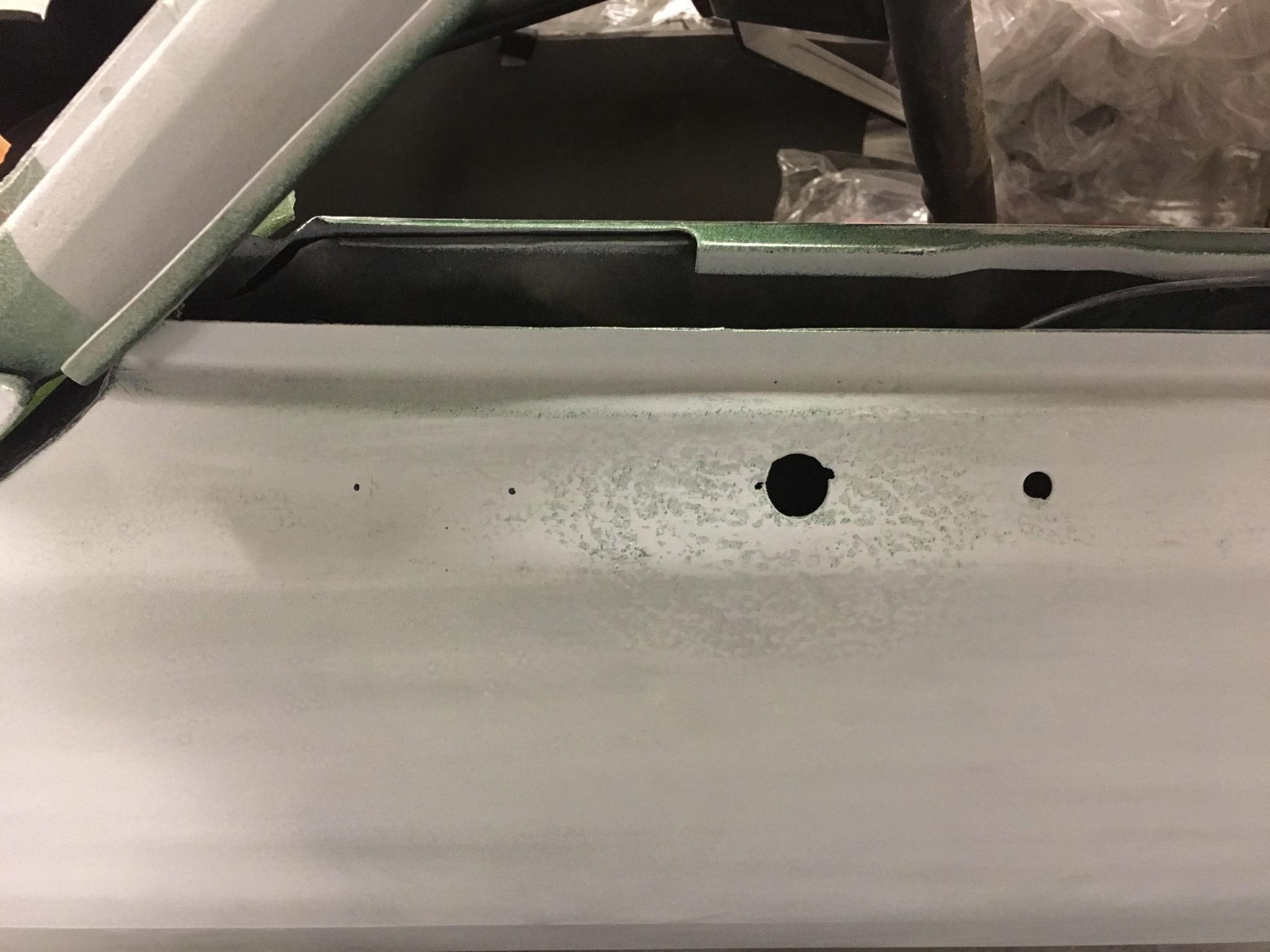

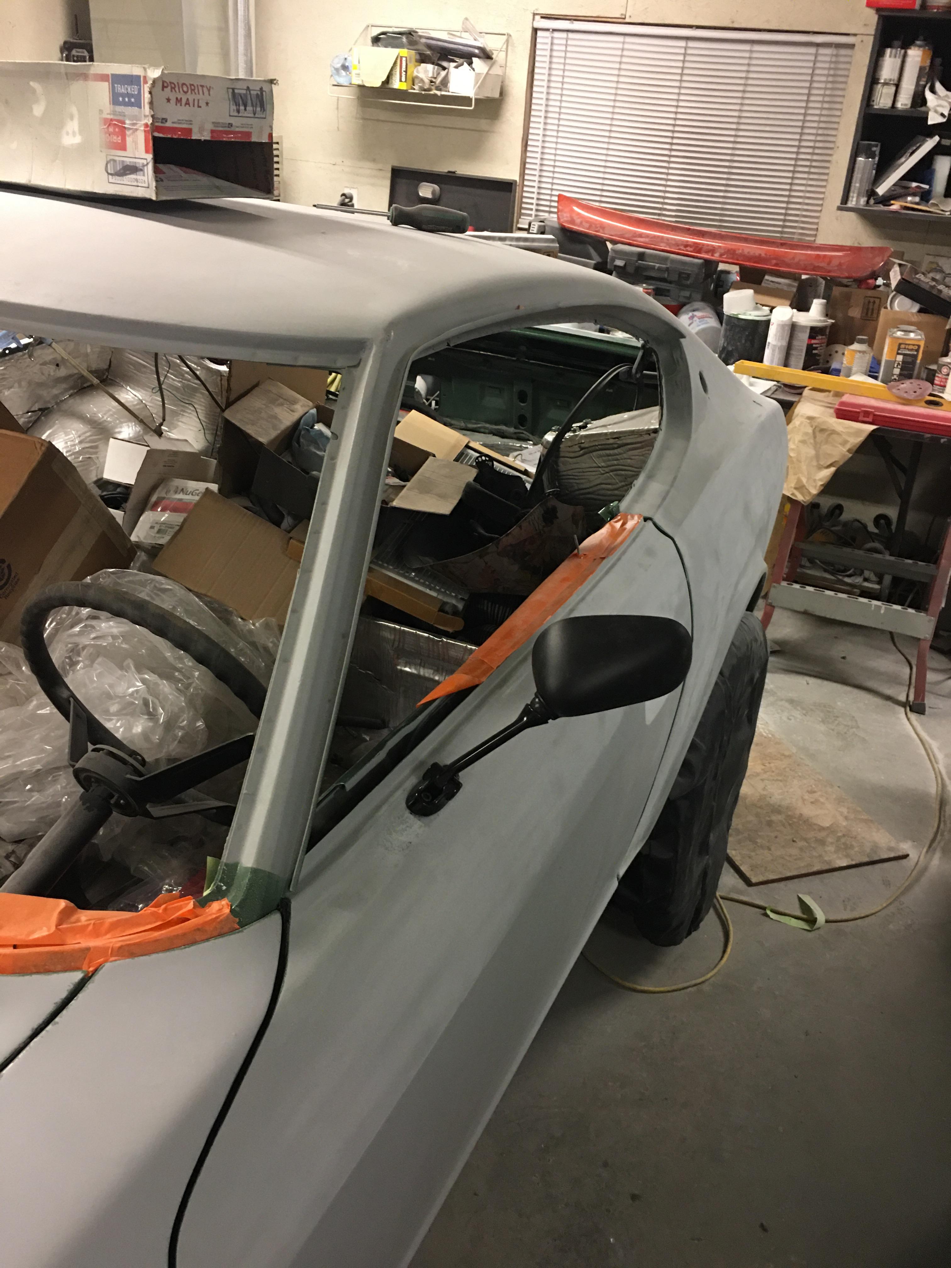

So another of my long planned purchases finally arrived. I had been covering the BRE racing mirrors for a while and pulled the trigger a couple of weeks ago.

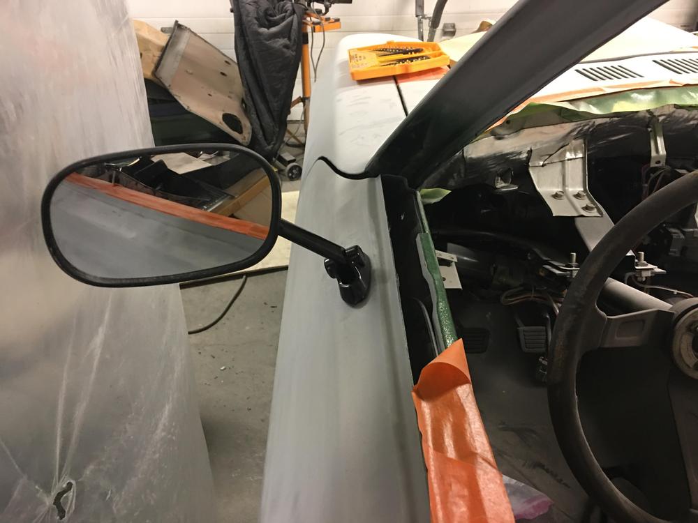

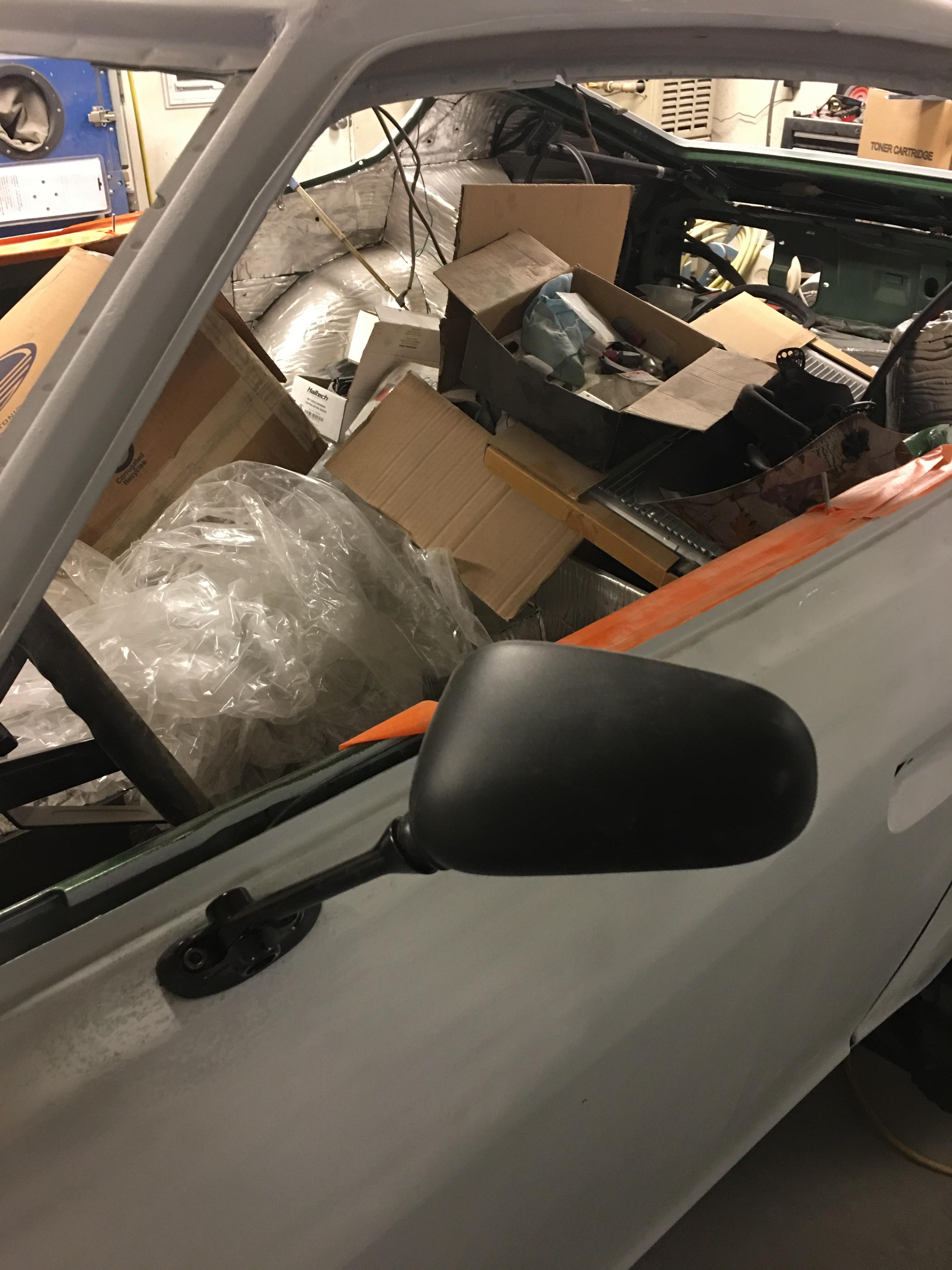

First of all, they are very cool. However they need to mount closer to the fender than the stock position. That means drilling new holes. No big deal because the stock holes are too wide anyways.

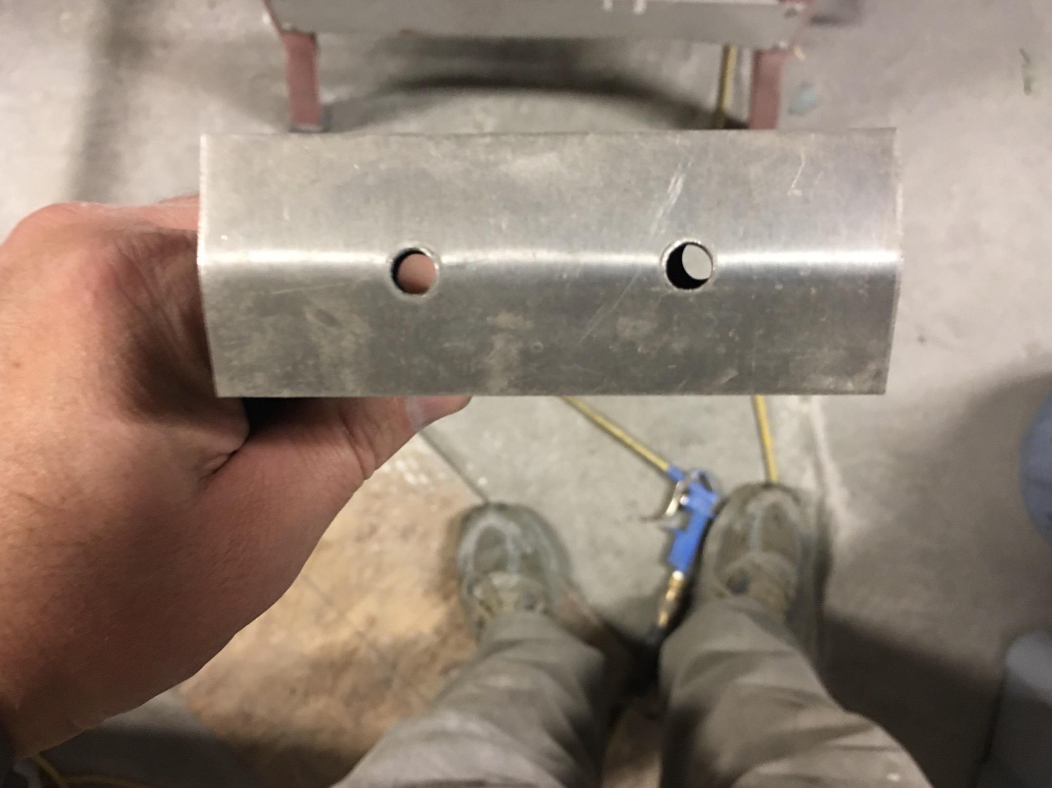

My first problem I quickly discovered is that the door is very “closed in” near the front of the window area. Hard to get a finger in there let alone nuts and washers. But the real issue at first was that the backing plates were not drilled to same spacing as the mirror mounts! Poor quality control there.
Other than that, I am super excited to have them finish mounted on the doors. A couple pics of the drivers side mounted to the stock position before I drilled new holes and closed up the old ones.
