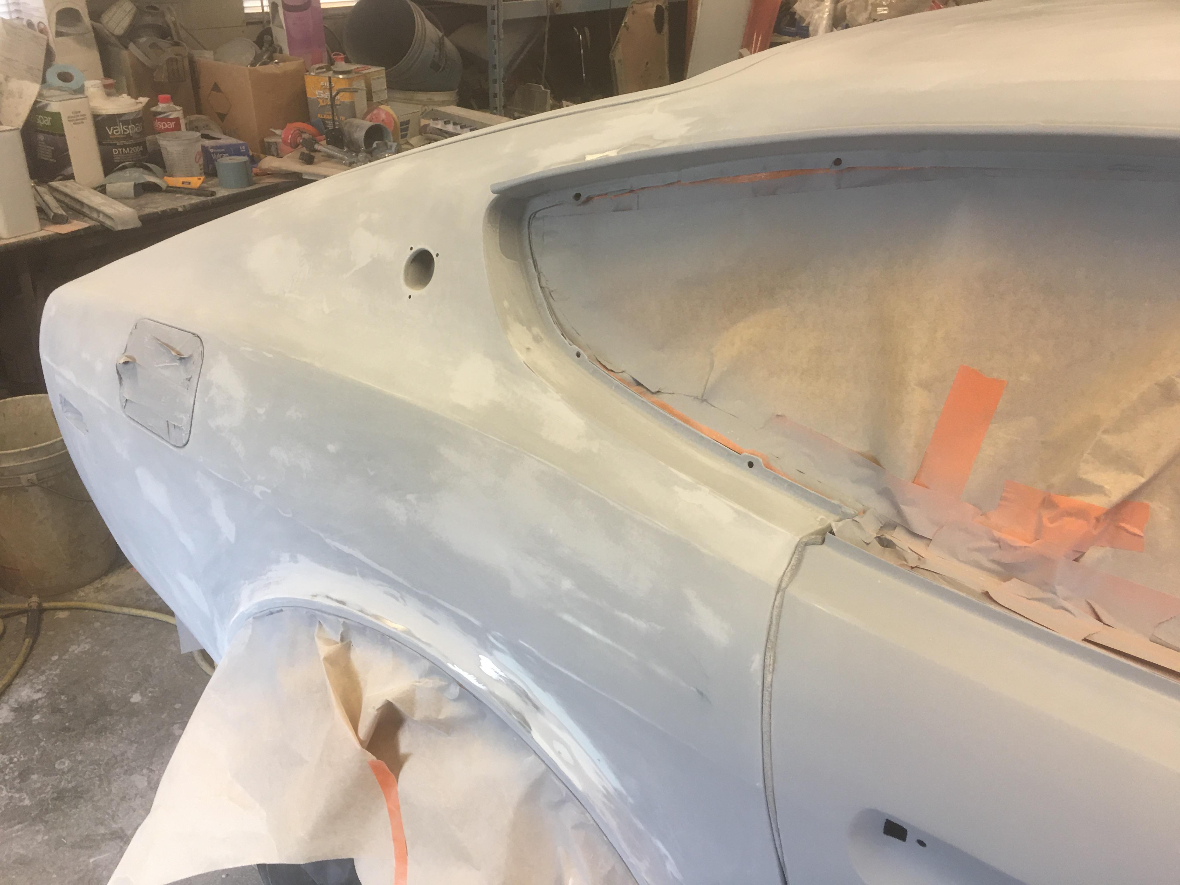

March 27, 20205 yr Author comment_595567 Yup. Patience is key. I spotted a couple flaws that will need touching up before seal coat too. As expected...!Sent from my iPhone using Tapatalk Link to comment https://www.classiczcars.com/forums/topic/50908-1976-280z-restoration-project/?&page=256#findComment-595567 Share on other sites More sharing options...

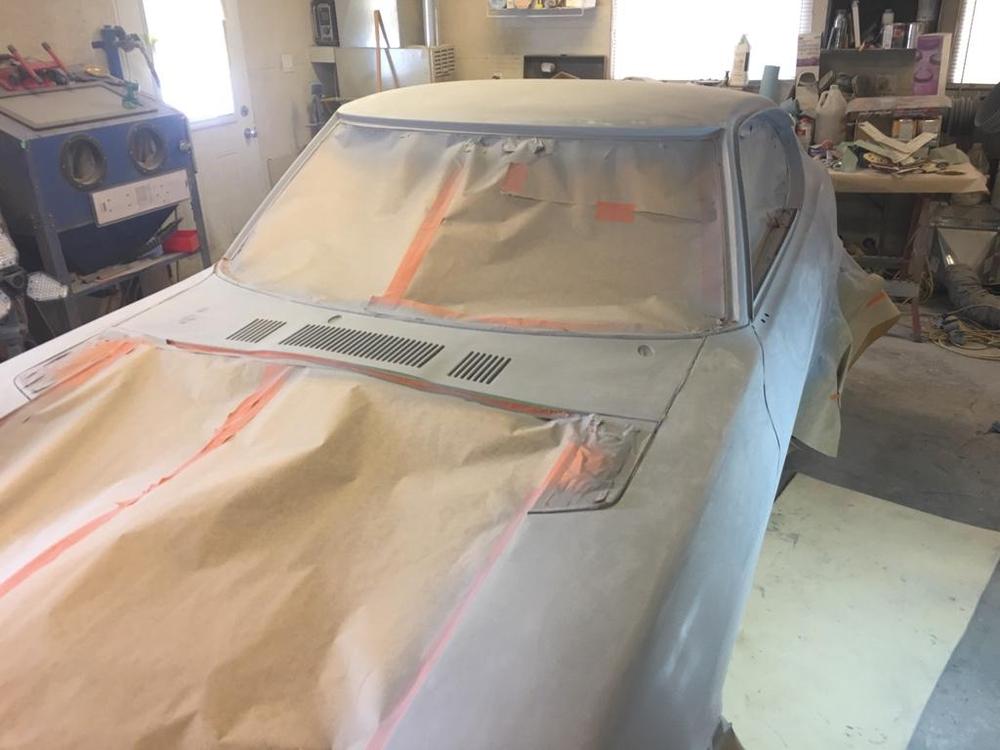

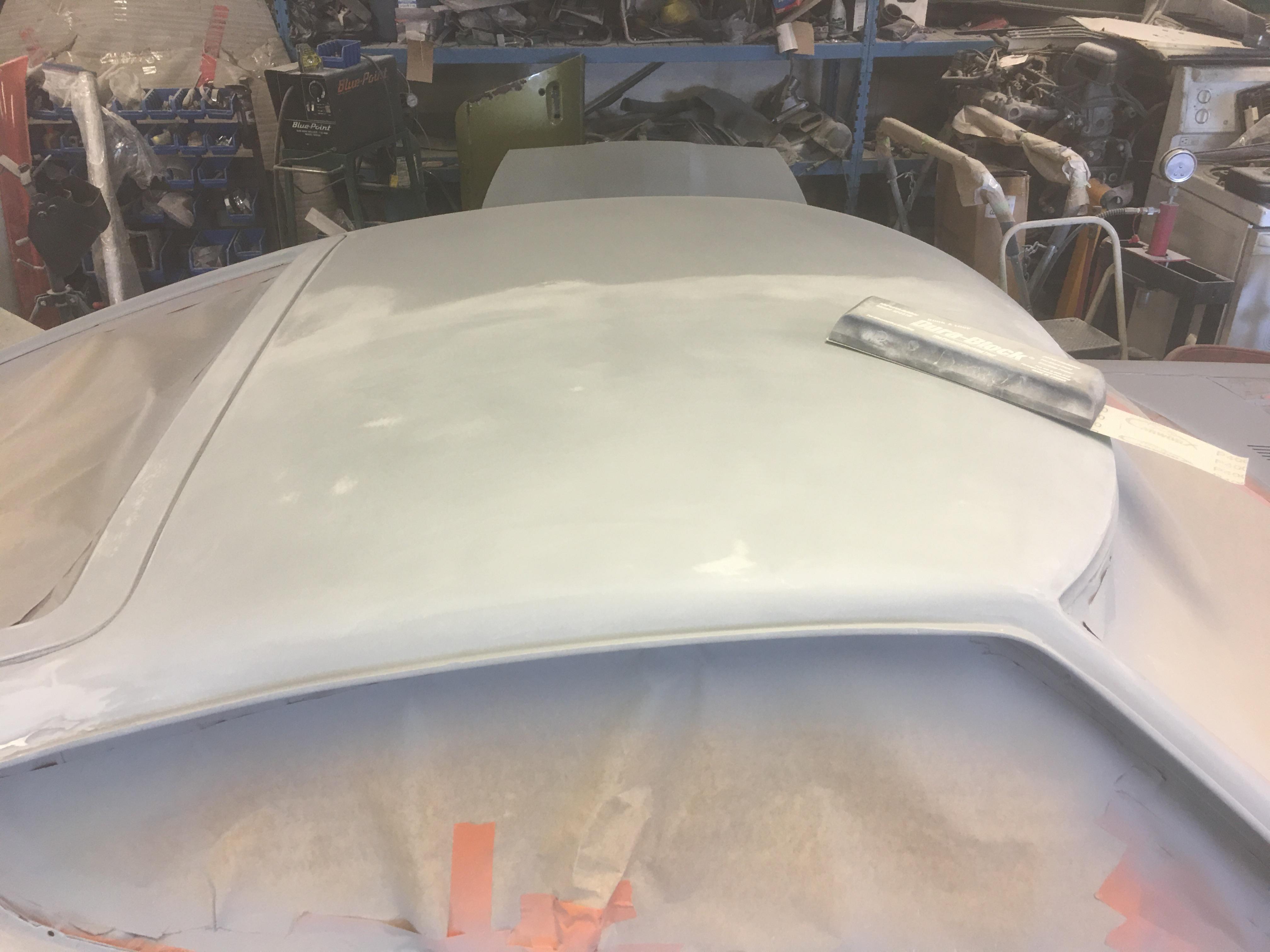

March 27, 20205 yr Author comment_595605 Sanding is going awesome! Slow but the results are good. So satisfying to see the roof sand out flat...! Link to comment https://www.classiczcars.com/forums/topic/50908-1976-280z-restoration-project/?&page=256#findComment-595605 Share on other sites More sharing options...

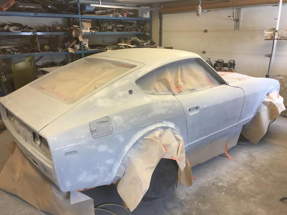

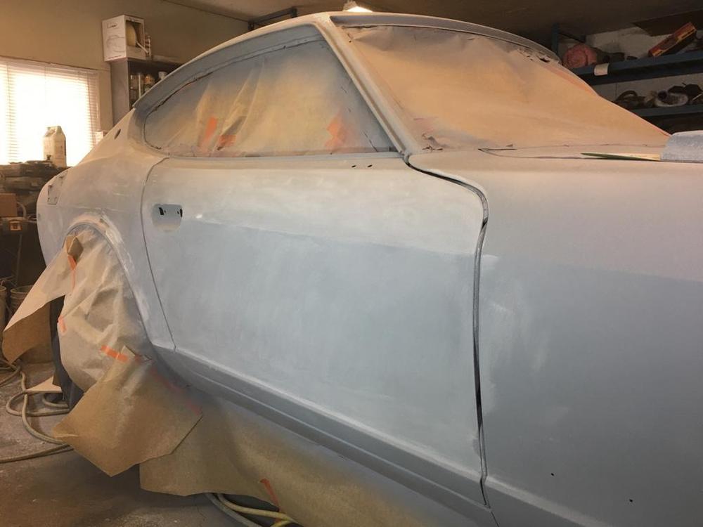

March 27, 20205 yr Author comment_595628 First pass of the long block over the hi build on the door. The dent and repair took many hours of sanding and filling, but now I see it was all worth it! Flat!!! Sent from my iPhone using Tapatalk Link to comment https://www.classiczcars.com/forums/topic/50908-1976-280z-restoration-project/?&page=256#findComment-595628 Share on other sites More sharing options...
March 27, 20205 yr comment_595637 Looks great. It will go much faster now! Link to comment https://www.classiczcars.com/forums/topic/50908-1976-280z-restoration-project/?&page=256#findComment-595637 Share on other sites More sharing options...

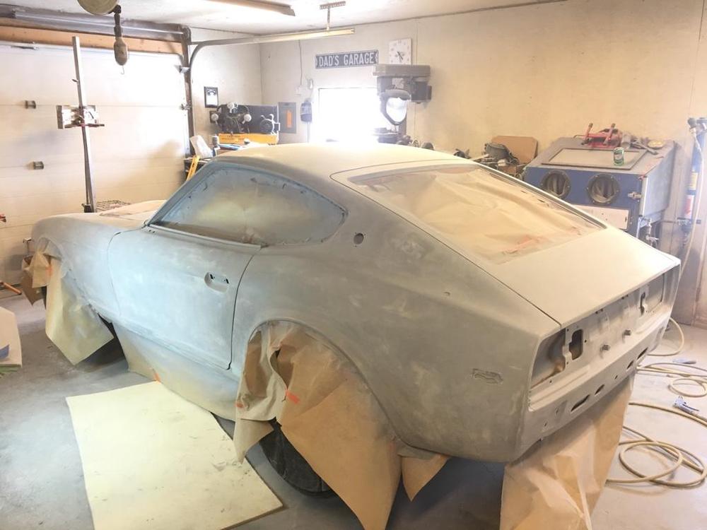

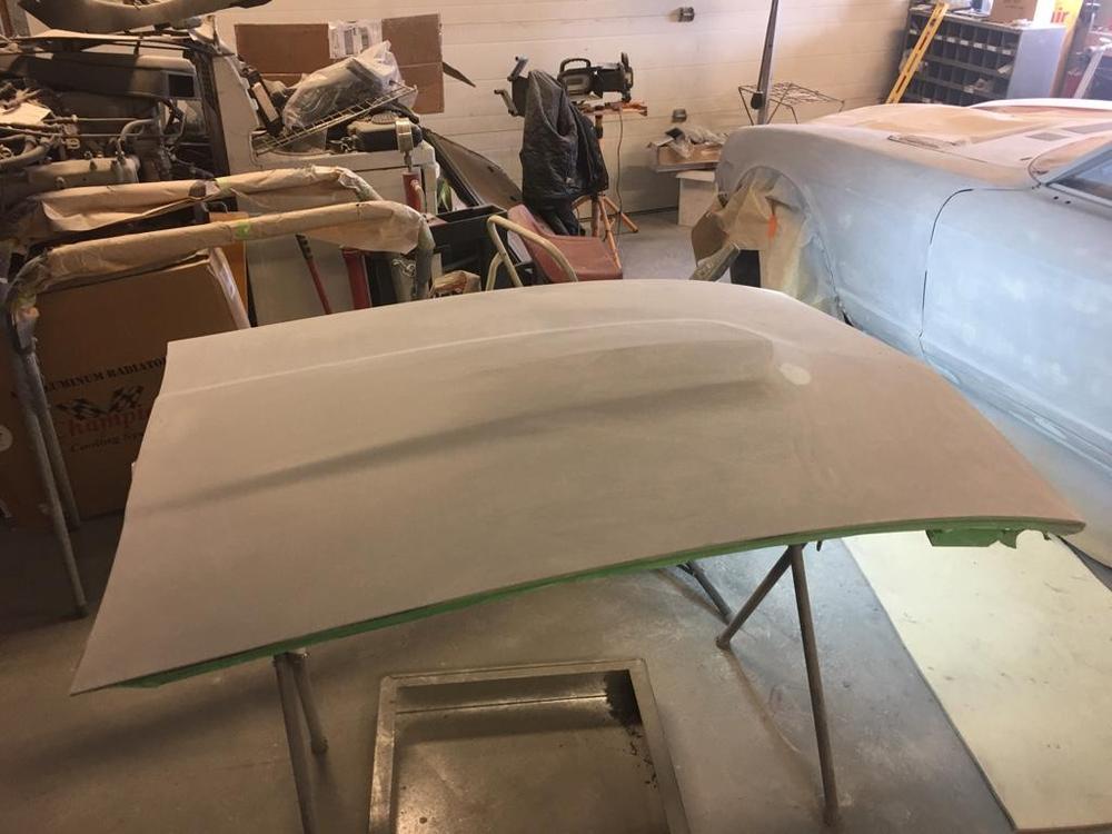

March 28, 20205 yr Author comment_595661 All sanded. Feels smooth like glass! Now to wash the whole car with soap and water, then re-mask the car and spray sealer before the base coat. Sent from my iPhone using Tapatalk Link to comment https://www.classiczcars.com/forums/topic/50908-1976-280z-restoration-project/?&page=256#findComment-595661 Share on other sites More sharing options...

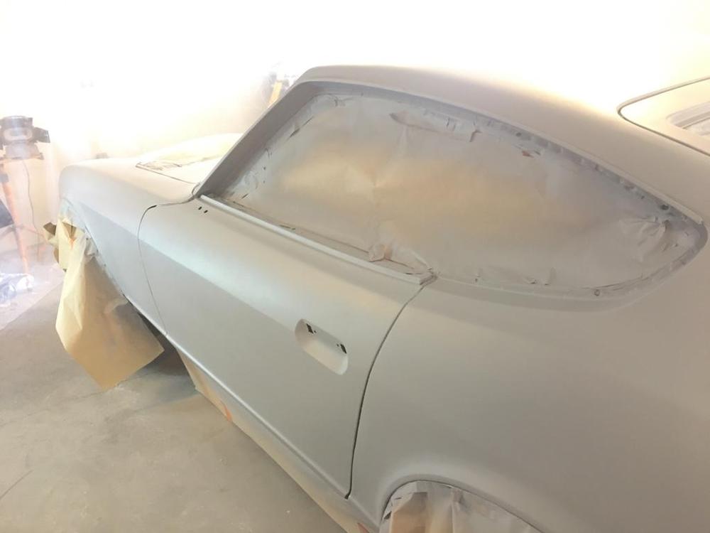

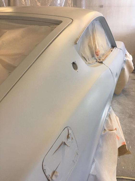

March 31, 20205 yr Author Popular Post comment_595863 Seal coat sprayed this morning !The finish was good but not smooth as it was before I sprayed the seal coat. So I broke down and sanded it all down again with 1000 grit, just enough to bring the glass like feel to the panels again. Tomorrow is the day for paint!!Sent from my iPhone using Tapatalk Link to comment https://www.classiczcars.com/forums/topic/50908-1976-280z-restoration-project/?&page=256#findComment-595863 Share on other sites More sharing options...
