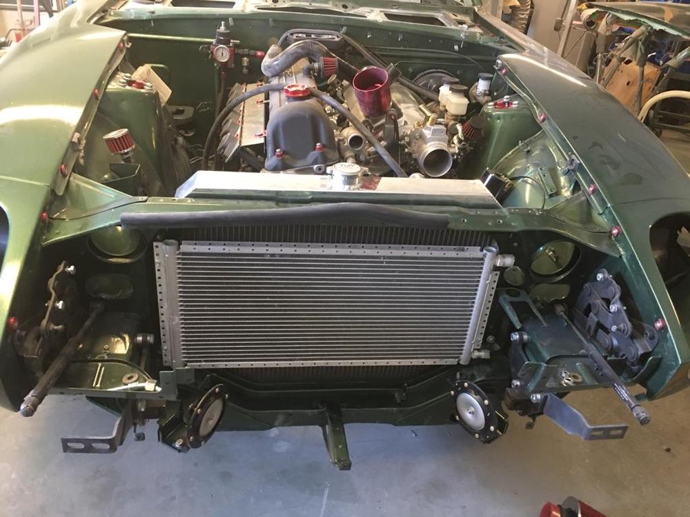

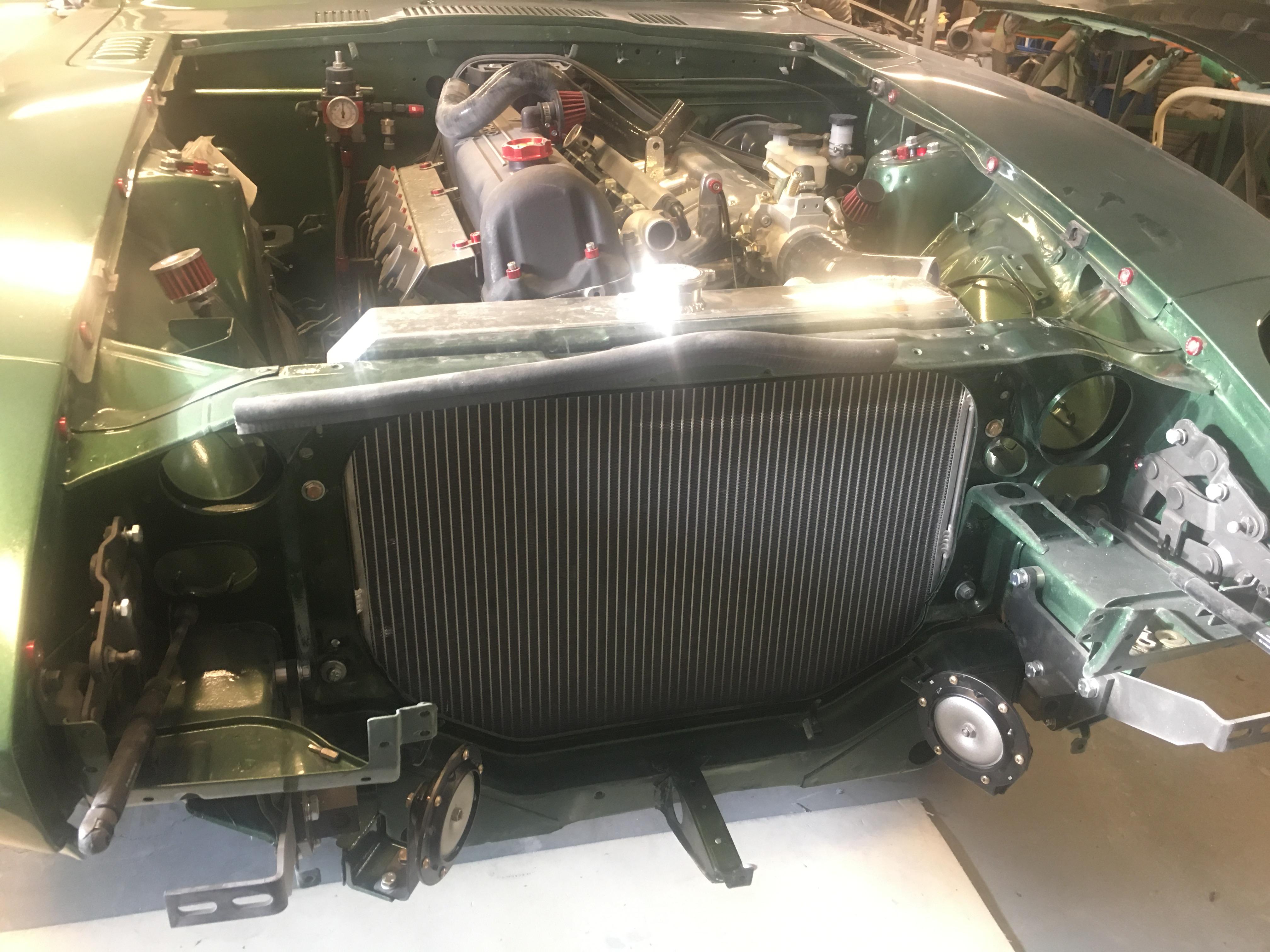

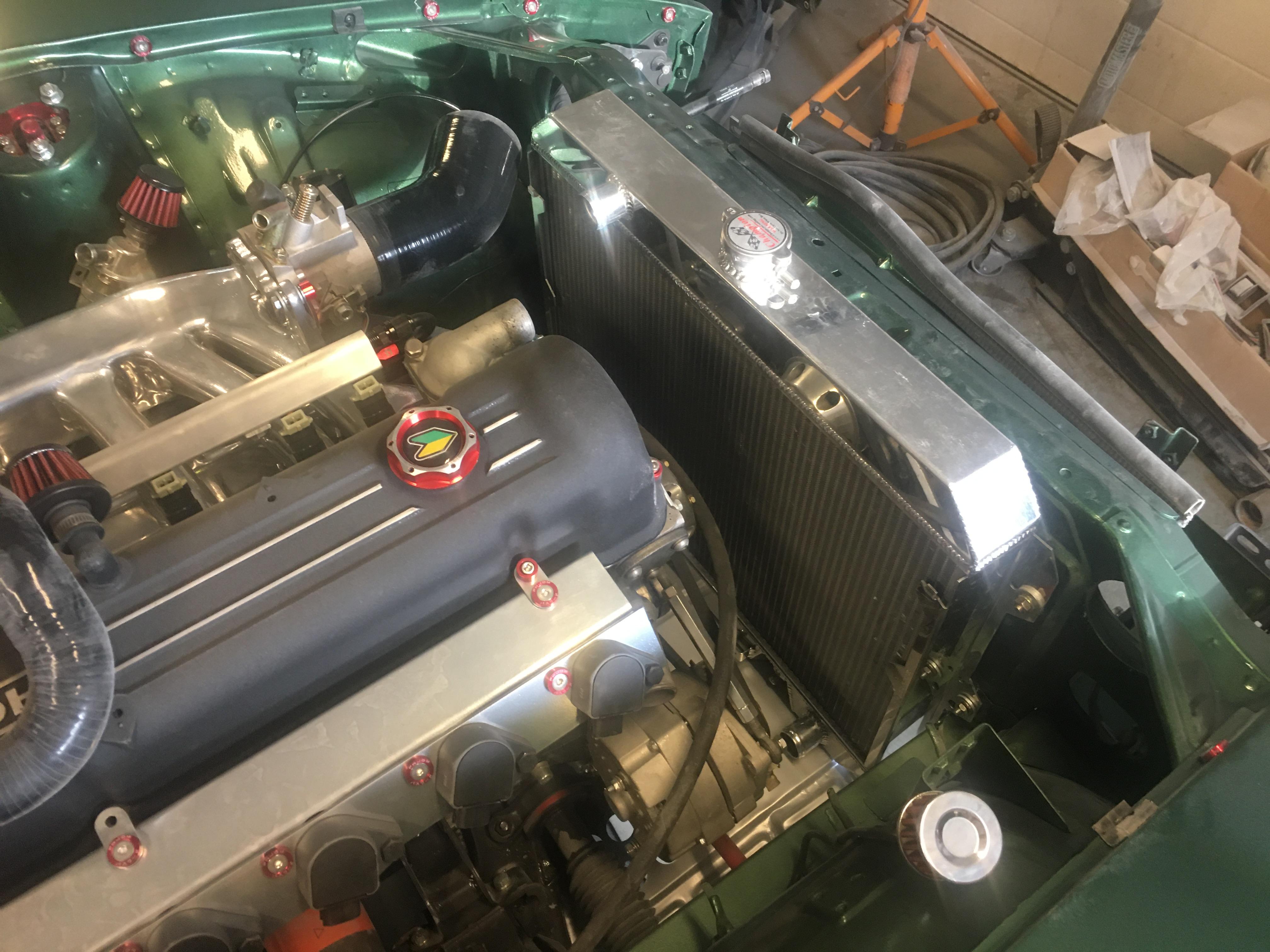

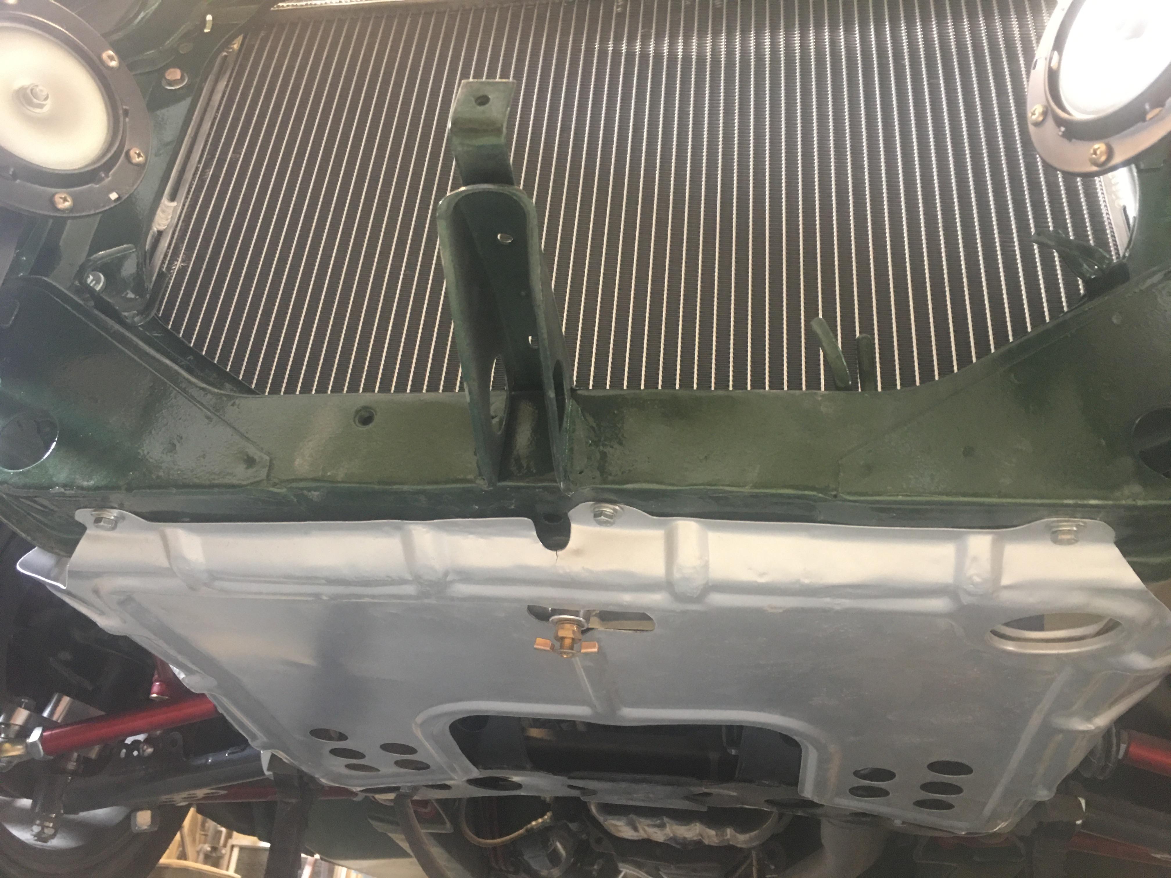

Installed the 3 Row Champion radiator. I got a crazy deal on it a long time ago and it is for a 280ZX but the only difference is the centre drain. I modded the splash pan to compensate and now it fits great!

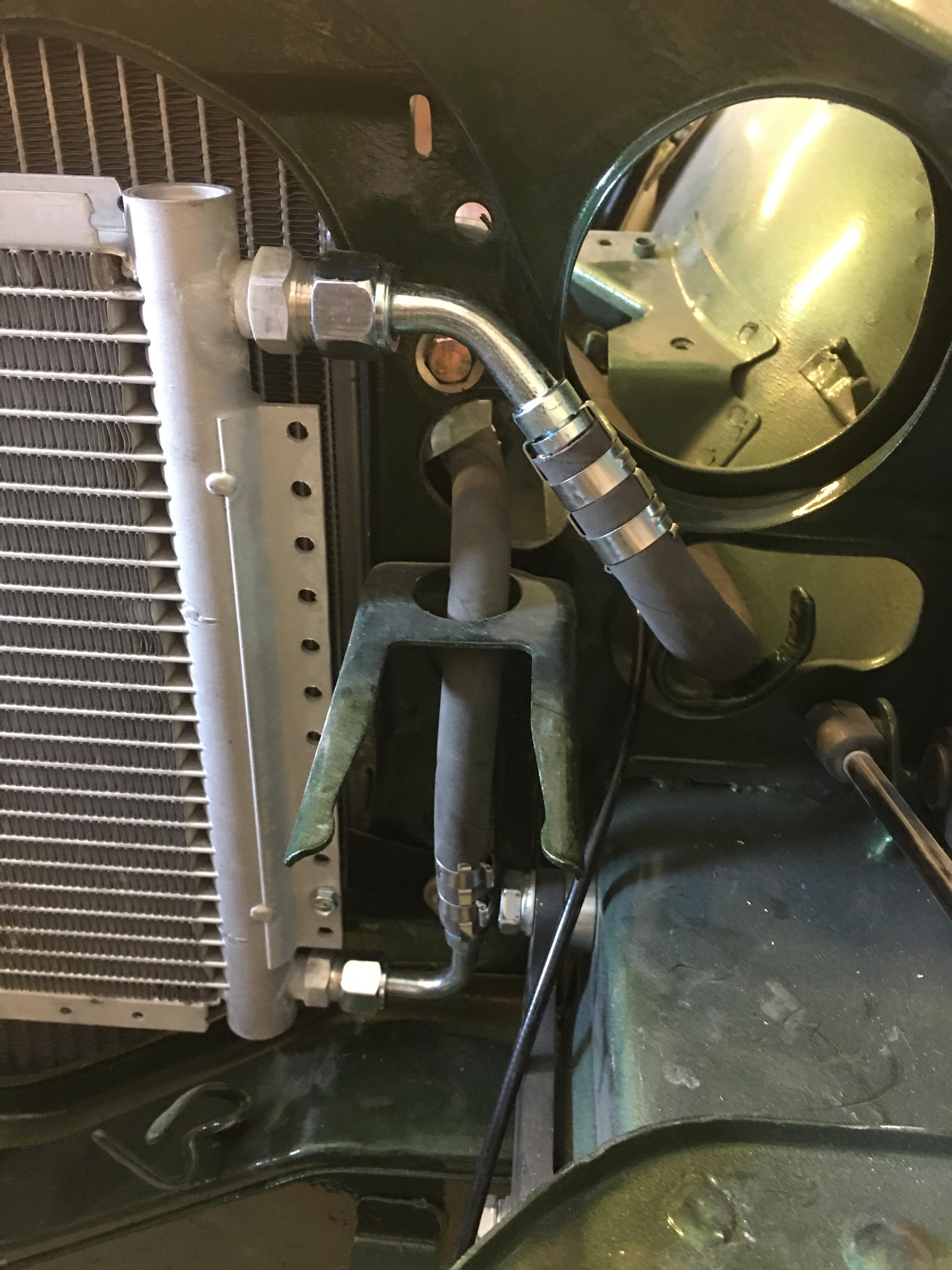

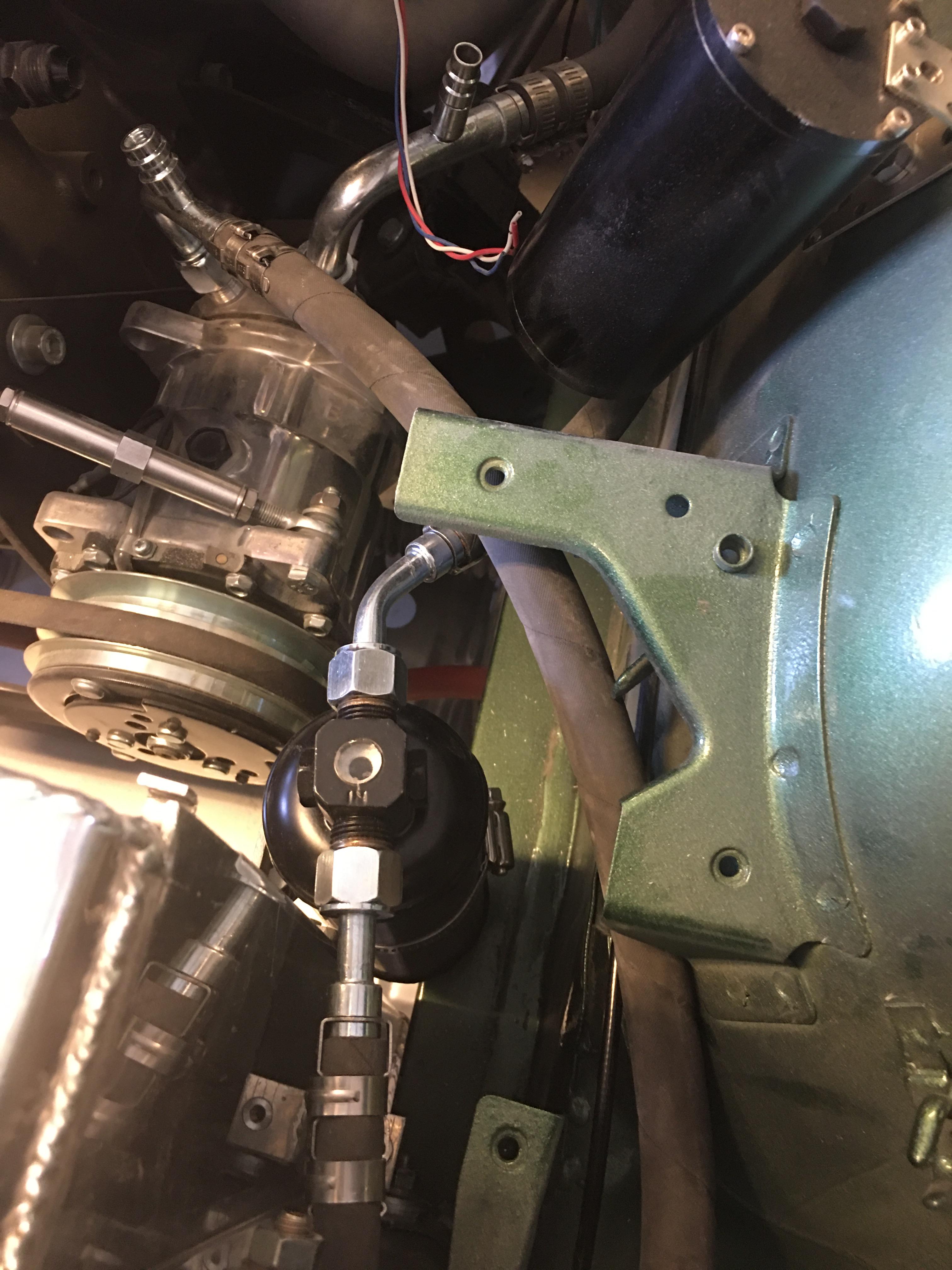

Finished routing the AC lines and used the quikclip kit to attach all the fittings.
10 from the evaporator to the pump, 8 to the top of the condenser, 6 from the condenser to the drier, 6 from the dryer to the evaporator.

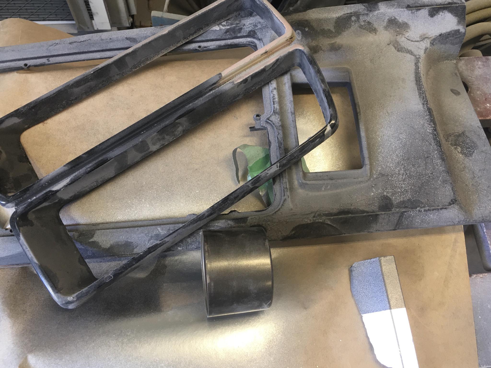

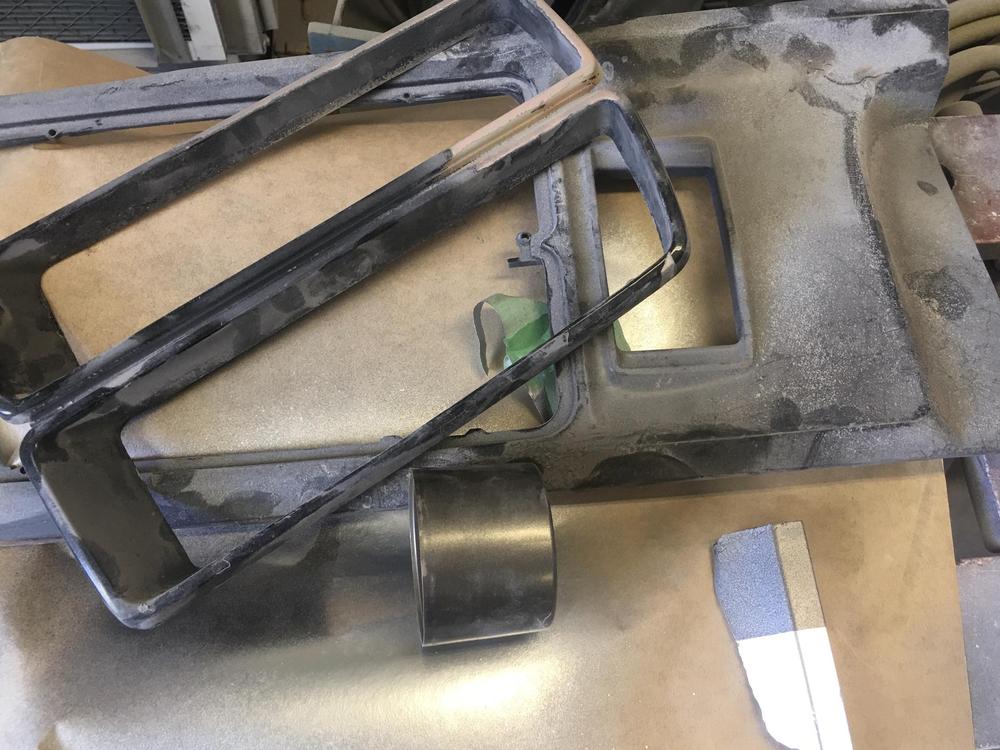

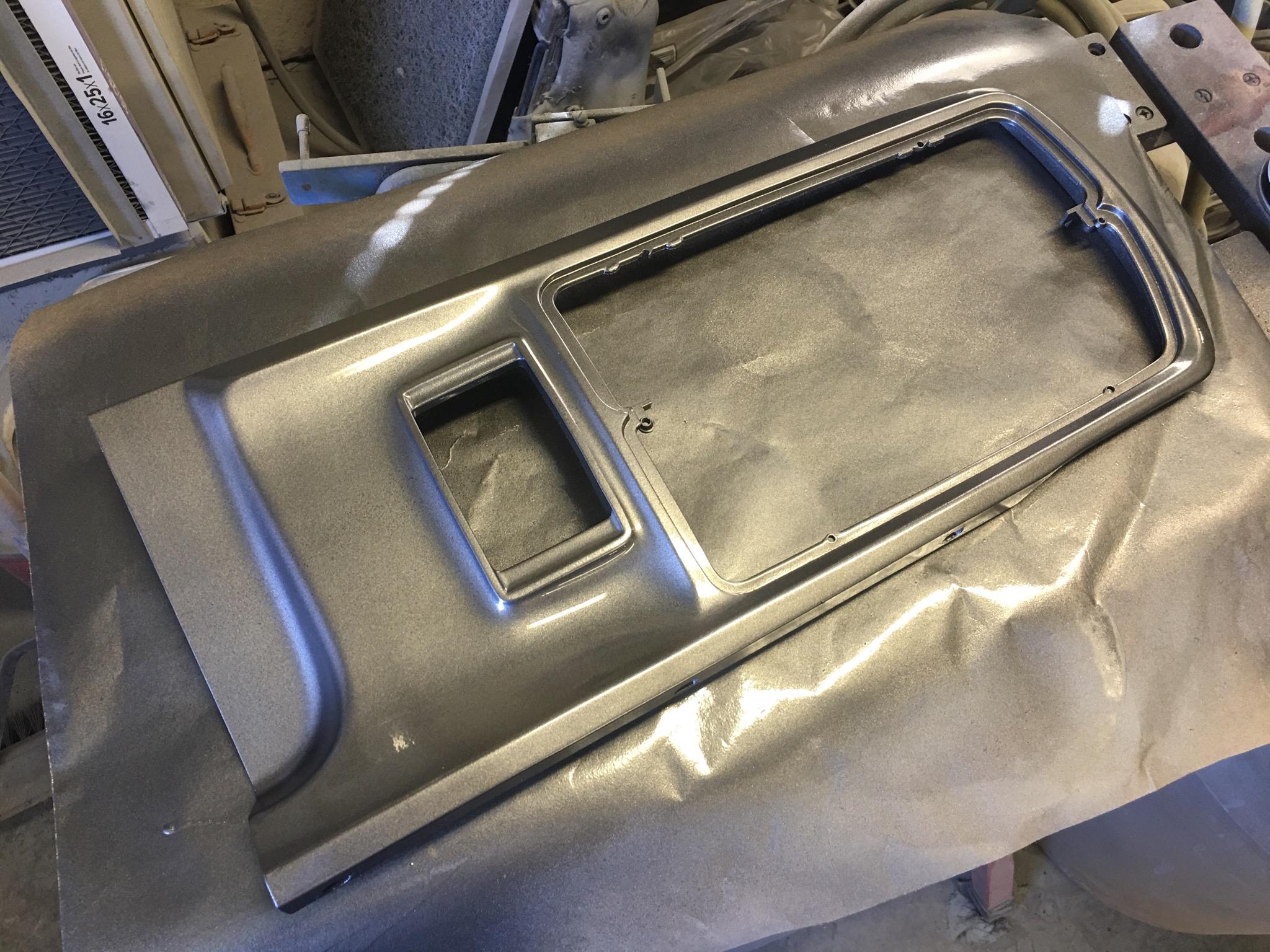

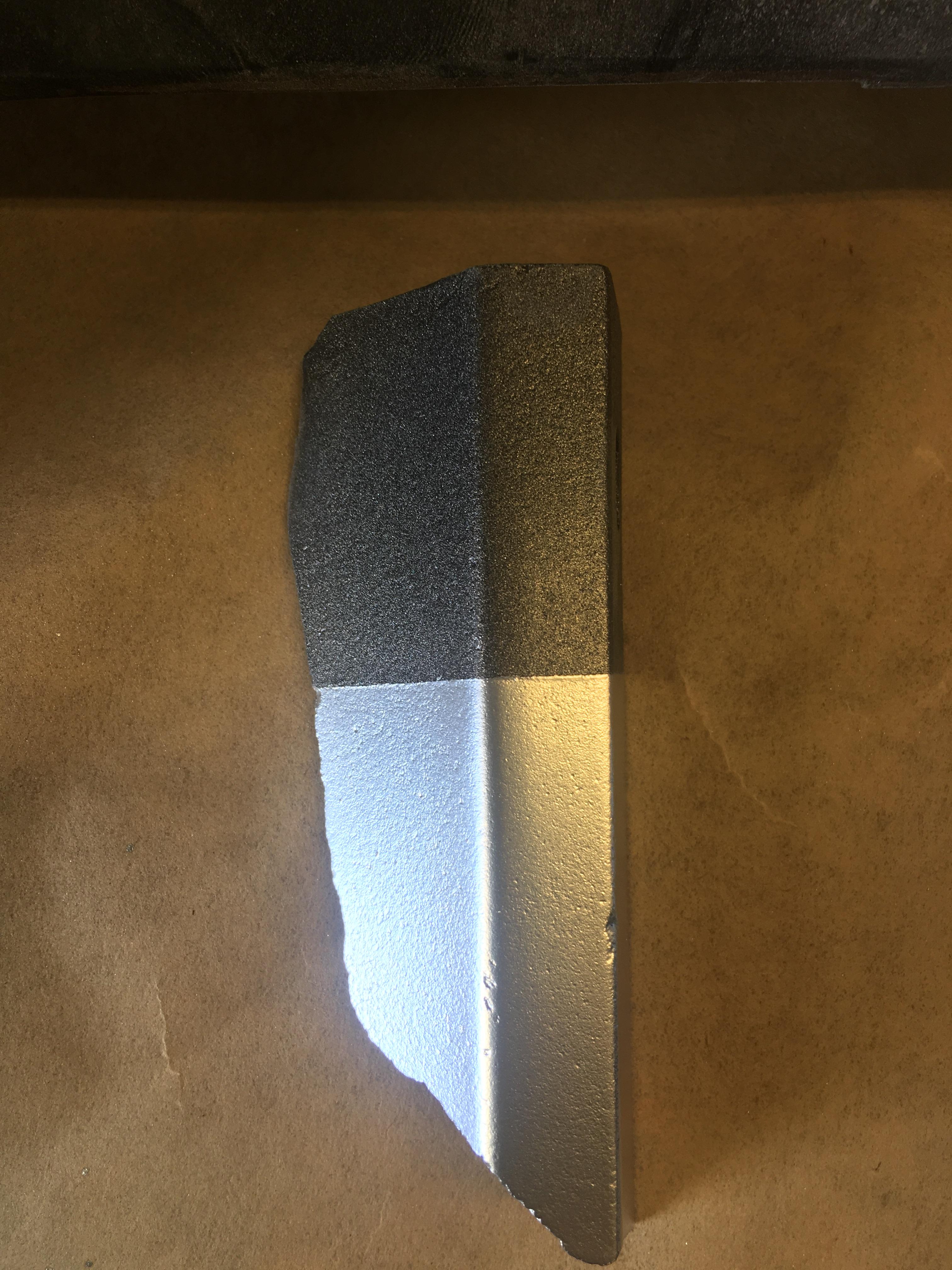

So here’s something cool. I have a couple sets of the rear tail light finishers and none are great. I tested a small broken piece by first media blasting it gently, then spraying it with Duplicolor Graphite wheel paint and right beside that, some commercial chrome spray paint. I think I can live with this until I can afford re-chromed bezels....!
Edited by wheee!

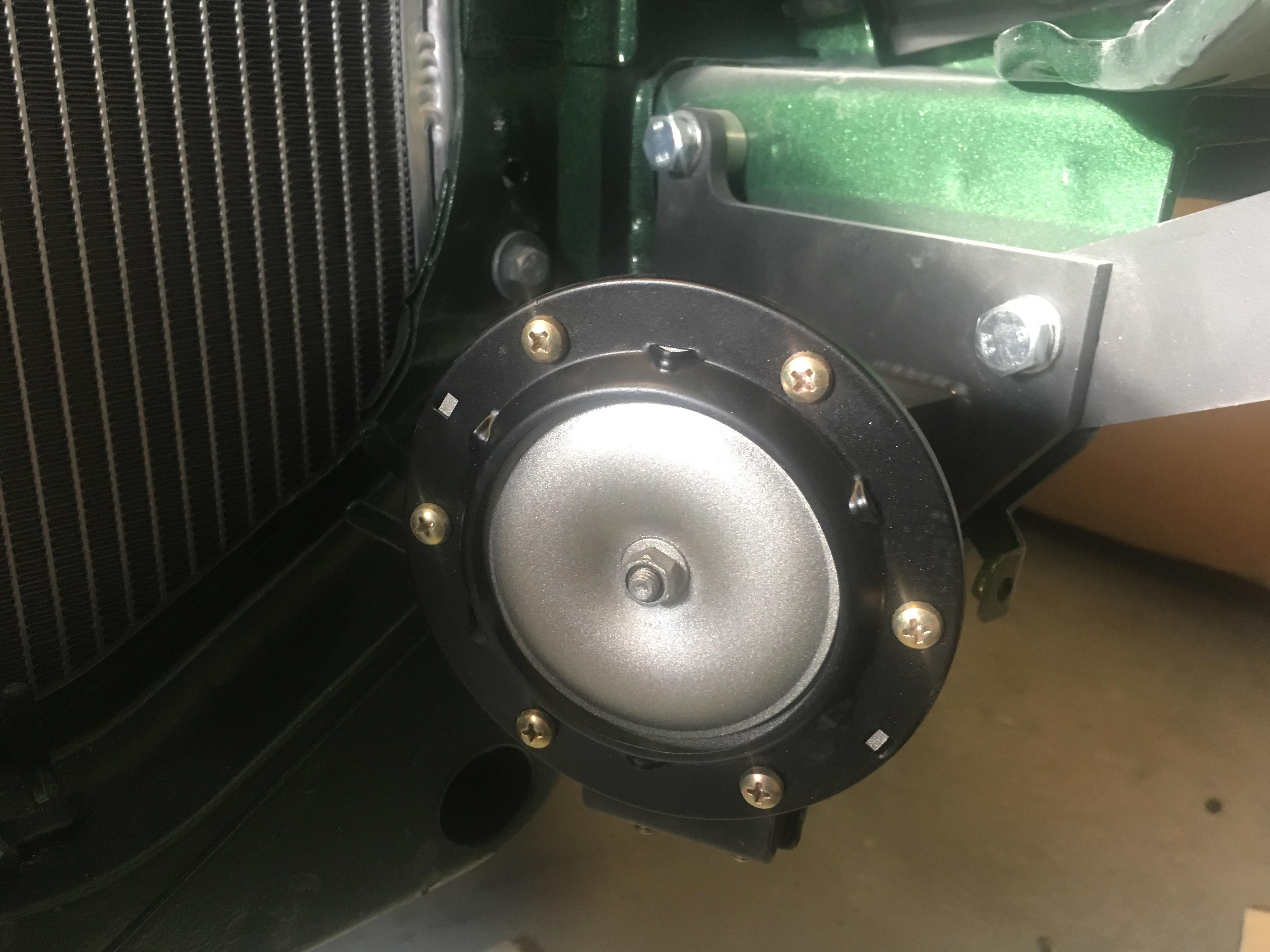

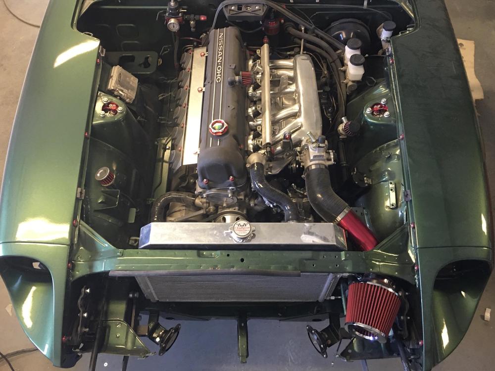

Some more progress on various fronts. I have installed the refurbished factory fan clutch and fan in the car for now. I had a Ford Taurus fan from a JY but there is no way that will for between the rad and L series engine. I like the look of the factory fan in there anyways... This allowed me to install the silicone rad hoses as well. I also installed the cold air intake pipe and hose routing this was key as I had to ensure that the AC lines and the hood hinges cleared properly. Keeping with the front end theme, I spent about three hours cleaning and refurbing the front indicator housings and wires. They had been liberally coated in undercoating somehow by the PO. I will leave the lens polishing for later. The surrounds for the indicators were also somewhat chipped so I tried to use some epoxy to build up damaged areas. I will see if it held well enough to sand and paint today. I installed the centre valance to ensure it cleared the horn mounts and fit along with @EuroDat  's 240 bumper conversion kit. Of course it did! I routed my secret hood release cable into position and found a nice spot to access it in case of power loss. I started disassembling and cleaning up the taillight surrounds. While all this was going on I received a package with exhaust hangers that I will weld into place (on the pipe) to secure the exhaust pipe to the factory mounts.
