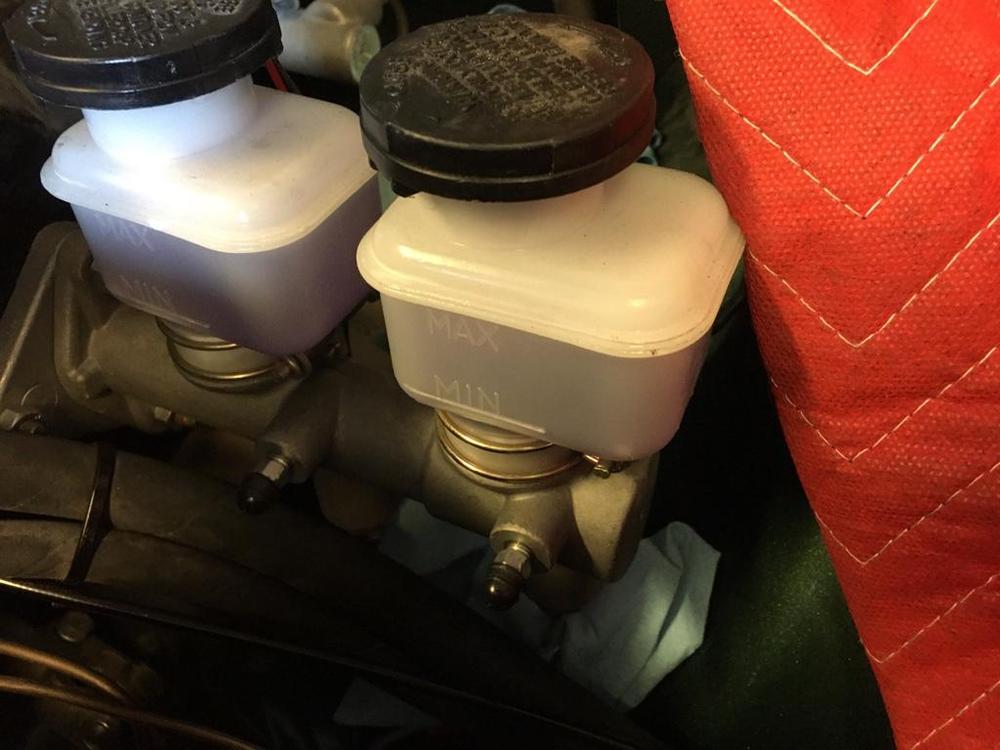

I had a bit of a disappointing day. Tried bleeding the wilwoods today and couldn’t get more than a dribble and bubbles from the rears. No leaks, bled the 7/8” master cylinder first, opened the proportional valve 100% and kept the reservoir’s full.
The fronts bled no problem. I have a speed bleeder that uses compressed air to pull the fluid through the lines.
I pulled the lines off at various points and pushed compressed air through and no blockages. The reaction disc seems to be fine. I adjusted the stroke length of the rod to the pedal to ensure full pressure to the rear reservoir (front bowl) and still just a dribble.
Hmmmmmm.

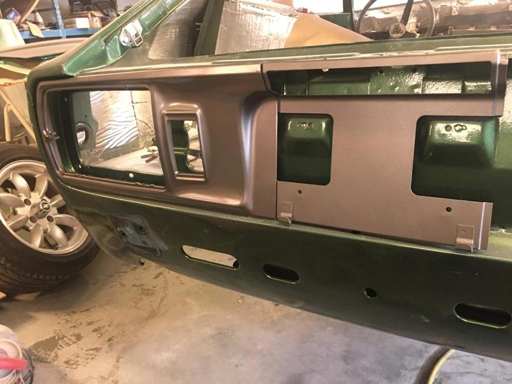

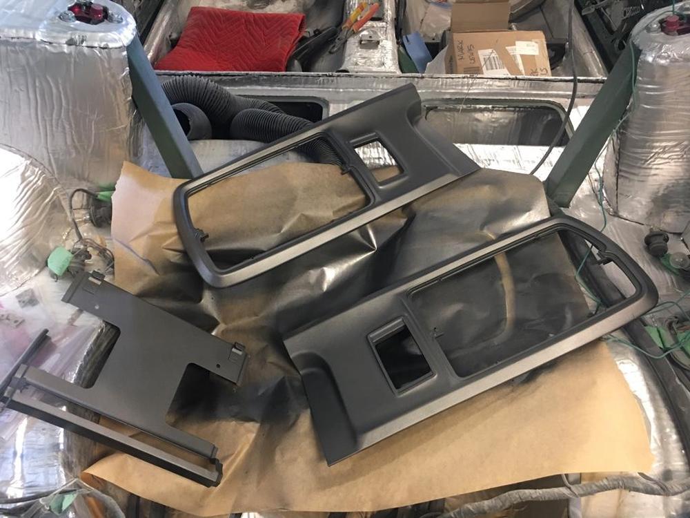

1 hour ago, wheee! said:
The finished surrounds. Without the chrome pieces obviously.
Is it just the lighting or are they darker than the earlier pics with the gloss LH/matte center?
Either way, they will look great based on the last pic!  What are you doing with the chrome?  Is yours good or do you have to find/recreate the chrome?
They are the same but the lighting is better in the last pic.
I am painting a “chrome” paint onto the old bezels. They are too far gone to use as is. One day I would like real chrome ones again.
Did you read the FB discussion about the chrome bezels?  It sounds like chrome wrap might be the best way to go.
