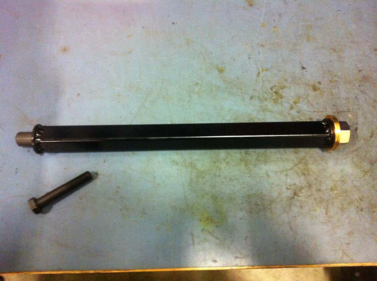

November 27, 20159 yr comment_481794 Yes, you will probably need to get another washer and a thrust bearing. Once they start moving they pull on out, getting them moving can be a problem especially if you flared one end. Edit: Looks good though. Nice to have those kind of facilities at hand... Edited November 27, 20159 yr by Patcon Link to comment https://www.classiczcars.com/forums/topic/50908-1976-280z-restoration-project/?&page=27#findComment-481794 Share on other sites More sharing options...
November 27, 20159 yr Author comment_481809 eBay to the rescue! $3.09 cdn later... Link to comment https://www.classiczcars.com/forums/topic/50908-1976-280z-restoration-project/?&page=27#findComment-481809 Share on other sites More sharing options...
November 28, 20159 yr Author comment_481821 Quick test tonight and I discovered the 5/8" threaded rod is too thin to work. I will go up a gauge in rod and try again!... Or weld the bottom of the threaded rod for strength, grind it smooth. Might try that first. Edited November 28, 20159 yr by wheee! Link to comment https://www.classiczcars.com/forums/topic/50908-1976-280z-restoration-project/?&page=27#findComment-481821 Share on other sites More sharing options...
November 28, 20159 yr comment_481822 Did you tear the end off the threaded rod? Link to comment https://www.classiczcars.com/forums/topic/50908-1976-280z-restoration-project/?&page=27#findComment-481822 Share on other sites More sharing options...
November 28, 20159 yr Author comment_481825 Not quite. I felt it give as the threaded end split. Link to comment https://www.classiczcars.com/forums/topic/50908-1976-280z-restoration-project/?&page=27#findComment-481825 Share on other sites More sharing options...
November 28, 20159 yr comment_481829 Welding will help but the larger thread size is better. I believe my puller is 1" threaded rod... Link to comment https://www.classiczcars.com/forums/topic/50908-1976-280z-restoration-project/?&page=27#findComment-481829 Share on other sites More sharing options...
November 28, 20159 yr Author comment_481832 3/4" would be more than enough I think. I will try the welding first as I only need it for the one spindle pin that's left. TTT arms are going back in so no more spindle pin. Link to comment https://www.classiczcars.com/forums/topic/50908-1976-280z-restoration-project/?&page=27#findComment-481832 Share on other sites More sharing options...

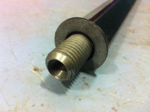

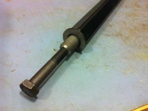

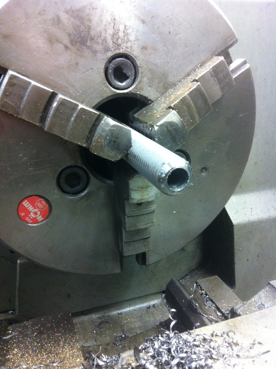

November 30, 20159 yr Author comment_482003 Rebuilt the Spindle Puller with 3/4" rod. Should be good enough now. Also ordered a 20mm thrust washer to accommodate the wider threaded rod. In the lathe... just over 14" long for good measure threaded end M12 x 1.25 M12 bolt inserted for example Link to comment https://www.classiczcars.com/forums/topic/50908-1976-280z-restoration-project/?&page=27#findComment-482003 Share on other sites More sharing options...
