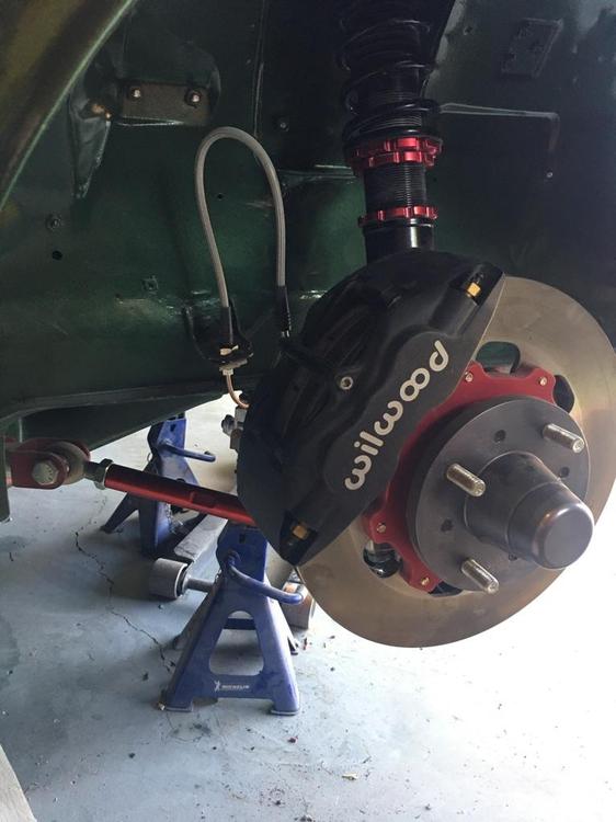

Adjusted the front coil overs a little to get a little more clearance. The added weight of all the kit I installed the last two months dropped the front end about half an inch too much. Picked her up a bit, tightened all the pretty bling suspension bits and put the vto’s back on!

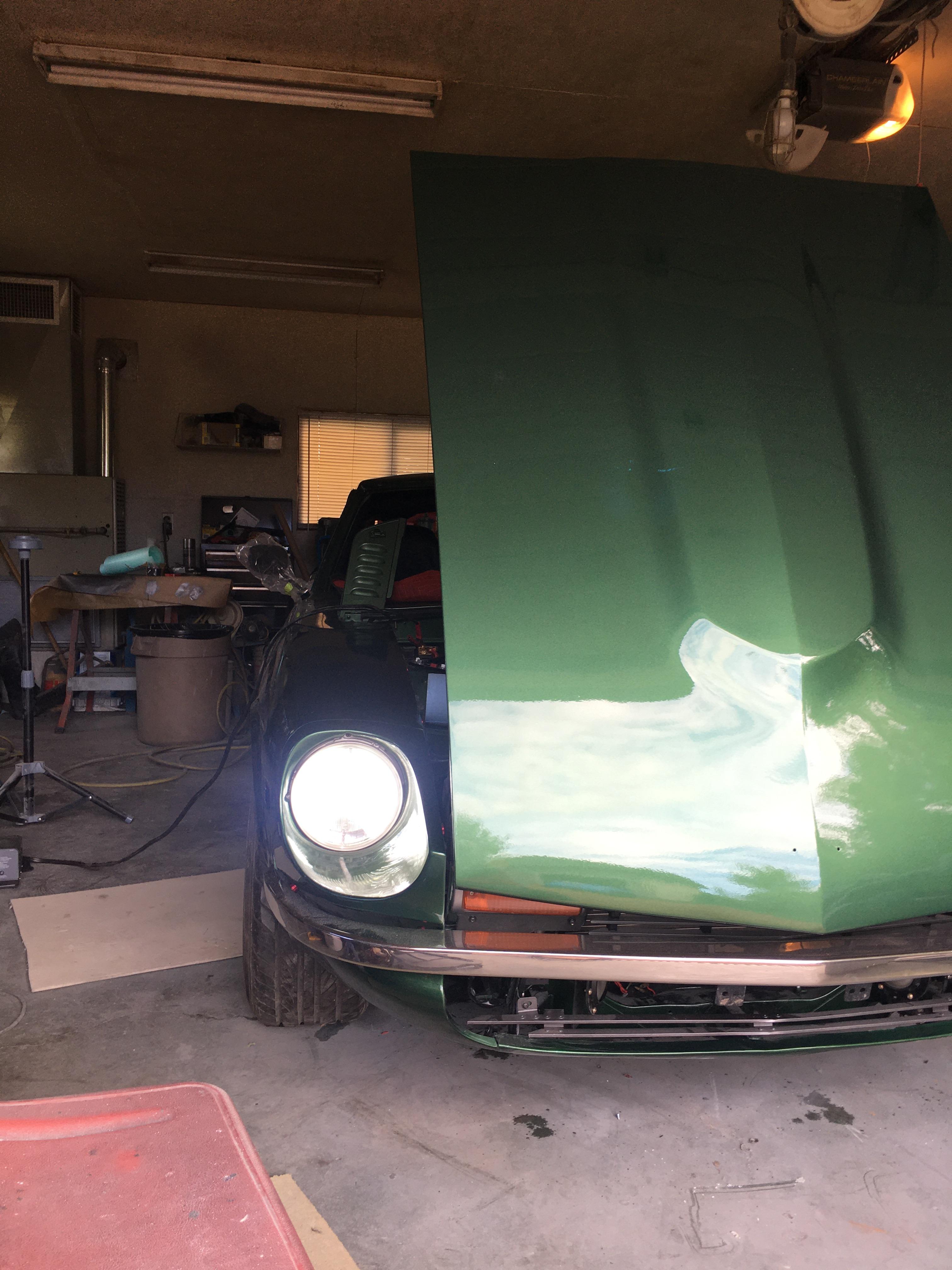

Added water to the rad for test day. Will confirm no leaks before I adjust the mix with coolant. Charged the battery, checked all the wiring and secured the engine bay.

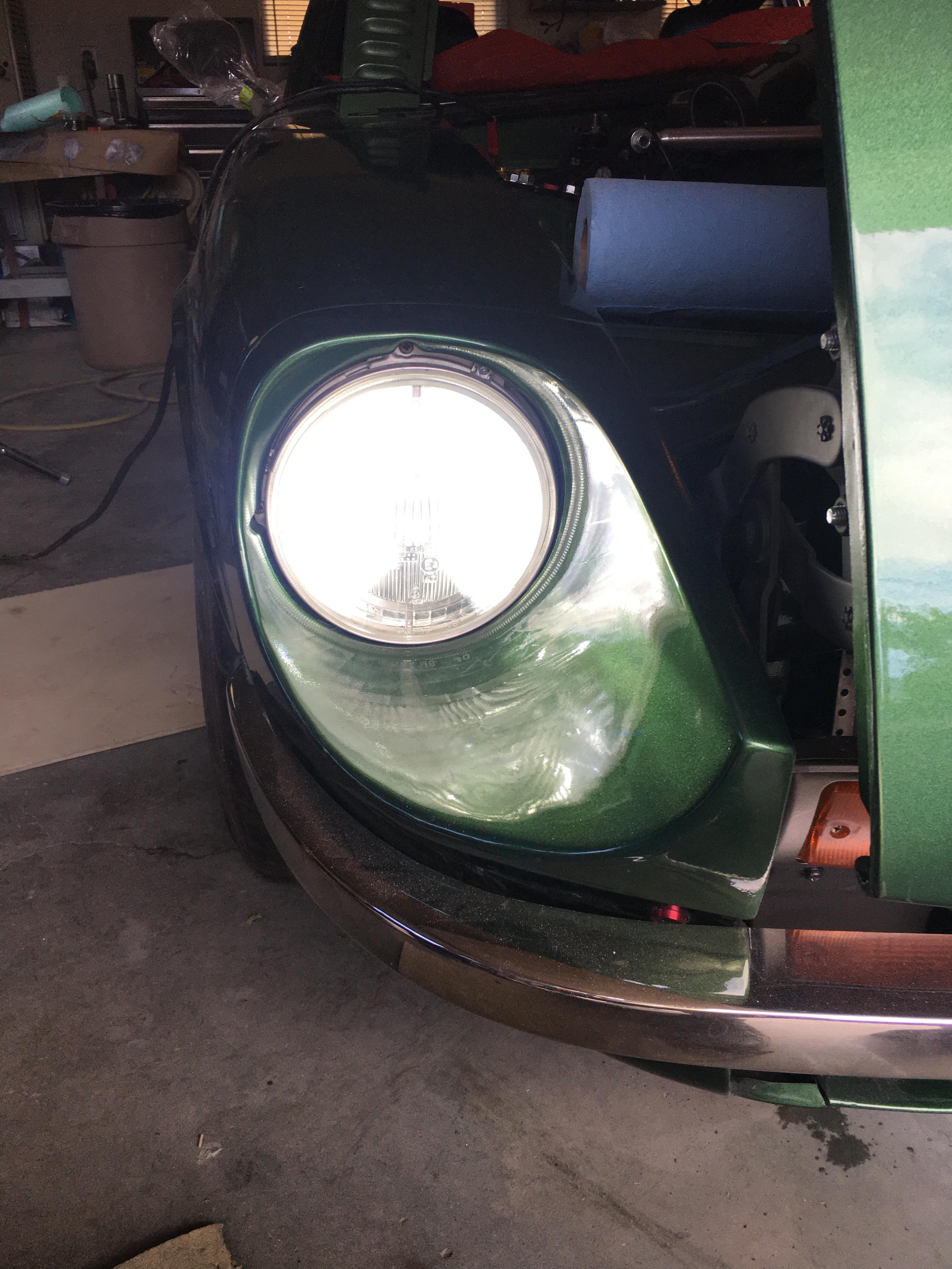

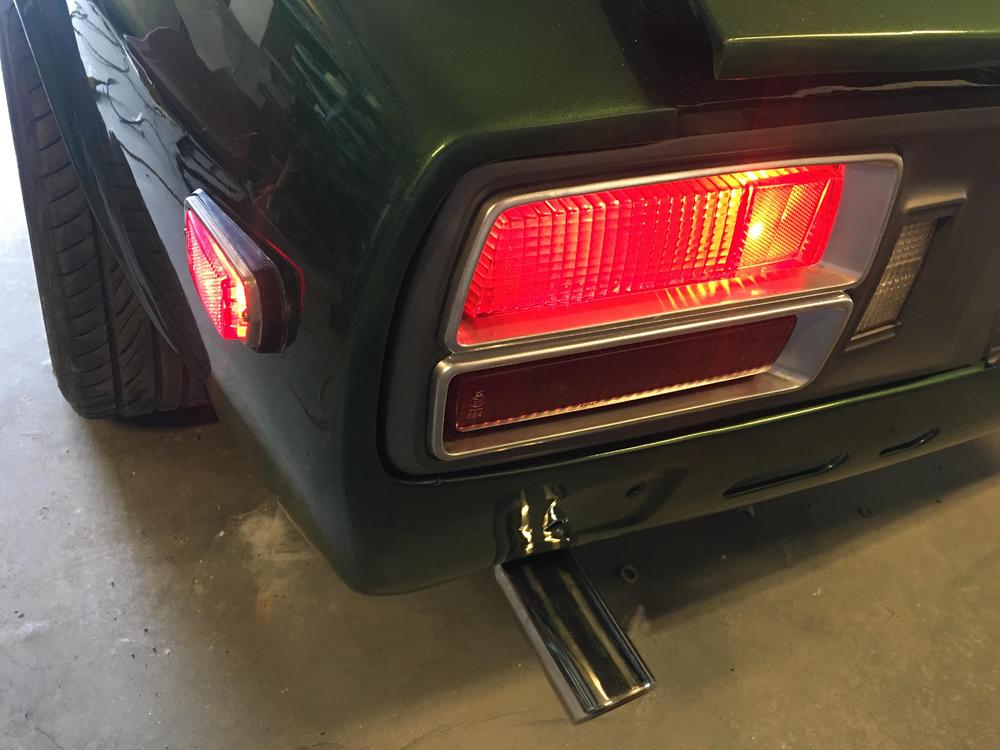

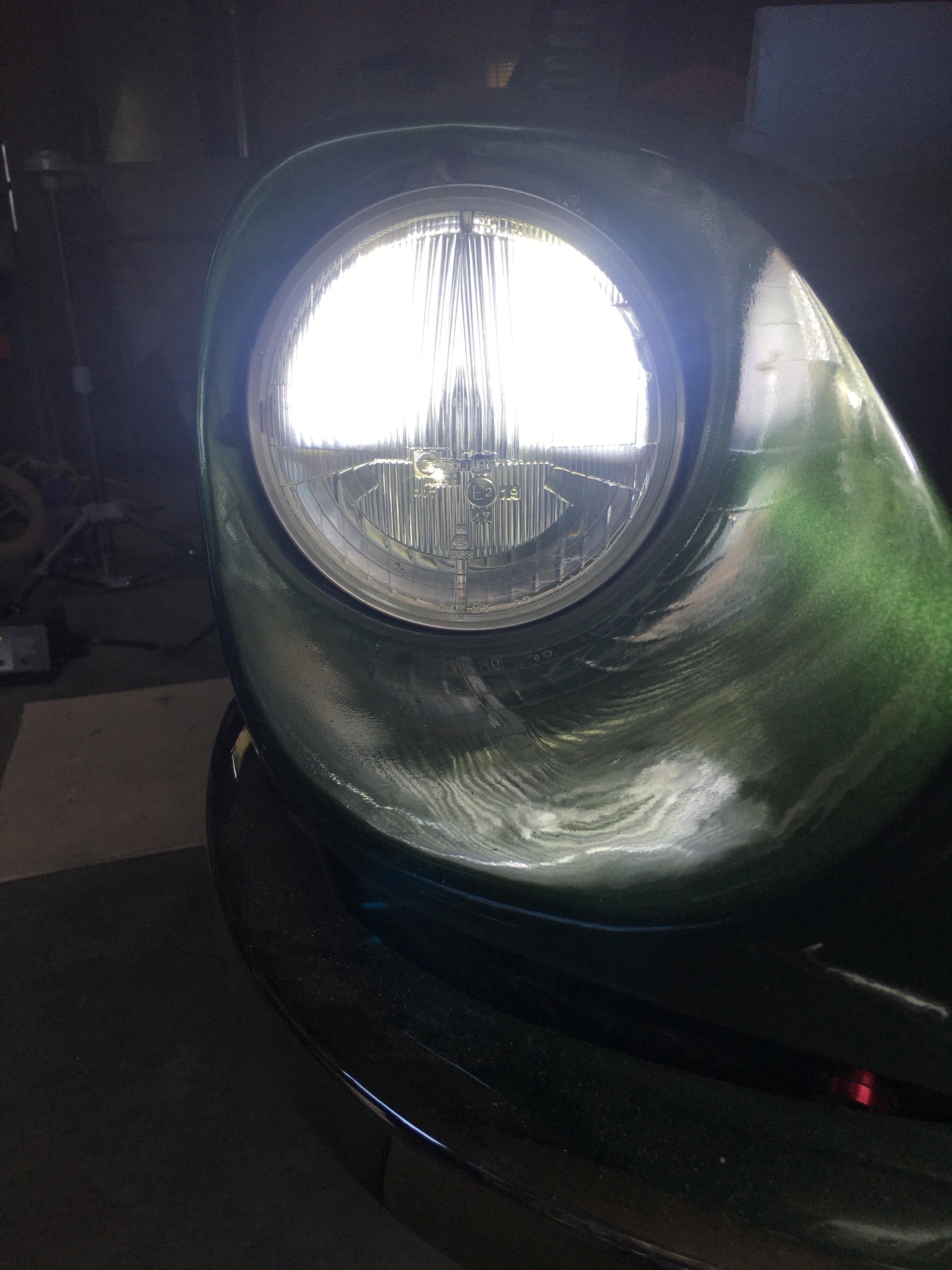

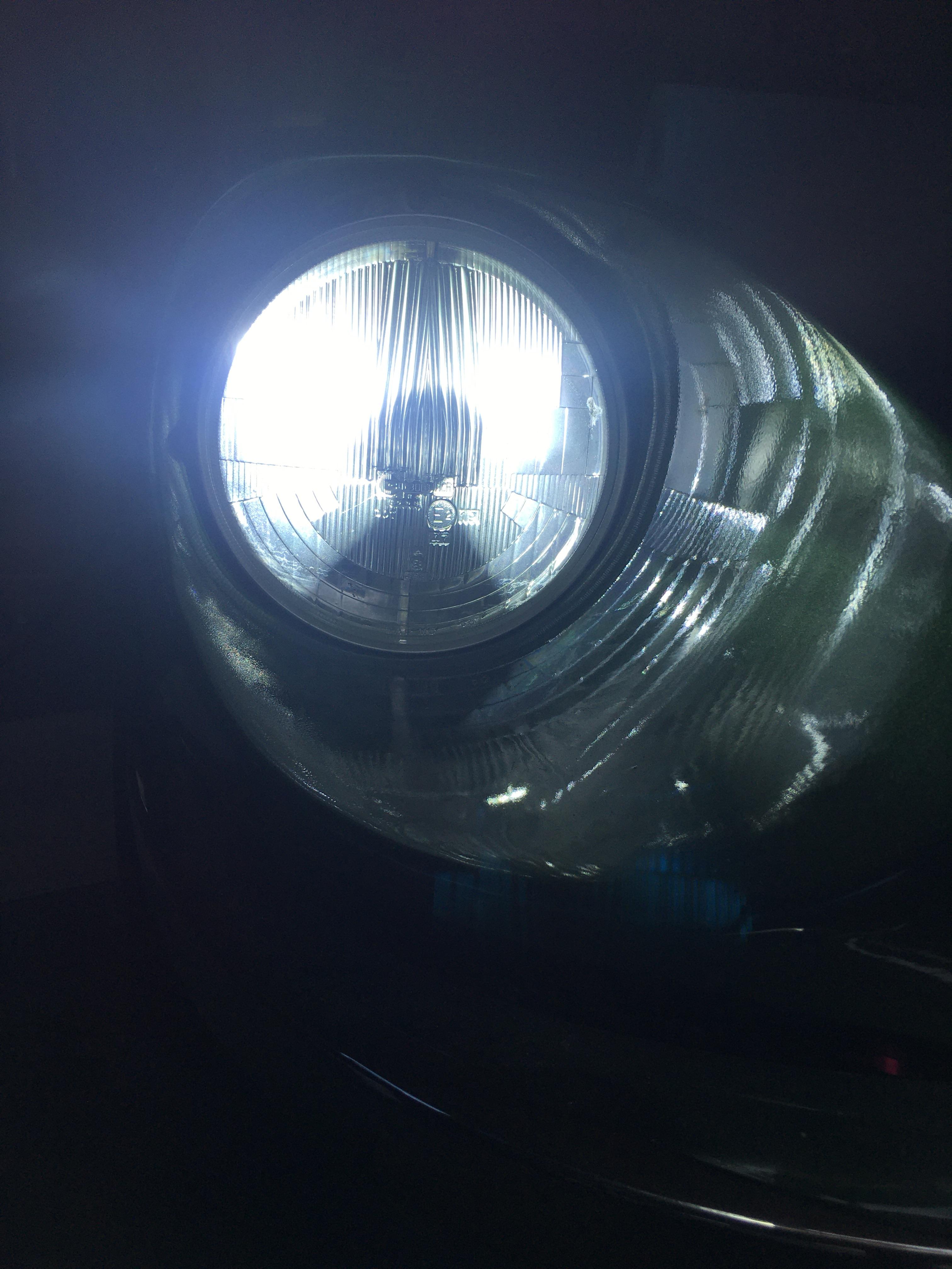

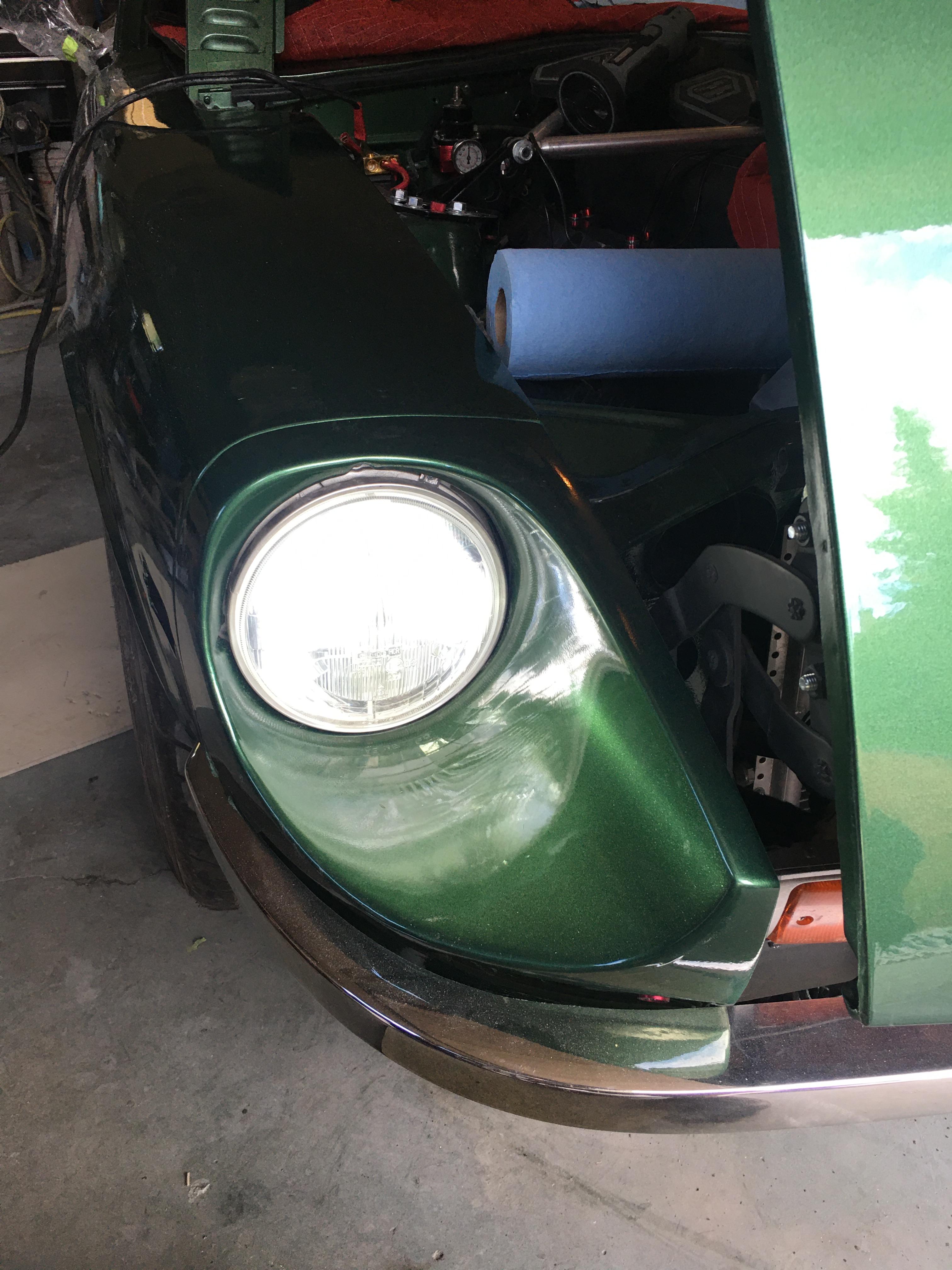

A couple of nice shiny parts arrived so installed new led 1156 bulbs in the taillights. 1157’s and shorty 1156 coming too. Some H4 LED headlight bulbs arrived too. Amazingly bright and look awesome in the period correct Cibie headlights!

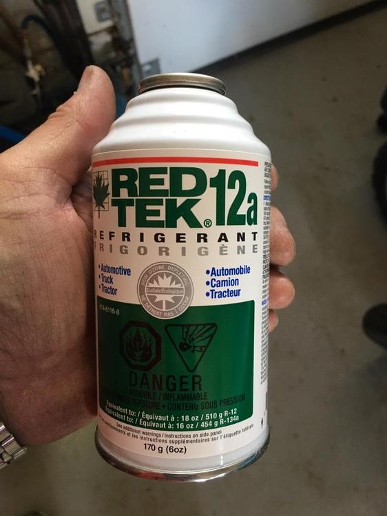

As a side note, I installed my custom fabricated A/C system using the basic VIntage Air Mini Gen II kit plus my own hose kit, condenser and drier. I was loathe to start the engine with a parasitic pump attached even without the clutch engaged with the potential for damage to the a/c system, so I purchased a vacuum pump and manifold and purged the system myself. Was pleasantly surprised to find no leaks and proceeded to load a full charge of 12a refrigerant into the system. This $200 investment was worth it to have a functioning A/C system that I can personally service rather than pay someone else to do.

Our refrigeration guy claims he has a drop in for the older walk-ins with R-12. It's in a pink bottle, 401 something I think he said. I'm going to try it someday in my 280 with factory a/c. We have about 212 percent humidity today and that drains my old arse out faster than a hangover.
Be careful with that. There have been many different substances substituted for R12 and R134, many of which are flammable or potentially explosive.
I've converted three cars from R12 to R134 and all i did was change drier, screen (orifice valve) in the AC tubing, and install a compressor with seals set up for 134. In the case of a Z or ZX, that would probably mean having a compressor rebuilt to your specs.
In each case where I did a conversion, the AC worked fine, it just took a bit longer for full cooling to build up.
