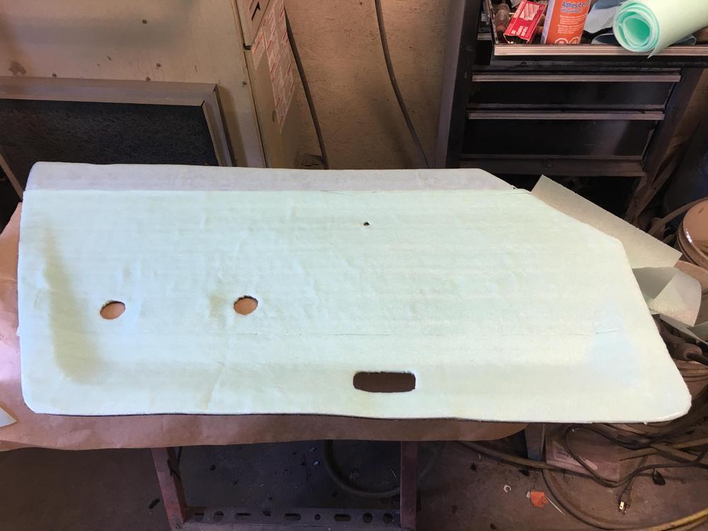

Hello Mark, I follow your build a little... and think it's going to be a very nice car!
only the door carts... You should have put some foam inbetween?  That would look much better if i dare say... :tapemouth:  Just a few mm thick is sufficient.
What you’re looking at is three or four layers of foam on that panel. The roll of it is on the tool box to the right... about 4mm’s total on each door panel!
The spray glue curled it a bit but it flattened out as it dried. The panels look flat now. Getting the thicker single layer foam was almost impossible locally and I didn’t want to wait a month for it to be shipped online. Upholstery shops in the next city wanted $100 a roll for foam.... nope.

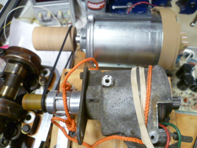

Having technical issues with the voltage settings in the CAS from OneSix. Tim (the inventor) has been super helpful but the low crank speeds and the super low voltage output of the Toyota inductors requires pre setting the voltages in Haltech very accurately. Cranking provides about 150-200 rpm and my hand drill can only go down to about 220 rpm with no real control.
I need to hook up a small electric motor with a variable speed control to set The voltages correctly at low rpm so that the trigger signal fires the COPs at low speed cranking. 220 rpm throws sparks like crazy.... not much below that.
I trash picked a treadmill a while ago and stripped out the motor and DC controller*.  I've repurposed that thing for so many different test applications that I've forgotten half of them.
Here it is recently spinning up a Z distributor so I can poke around inside the stock ignition module:
* Best time around here to find such a thing is in the spring. 1) People are doing "spring cleaning", and 2) The luster of the new year's resolutions have worn off.    LOL
