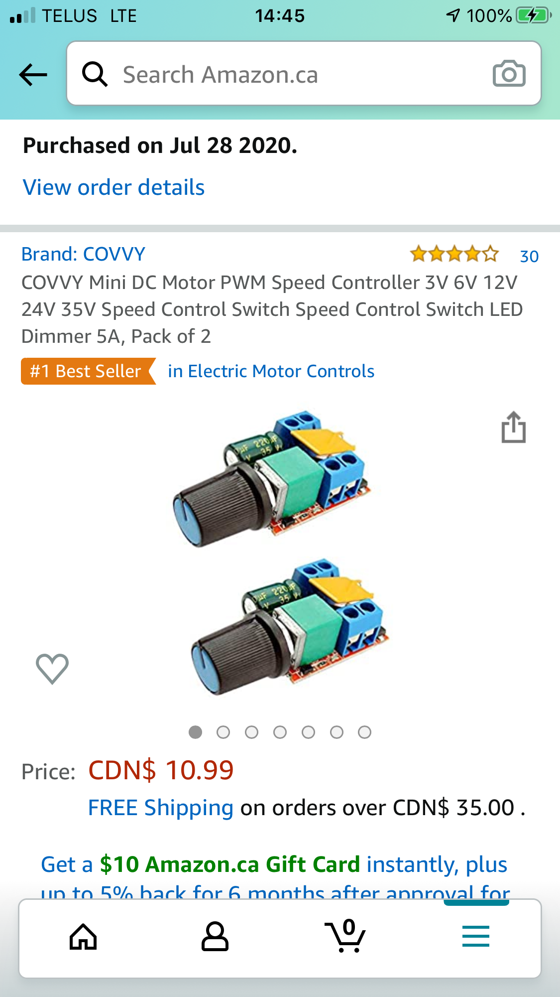

August 13, 20204 yr Author comment_604139 Here is the PWM I ordered from Amazon. It is small and easily adapted to mounting behind the stock dimmer shaft and connecting via rubber tube for flex and smooth operation. Link to comment https://www.classiczcars.com/forums/topic/50908-1976-280z-restoration-project/?&page=276#findComment-604139 Share on other sites More sharing options...

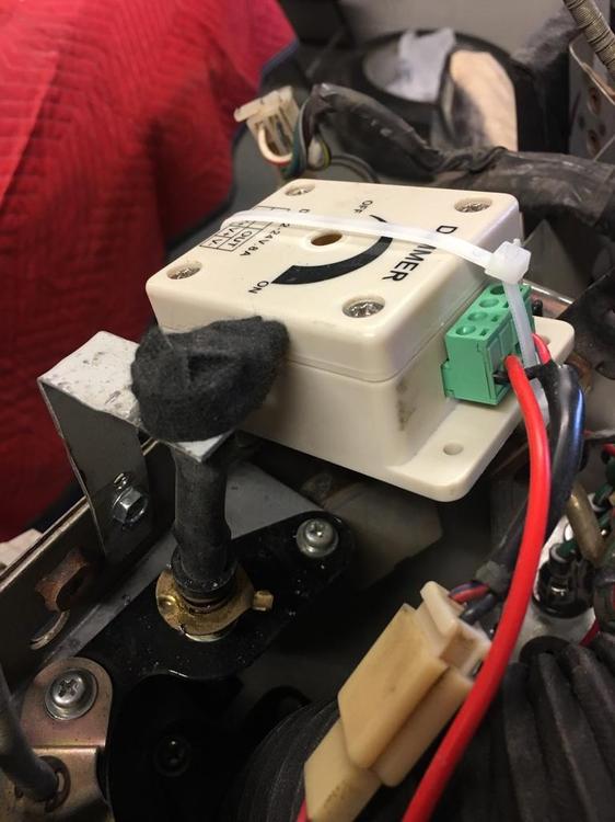

August 13, 20204 yr comment_604143 Would you have install pics? Thanks. Link to comment https://www.classiczcars.com/forums/topic/50908-1976-280z-restoration-project/?&page=276#findComment-604143 Share on other sites More sharing options...
August 13, 20204 yr Author comment_604146 Further back in the thread I have some pics of the older bulkier model I installed. Not a lot but the basic idea is to re-use the dimmer knob you have by removing the rheostat on the back end, attach a small bracket at the end of the dash metal behind the stock shaft and join the two with a section of rubber tube to create a soft join that flexes and absorbs torque. Here’s a pic of the old unit installed before it failed due to a short I accidentally created at the glove box. Link to comment https://www.classiczcars.com/forums/topic/50908-1976-280z-restoration-project/?&page=276#findComment-604146 Share on other sites More sharing options...
August 13, 20204 yr Author comment_604147 The new unit sits perfect all by itself on the bracket. Link to comment https://www.classiczcars.com/forums/topic/50908-1976-280z-restoration-project/?&page=276#findComment-604147 Share on other sites More sharing options...

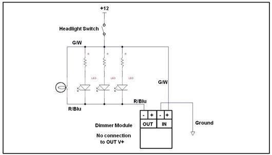

August 13, 20204 yr Author comment_604148 This is the schematic of the wiring courtesy of the immortal [mention]Captain Obvious [/mention] Link to comment https://www.classiczcars.com/forums/topic/50908-1976-280z-restoration-project/?&page=276#findComment-604148 Share on other sites More sharing options...
