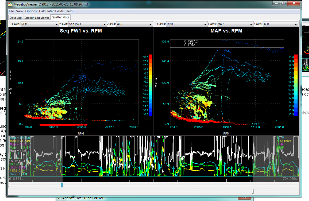

September 15, 20204 yr comment_605988 Not the "tune' files, the actual "what happened" files. Here's some Megasquirt examples, below. Haltech should have the same ability. Just because you told the ECU to do something doesn't mean it actually happened. Plus, the quality of the trigger signal and it's timing should be there. You might already have data from when the engine ran, stored somewhere. Just another option. It's looking like Plug 'n' Play isn't playing. Which Haltech system are you using? 133 pages is too many to look back through. Megasquirt also has a signal simulator that can be used to verify outputs are following inputs like they should. I'm not recommending Megasquirt just saying that a company like Haltech should have similar. https://www.diyautotune.com/product/jimstim-1-5-megasquirt-stimulator-w-wheel-simulator-assembled/ https://www.efianalytics.com/MegaLogViewer/ Link to comment https://www.classiczcars.com/forums/topic/50908-1976-280z-restoration-project/?&page=278#findComment-605988 Share on other sites More sharing options...
