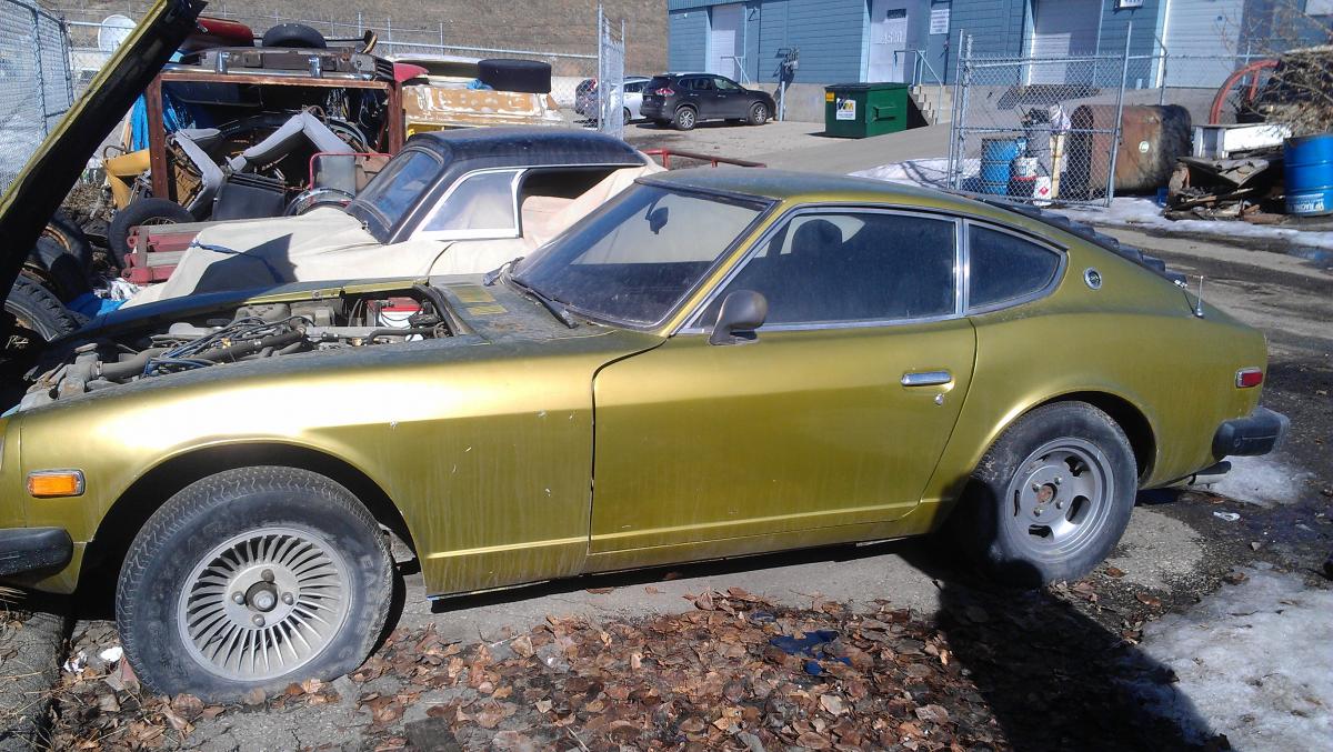

July 4, 20213 yr comment_624523 That's a nice reward for all those hours spent on the restoration. Perhaps it's time for you to re-post a picture of what the car looked like when you started... Edited July 4, 20213 yr by Namerow Link to comment https://www.classiczcars.com/forums/topic/50908-1976-280z-restoration-project/?&page=288#findComment-624523 Share on other sites More sharing options...
July 5, 20213 yr Author comment_624574 Half of that sheet metal was replaced... new fenders, cowl cover, floors, frames, nacelles and under-bumper panel..... ugh! Link to comment https://www.classiczcars.com/forums/topic/50908-1976-280z-restoration-project/?&page=288#findComment-624574 Share on other sites More sharing options...
