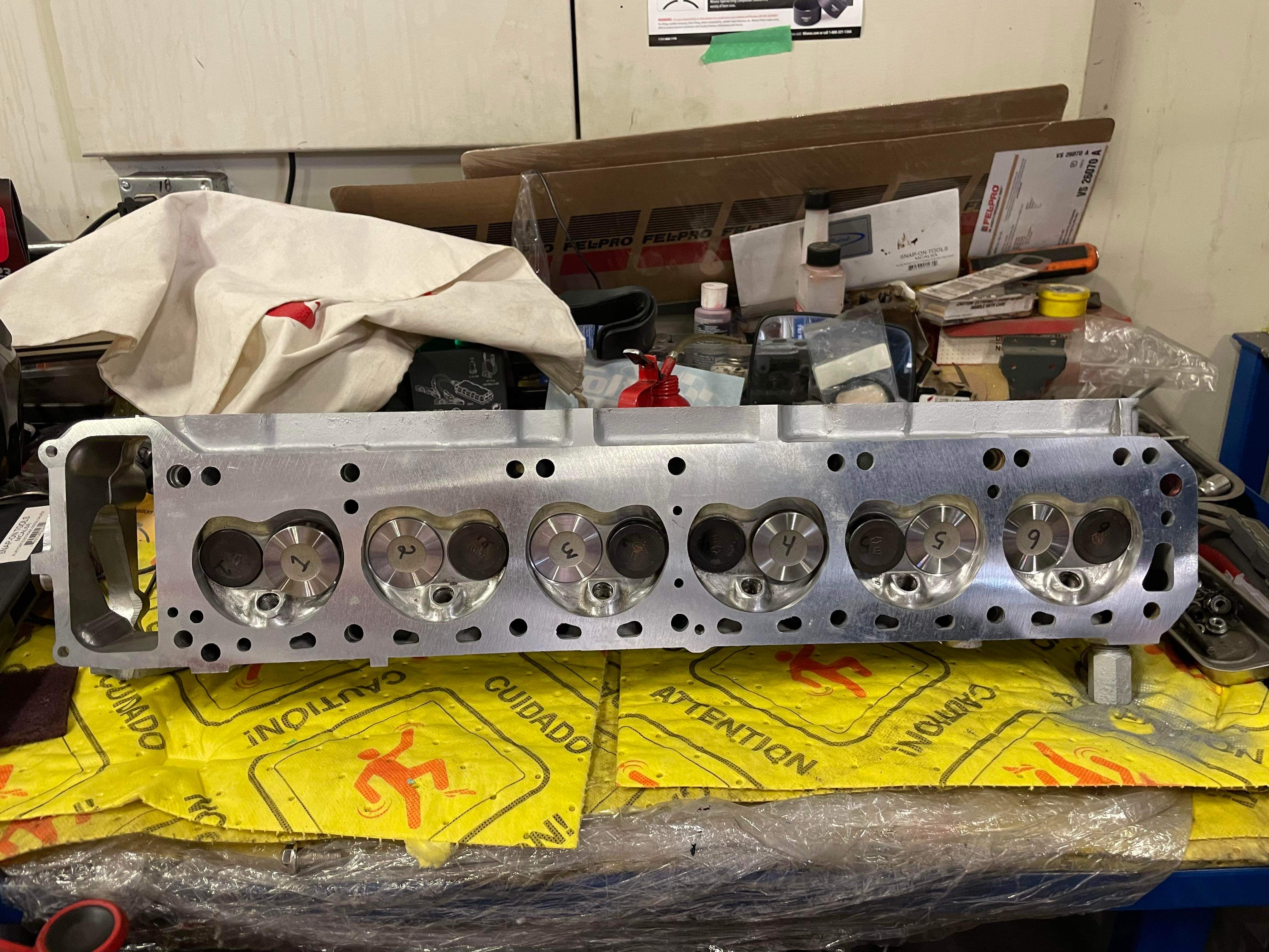

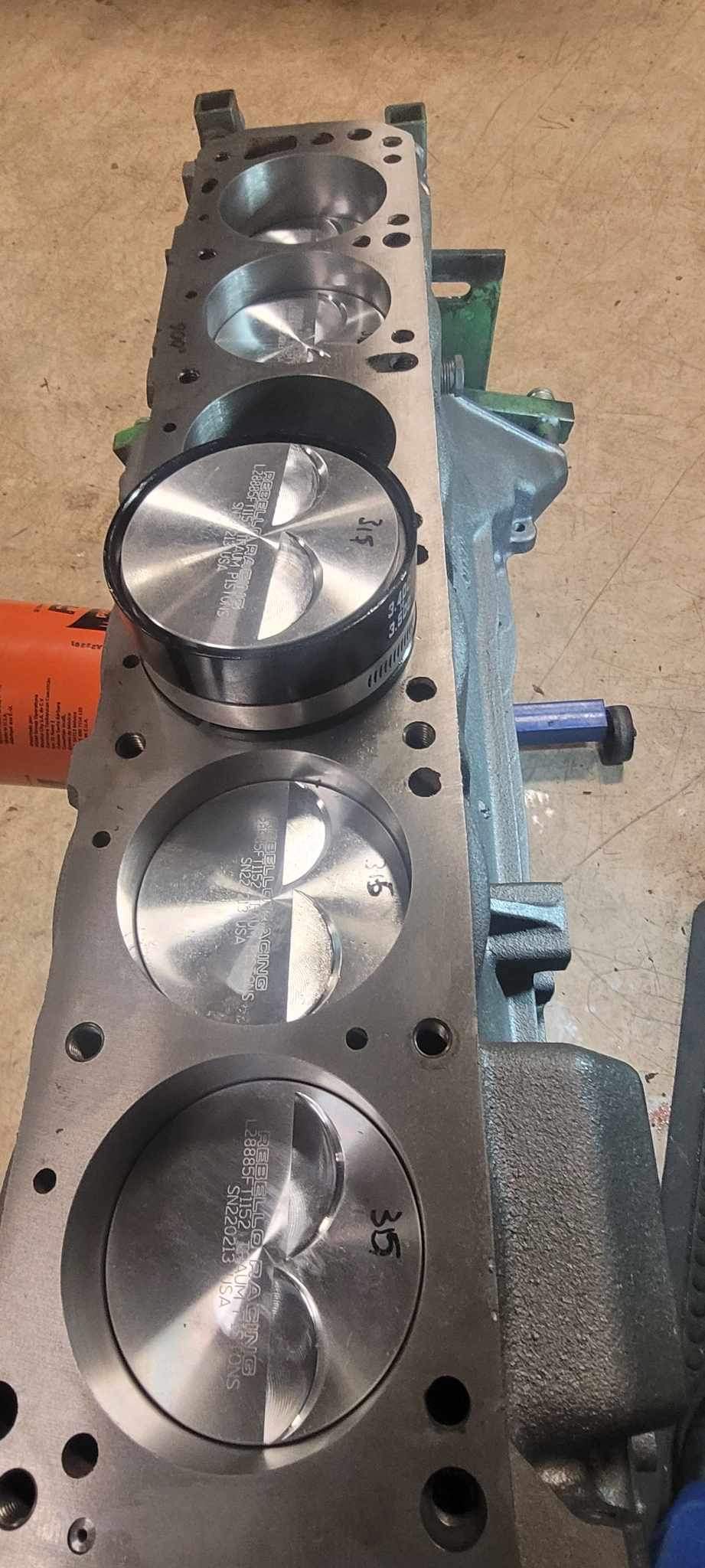

8 hours ago, dutchzcarguy said:

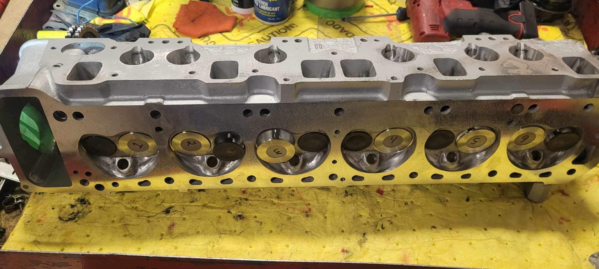

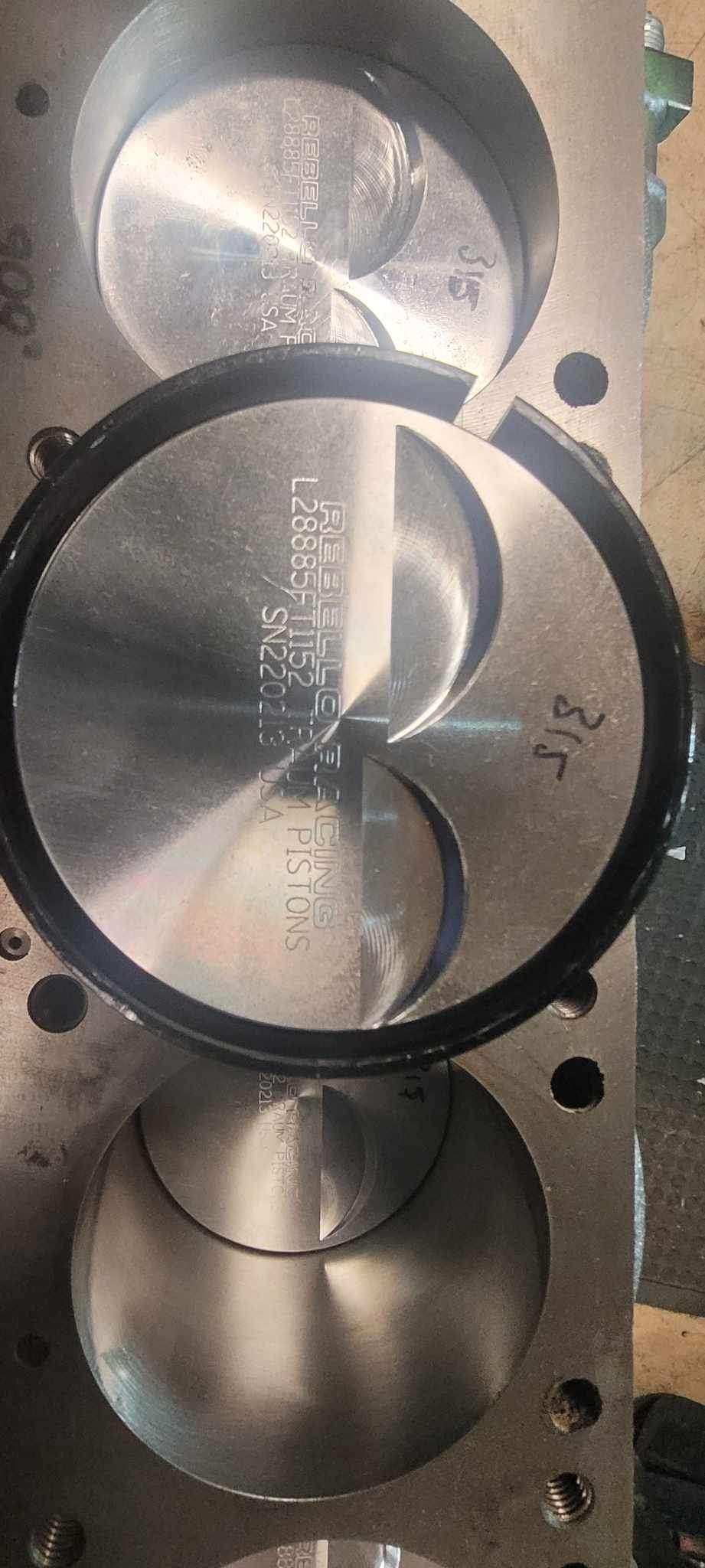

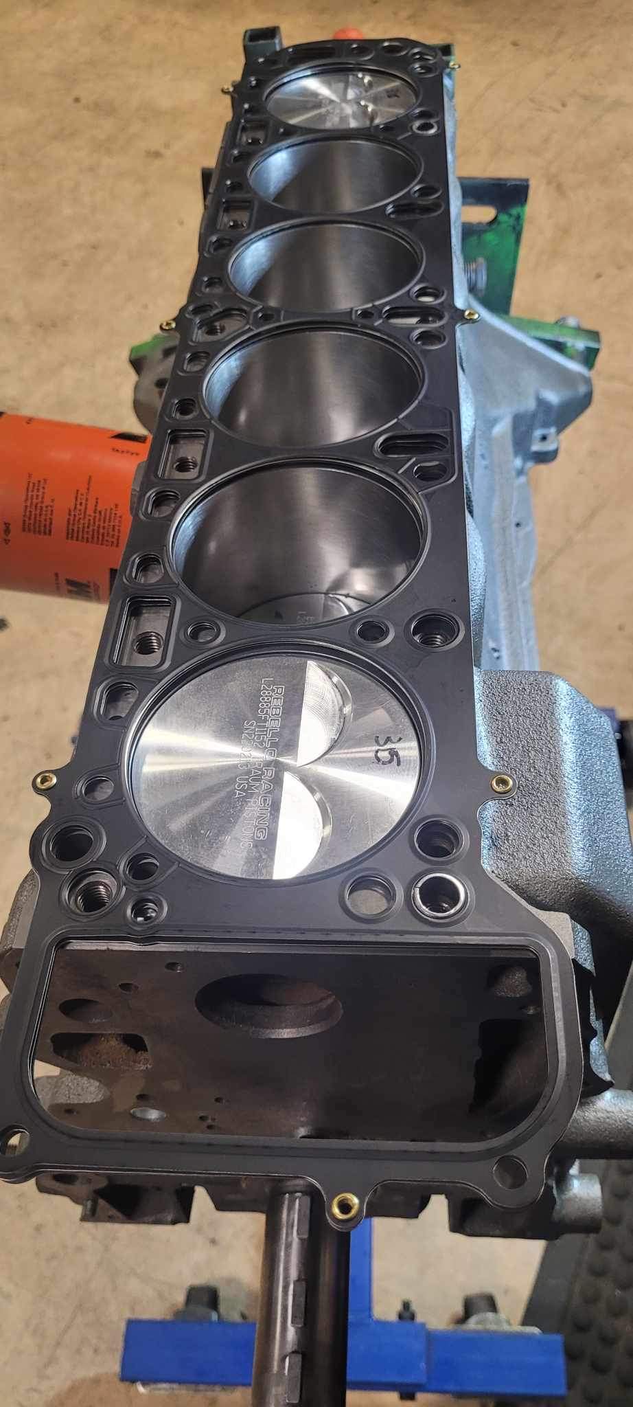

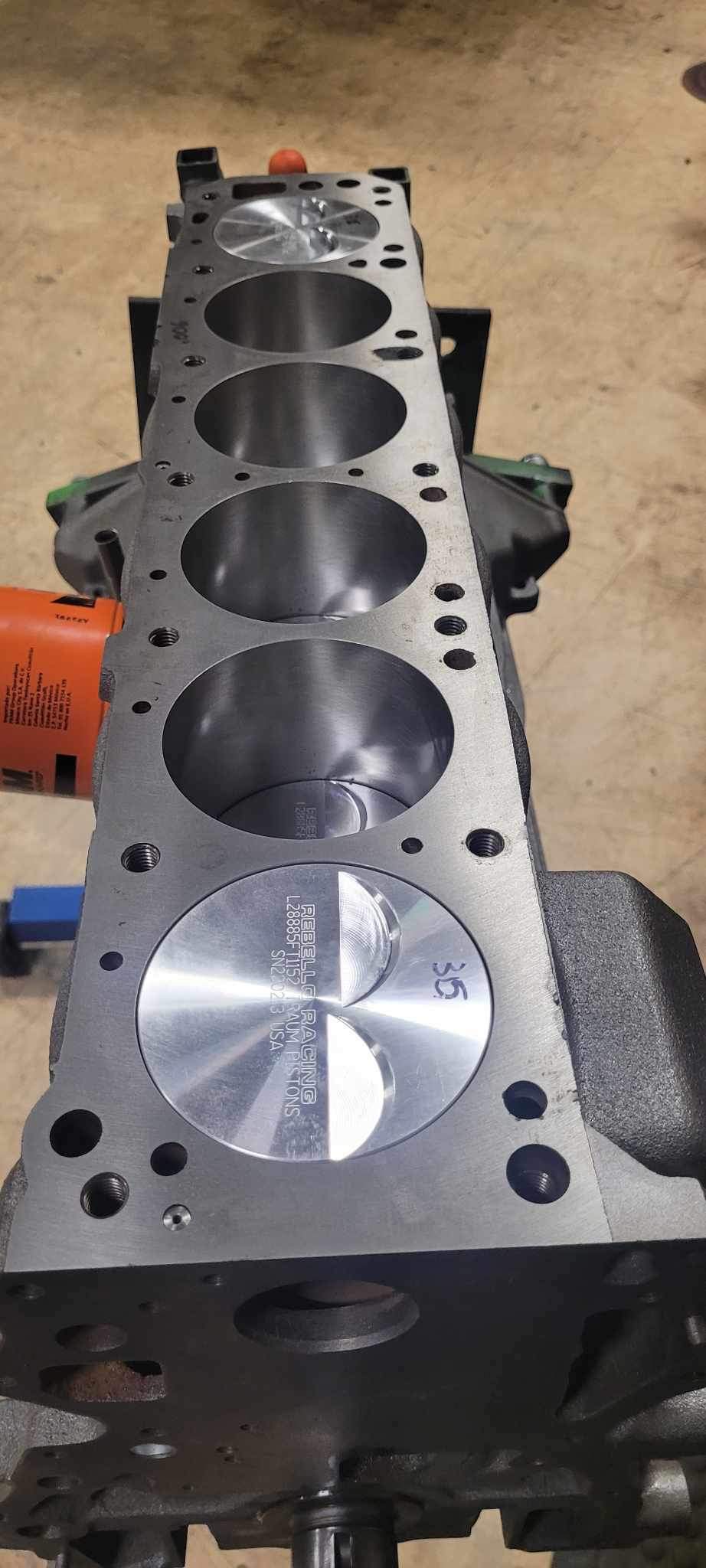

Am i right.. you must have 2 different pistons? (the indents on top are different) ?
The reliefs are going to be different depending on the orientation of the intake and exhaust valves in each cylinder.  Half are I-E and the others are E-I.
  • Agree 1
  • Thanks 1
Would suck to mess that up!!
  • Agree 1
That's what i meant.. I and E valves are on diff places so watch the orientation.. As Jeff said: half is I-E and the others are E-I.
I guess Rebello already had numbered the pistons, so you only have to put them in the right spot.
Btw. did you know that Traum in german means: dream?  those are dream-pistons! 😃
