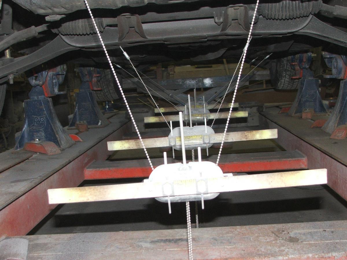

  On 2/14/2015 at 11:43 PM, Patcon said:
I have all the tools you are talking about but would never attempt to straighten my own car. The frame rack gives a great datum line to work off of and has zero flex. So when you pull or push against it the measurements are correct. The welds you put into the car to do floorboards or sheet metal repairs are harder than the original metal. It is probably best to get the car checked and straight then do one side at a time. Be sure to put the transmission crossmember in so the tunnel doesn't move on you. I commented on how I did my floor boards on another thread. When they were done they looked factory. At the moment I don't recall which thread and am too tired to figure it out... ;)
C
This an old scool frame rack.
It gives you an idea of what is involved.
Casey
