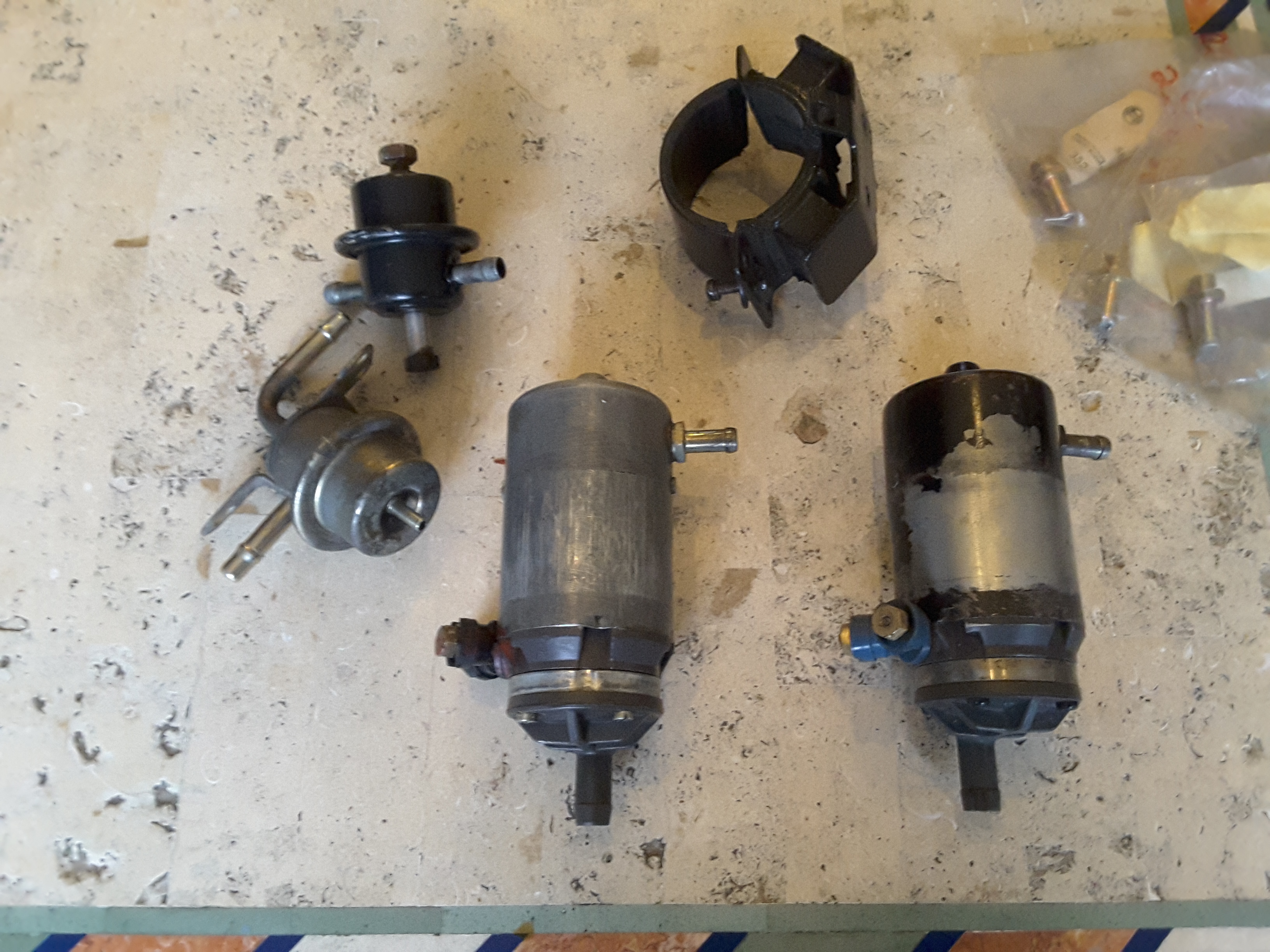

The one with the black trrminals is a Bosch pn: 0 580 464 005 and the blue terminal unit is a JECS (also sold under licience via Hitachi) with pn: A42-000084.
Here is a photo of the two next to each other. The one on the left is the bosch.
If you google those numbers you won't find much these days. A couple of ebay vendors still have some under the 280ZX nisan pn.17011-P7211.
Funny thing is the photo's show a bosch pump in a nissan box. From what info I can find JECS stopped making them becauee demand was two low, but bosch made them for a couple of years longer because the L-Jetronic used them on all kinds of european cars in the seventies. Bosch now quotes the 0 580 254 044 as a replacement.

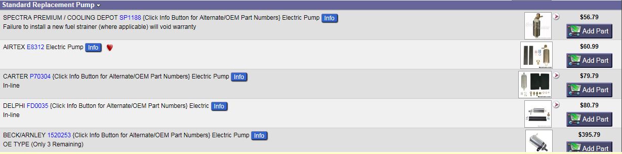

Great info EuroDat.  Not trying to hijack Wheee's excellent restoration thread.  But this seems like an appropriate place to ask:
As my fuel pump is suspect until I can test it next week, I've been looking at pumps too.  I noticed a bunch of "replacement" ones.  I assume they are "replacement" in the sense that they are fuel pumps that provide enough pressure and flow, but not mechanically identical to OEM?  For example, I see on RockAuto they have the Beck/Arnley OEM pump for $396, and several "replacement" ones, such as a Delphi for $81, and others.  If one doesn't care about originality, or needs one for temporary use, wouldn't this be another option?  I'd assume a mounting bracket or adapter would be necessary.
