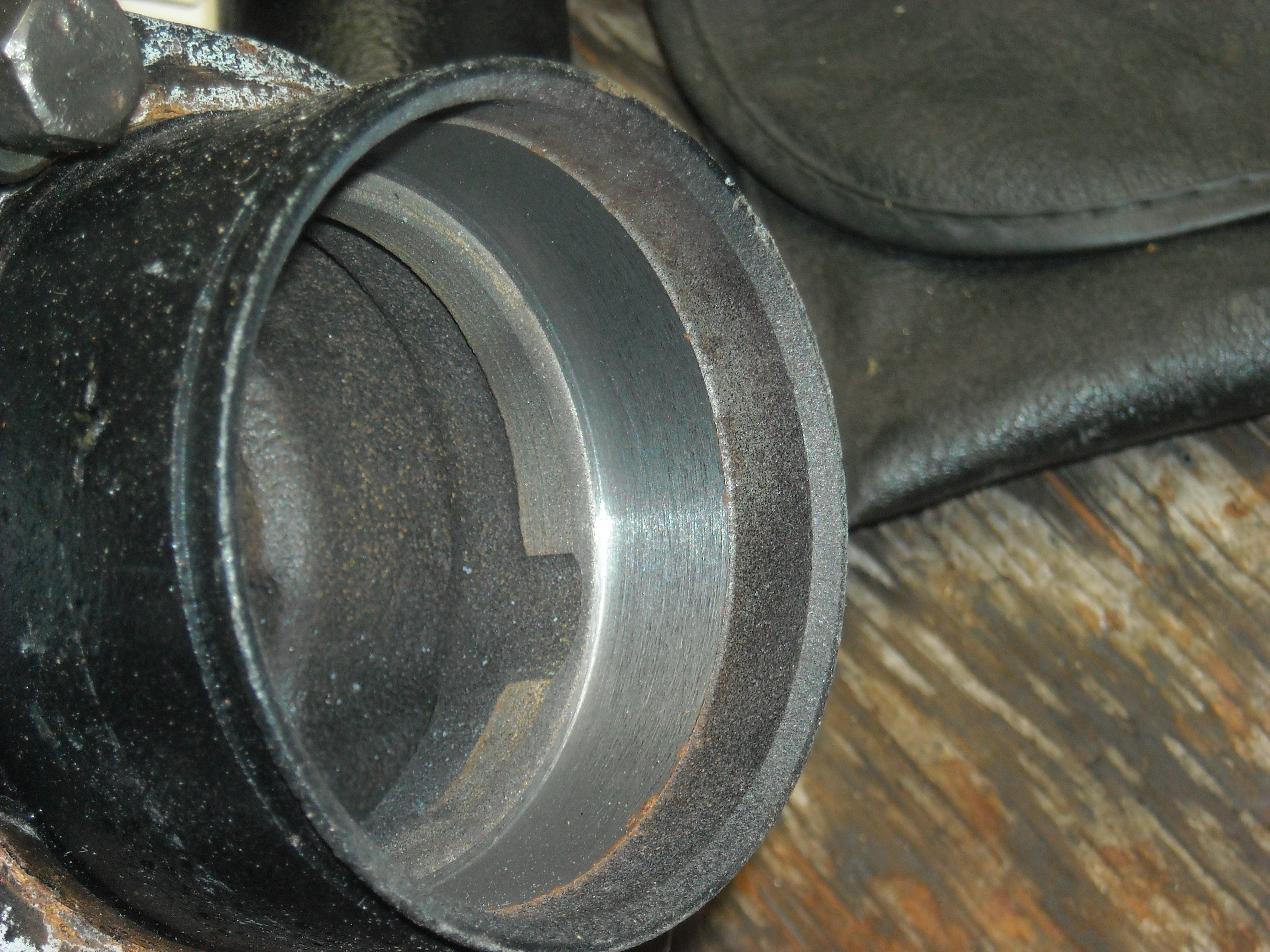

March 8, 20169 yr comment_488076 27 minutes ago, Captain Obvious said: I nabbed this pic off the internets a few years ago. It's one of the Z car parts vendors five lug conversion axle mod. Unfortunately I don't remember which vendor it was from, but I'm sure someone here will recognize it. I had thought that they added material for just one lug, but looking at it again now, it appears they actually added material for TWO of the new hole locations: Of course, the best option would be to use the completely new stub axles supplied by one of the other vendors (who's name I can't come up with either), but I know they're pricey. Try silverminemotors.com. They have new ones on sale, a bit pricey but they look good. Link to comment https://www.classiczcars.com/forums/topic/50908-1976-280z-restoration-project/?&page=57#findComment-488076 Share on other sites More sharing options...

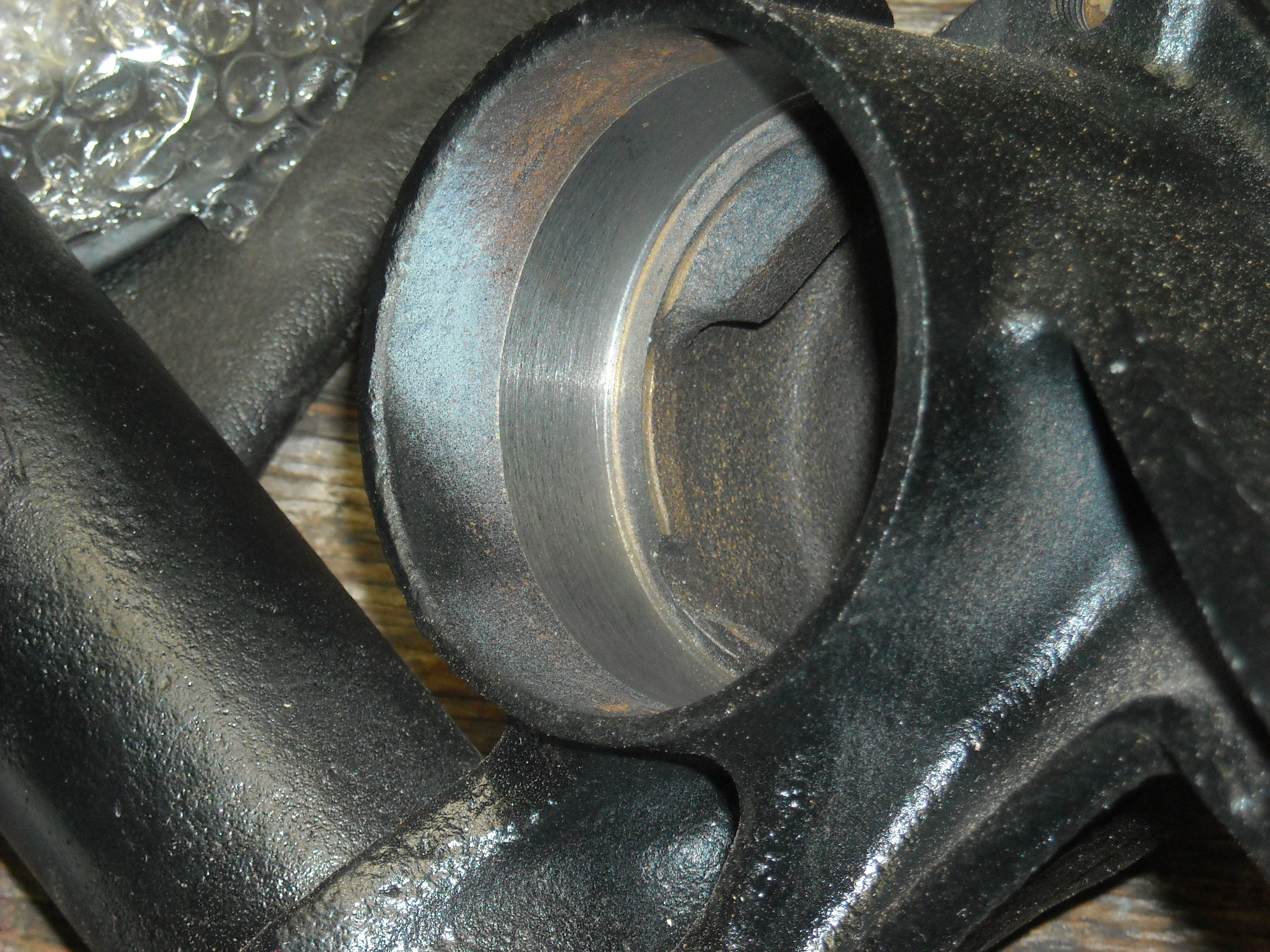

March 9, 20169 yr comment_488108 6 hours ago, wheee! said: Basically, the 280ZX stub axle has a different OD (outside diameter) where the inner and outer wheel bearings are seated, so it uses different wheel bearing than the S30. The OD of the 280ZX rear wheel bearings will not fit the S30 rear strut. In other words, the 280ZX stub axles will not fit. UNLESS, you mill out the tiny difference between the bearings then you can use your 280zx stubs with 240 hubs, inside and outside bearings are the same larger OD with the smaller 280ZX ID, Link to comment https://www.classiczcars.com/forums/topic/50908-1976-280z-restoration-project/?&page=57#findComment-488108 Share on other sites More sharing options...
March 9, 20169 yr Author comment_488109 Basically, the 280ZX stub axle has a different OD (outside diameter) where the inner and outer wheel bearings are seated, so it uses different wheel bearing than the S30. The OD of the 280ZX rear wheel bearings will not fit the S30 rear strut. In other words, the 280ZX stub axles will not fit. UNLESS, you mill out the tiny difference between the bearings then you can use your 280zx stubs with 240 hubs, inside and outside bearings are the same larger OD with the smaller 280ZX ID, Cool! Won't help me and the 280 hubs I have though... I'll hang onto these in case someone else can use them. Link to comment https://www.classiczcars.com/forums/topic/50908-1976-280z-restoration-project/?&page=57#findComment-488109 Share on other sites More sharing options...
March 9, 20169 yr comment_488111 One of the guys in that Hybridz thread talked about doing the same to use 300ZX (Z31) 5 lug axles, with 280Z hubs. He said it was 72mm also though. Seems like there are many ways to get there. Machine the hubs, machine the bearings, machine the axles, Redi-sleeve the bearings, Redi-sleeve the axles, drill what you got. Buy aftermarket. Link to comment https://www.classiczcars.com/forums/topic/50908-1976-280z-restoration-project/?&page=57#findComment-488111 Share on other sites More sharing options...
March 9, 20169 yr Author comment_488113 One of the guys in that Hybridz thread talked about doing the same to use 300ZX (Z31) 5 lug axles, with 280Z hubs. He said it was 72mm also though. Seems like there are many ways to get there. Machine the hubs, machine the bearings, machine the axles, Redi-sleeve the bearings, Redi-sleeve the axles, drill what you got. Buy aftermarket. No shortage of options! I think I will just drill the stock parts I have! Link to comment https://www.classiczcars.com/forums/topic/50908-1976-280z-restoration-project/?&page=57#findComment-488113 Share on other sites More sharing options...
