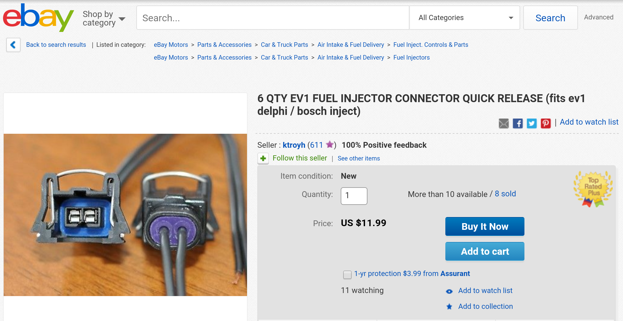

March 11, 20169 yr comment_488243 I used new EV1 connector with the quick release sprinb clip. Had them for more than a year now and no problems. They cost $25 including shipping to the netherlands. Everything I found here in the wrecking yard was old, dirty and corroded. I made a screen shot of one of the vendors with the same connectors. I asked him to send via USPS instead of Ebays global shipping charges. Savd $5. Like your idea of making a sub-harness. It will look good with the pallnet fuel rail. Link to comment https://www.classiczcars.com/forums/topic/50908-1976-280z-restoration-project/?&page=59#findComment-488243 Share on other sites More sharing options...
March 11, 20169 yr Author comment_488255 I pulled the EV-1 quik clips off a newer Audi. The clips all looked brand new and had no corrosion. Lots of wire to work with so my splices will all look factory when I'm done. The wrecking yard didn't charge me for the harness, only the injectors! $6.99 each... Link to comment https://www.classiczcars.com/forums/topic/50908-1976-280z-restoration-project/?&page=59#findComment-488255 Share on other sites More sharing options...
