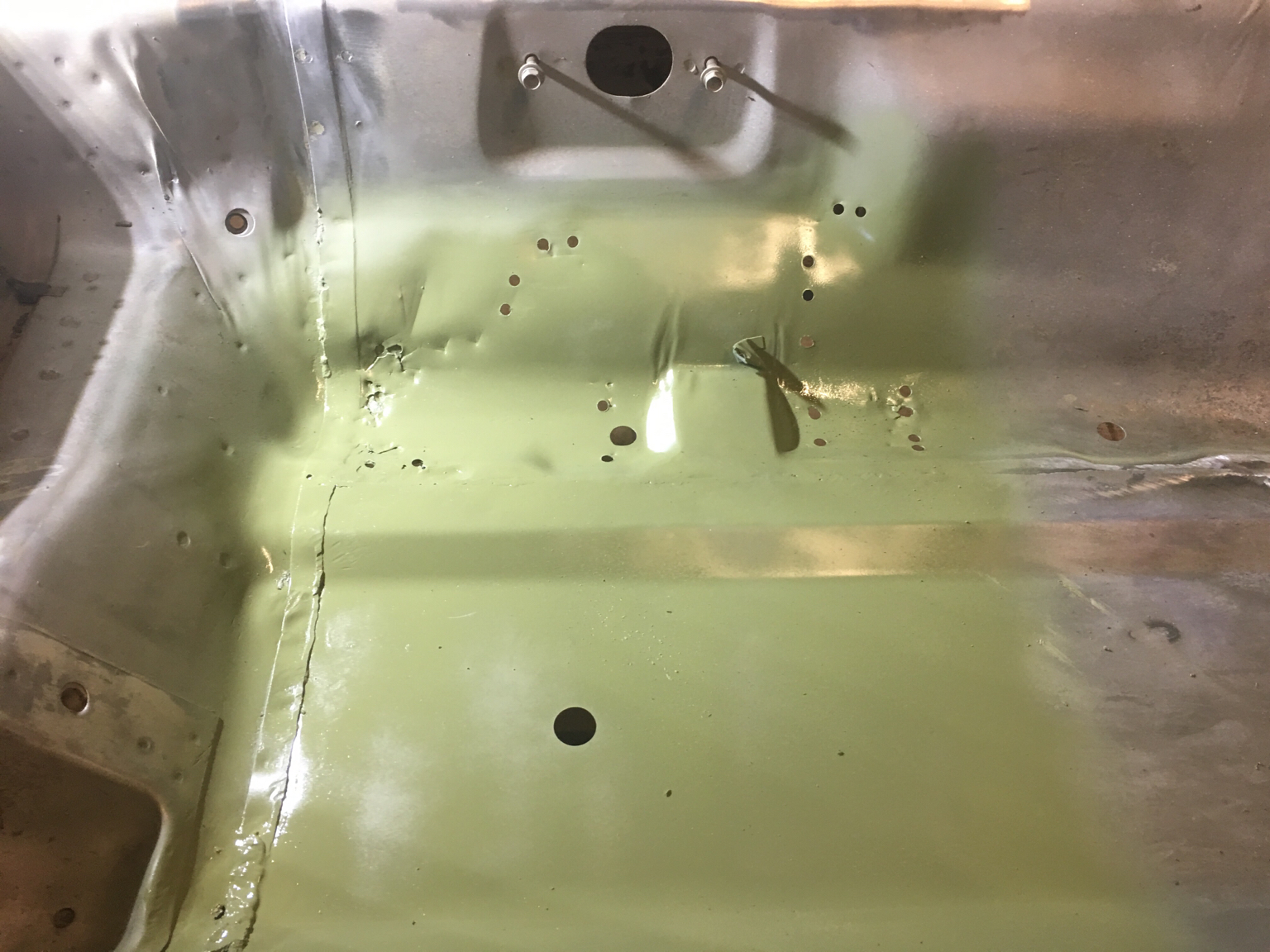

Still trying to muddle through the metal work. Lots to do and so little time these days it seems. Looking forward to having the front frame section replaced by Christmas...
