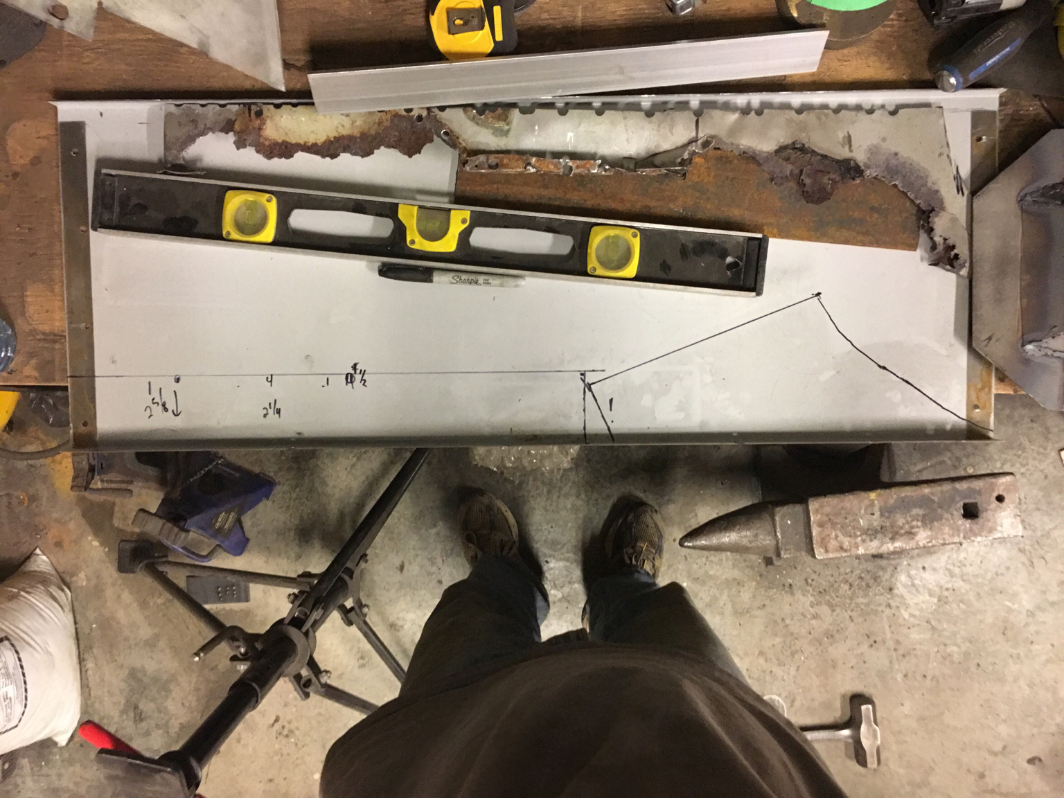

December 6, 20168 yr Author comment_507519 A little more work in the shop tonight. Got more of the frame rail metal work done. And some new metal mapped out for replacement. Link to comment https://www.classiczcars.com/forums/topic/50908-1976-280z-restoration-project/?&page=78#findComment-507519 Share on other sites More sharing options...
December 8, 20168 yr Author comment_507618 Cut out the replacement sheet metal and fitted it up to the car and frame rail. Link to comment https://www.classiczcars.com/forums/topic/50908-1976-280z-restoration-project/?&page=78#findComment-507618 Share on other sites More sharing options...
December 8, 20168 yr Author comment_507619 Now I have to prep the inner part of the panel with internal frame coat, align the frame rail, and weld it all together... Link to comment https://www.classiczcars.com/forums/topic/50908-1976-280z-restoration-project/?&page=78#findComment-507619 Share on other sites More sharing options...

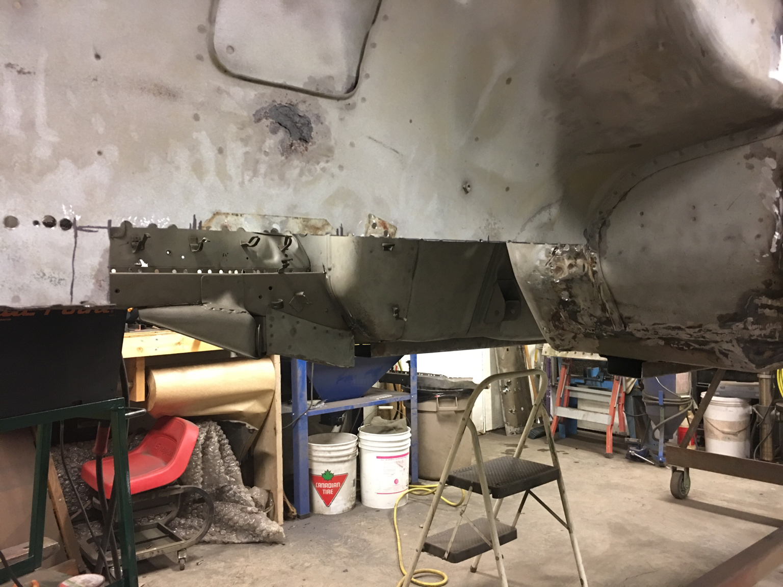

December 8, 20168 yr comment_507638 Looking good! Did you have to reinforce the car to keep it from sagging in the rotisserie once you cut the frame out? Link to comment https://www.classiczcars.com/forums/topic/50908-1976-280z-restoration-project/?&page=78#findComment-507638 Share on other sites More sharing options...
December 8, 20168 yr Author comment_507640 3 minutes ago, ksechler said: Looking good! Did you have to reinforce the car to keep it from sagging in the rotisserie once you cut the frame out? No, I only cut one side out and left the other intact. The car is bolted to the rotisserie by the old bumper shock mounts which seem to transmit the weight distribution fairly evenly over the front of the car. Even though, the car weighs very little right now... There was no flex in the body at all when I removed the rail. Having said that, I have some tripod style jack supports that will go under the frame rail and provide some "push" for a tight fit to weld the rail back into place. Link to comment https://www.classiczcars.com/forums/topic/50908-1976-280z-restoration-project/?&page=78#findComment-507640 Share on other sites More sharing options...
December 8, 20168 yr comment_507641 2 minutes ago, wheee! said: No, I only cut one side out and left the other intact. The car is bolted to the rotisserie by the old bumper shock mounts which seem to transmit the weight distribution fairly evenly over the front of the car. Even though, the car weighs very little right now... There was no flex in the body at all when I removed the rail. Having said that, I have some tripod style jack supports that will go under the frame rail and provide some "push" for a tight fit to weld the rail back into place. Makes sense. I figured you had it under control. You're definitely bringing that one back from dead! Link to comment https://www.classiczcars.com/forums/topic/50908-1976-280z-restoration-project/?&page=78#findComment-507641 Share on other sites More sharing options...
