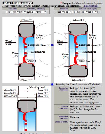

February 28, 20178 yr Author comment_514035 Well, after a lot of soul searching and hand wringing, I think I have reached a decision regarding the wheels and brakes. I was going to go with the Arizona Z Car track brakes in 5 bolt pattern, but now I feel I will be happier with the 4 bolt pattern brakes they sell and then going with the 16x8 +4mm ET ROTA RB wheels and 225/50R16 tires. This will give me adequate clearance, no rubbing and lots of meaty tire tread. This should look better than the 5 bolt wheels in the end too... More period correct. Link to comment https://www.classiczcars.com/forums/topic/50908-1976-280z-restoration-project/?&page=95#findComment-514035 Share on other sites More sharing options...

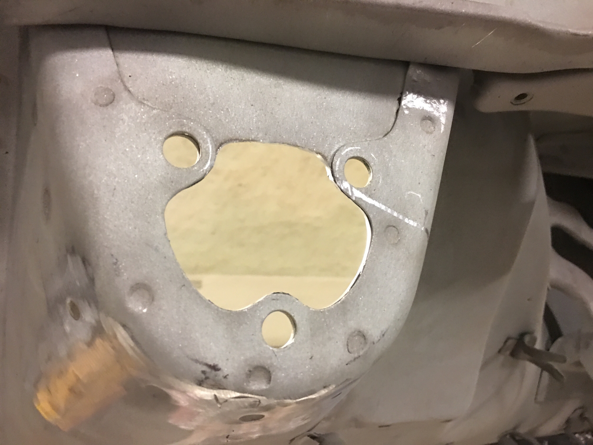

March 2, 20178 yr Author comment_514205 Rough cut for the shock towers. Looks good and the strut brace I add later will reinforce from the top too. Link to comment https://www.classiczcars.com/forums/topic/50908-1976-280z-restoration-project/?&page=95#findComment-514205 Share on other sites More sharing options...
March 3, 20178 yr comment_514275 I like the cut, very neat. No raggedness... Link to comment https://www.classiczcars.com/forums/topic/50908-1976-280z-restoration-project/?&page=95#findComment-514275 Share on other sites More sharing options...
March 3, 20178 yr Author comment_514278 I followed the contour of the reinforcing plate with a jigsaw, then a pencil tip grinder. I will clean it up a bit more before I am done. But yeah, I wanted to see the top of the coil overs for both practical and aesthetic reasons...I still have 3/16" of metal above the 1/2" thick camber plate on the coil overs. I am thinking I will be good for strength. That plus a strut rod later... Link to comment https://www.classiczcars.com/forums/topic/50908-1976-280z-restoration-project/?&page=95#findComment-514278 Share on other sites More sharing options...

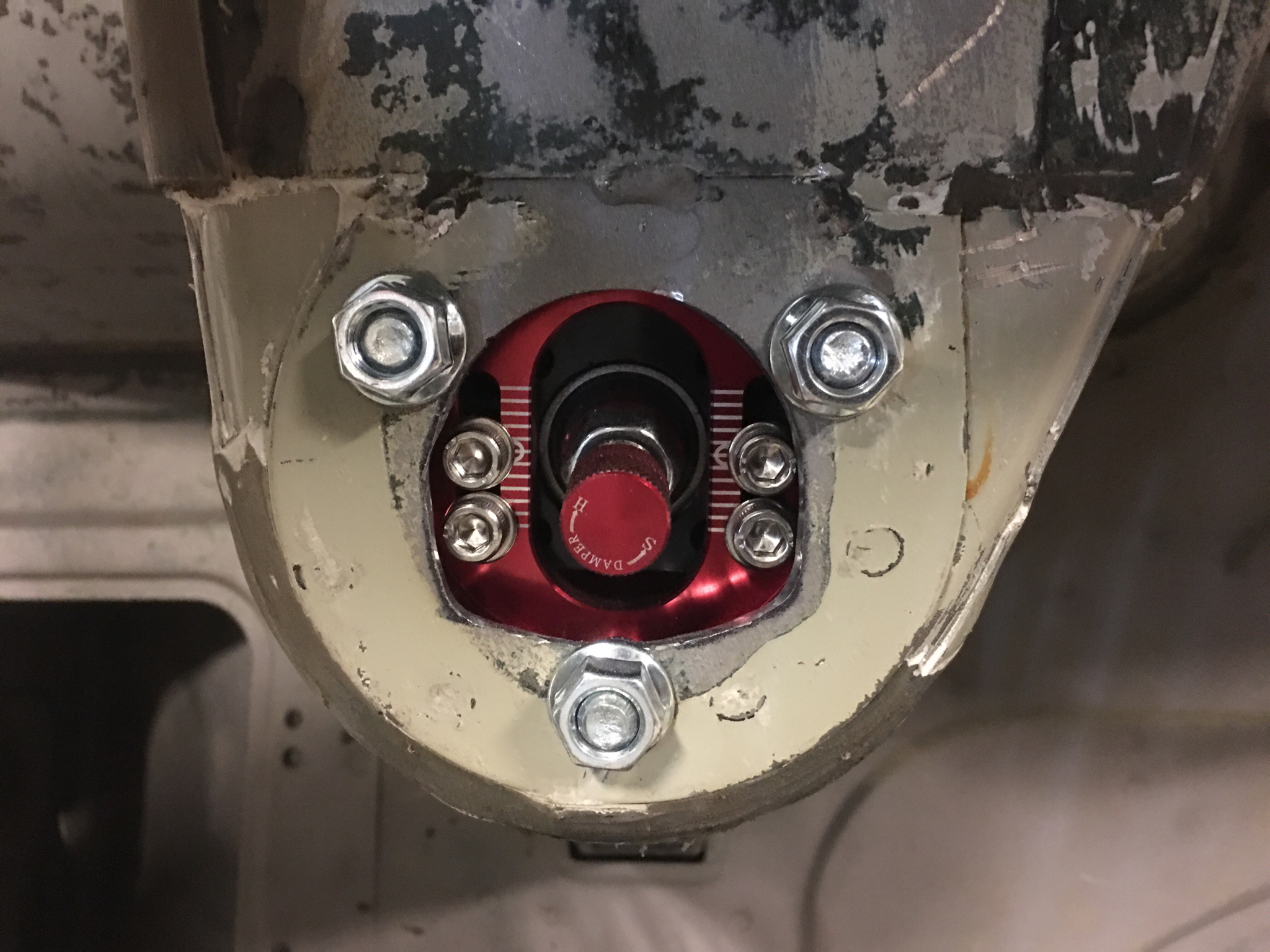

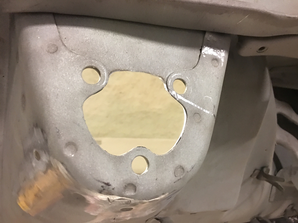

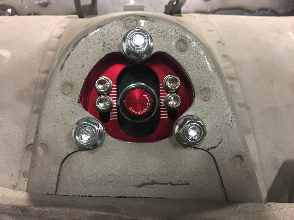

March 6, 20178 yr Author comment_514556 Completed all four corners tonight. The rear towers are a little different but still totally functional now. Fronts: Â Open rear hole: Â With coil over installed. Â Link to comment https://www.classiczcars.com/forums/topic/50908-1976-280z-restoration-project/?&page=95#findComment-514556 Share on other sites More sharing options...
