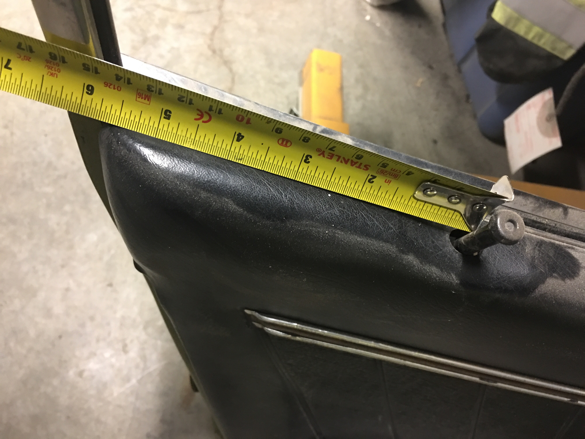

March 16, 20178 yr Author comment_515510 Check the measurement between door edge and door lockApprox 5 1/2" Link to comment https://www.classiczcars.com/forums/topic/50908-1976-280z-restoration-project/?&page=97#findComment-515510 Share on other sites More sharing options...
March 16, 20178 yr comment_515517 Sorry.. Mark. Mine is (And this is europe..) 22.5 Cm. Yours is 14,5 Cm. Between edge and lock. For the cards, back is in very good condition, as the front is.. only the chrome is peeling a bit... these cards can bring a 100 euro per card. complete. Some dents are on it were the handles come.. not damaged. Link to comment https://www.classiczcars.com/forums/topic/50908-1976-280z-restoration-project/?&page=97#findComment-515517 Share on other sites More sharing options...
March 16, 20178 yr Author comment_515525 Ok I kind of figured they would be the same door cards as North American 280's made after 8/76. They would just use the same door parts as the rest of the assembly line. Your doors probably didn't have the heavy reinforcement bars though. Thanks anyways! I'll keep looking... Link to comment https://www.classiczcars.com/forums/topic/50908-1976-280z-restoration-project/?&page=97#findComment-515525 Share on other sites More sharing options...
