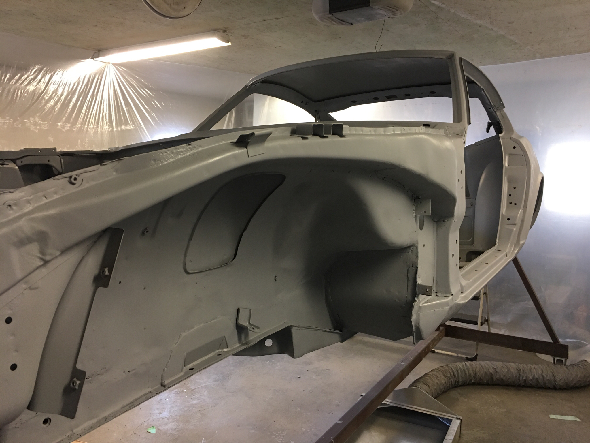

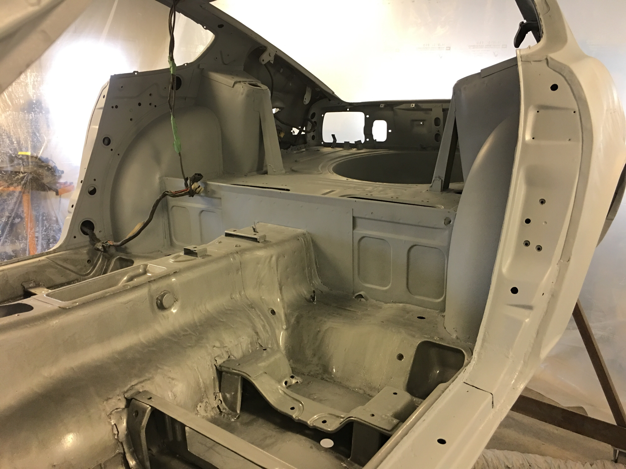

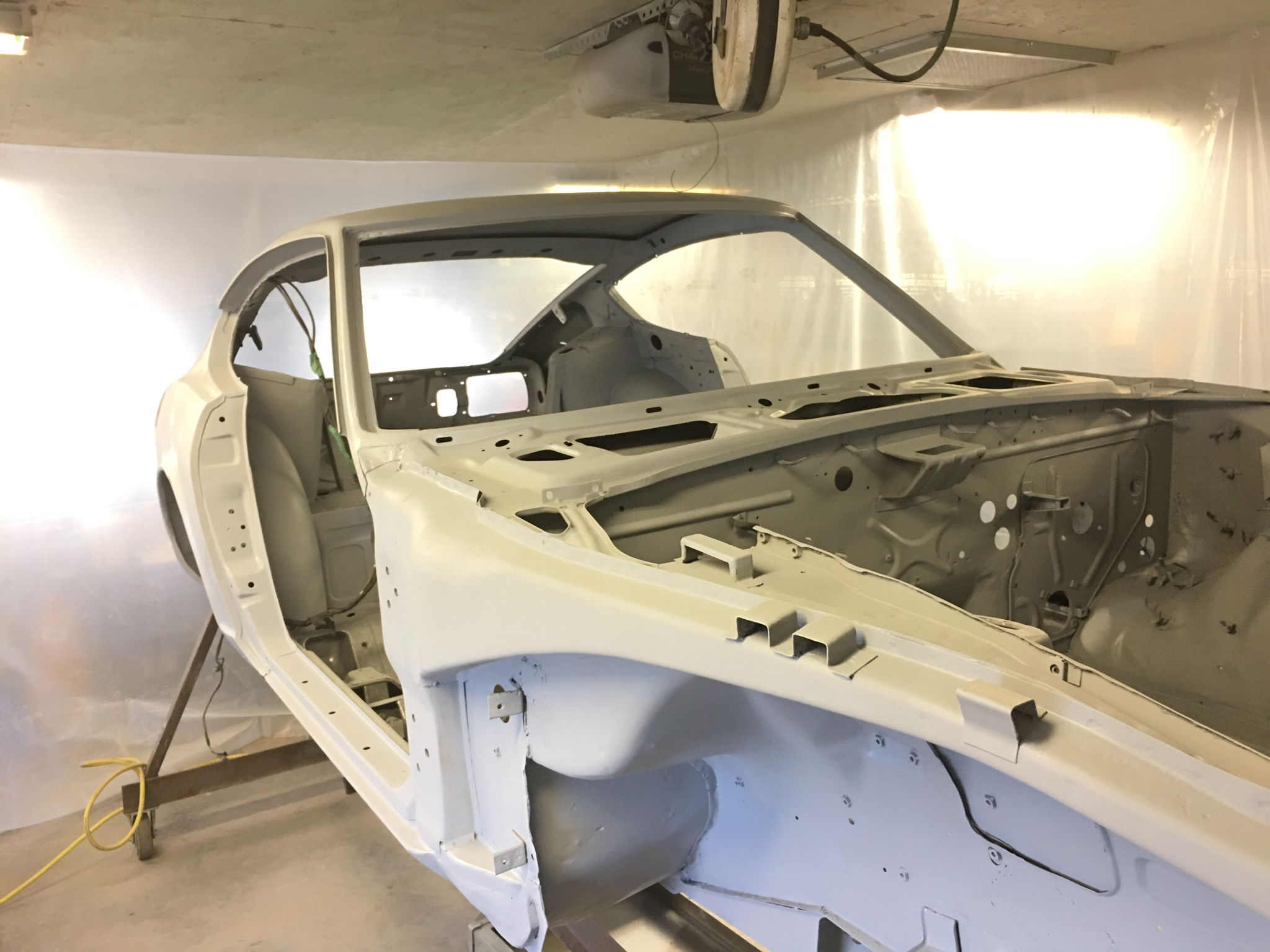

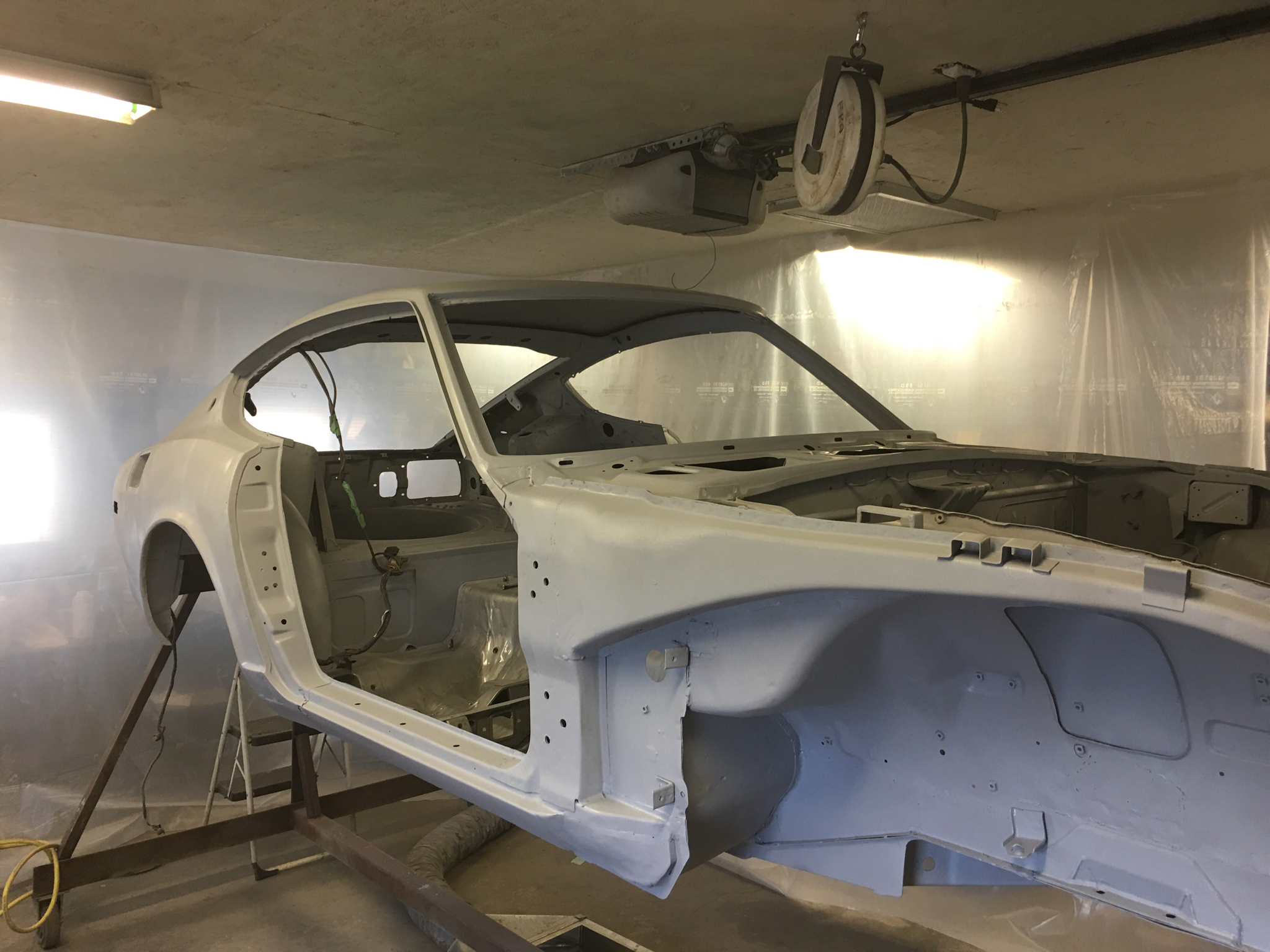

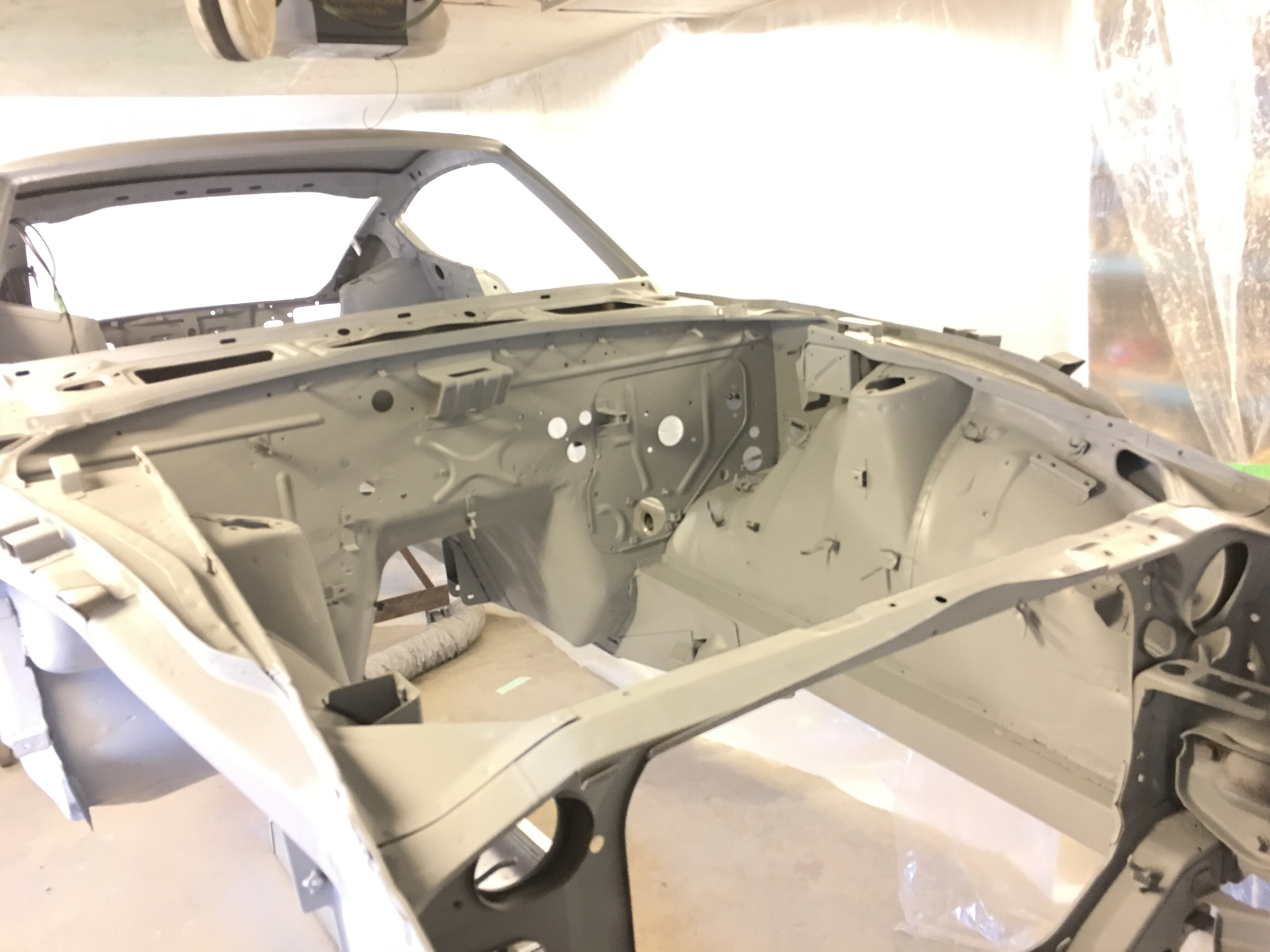

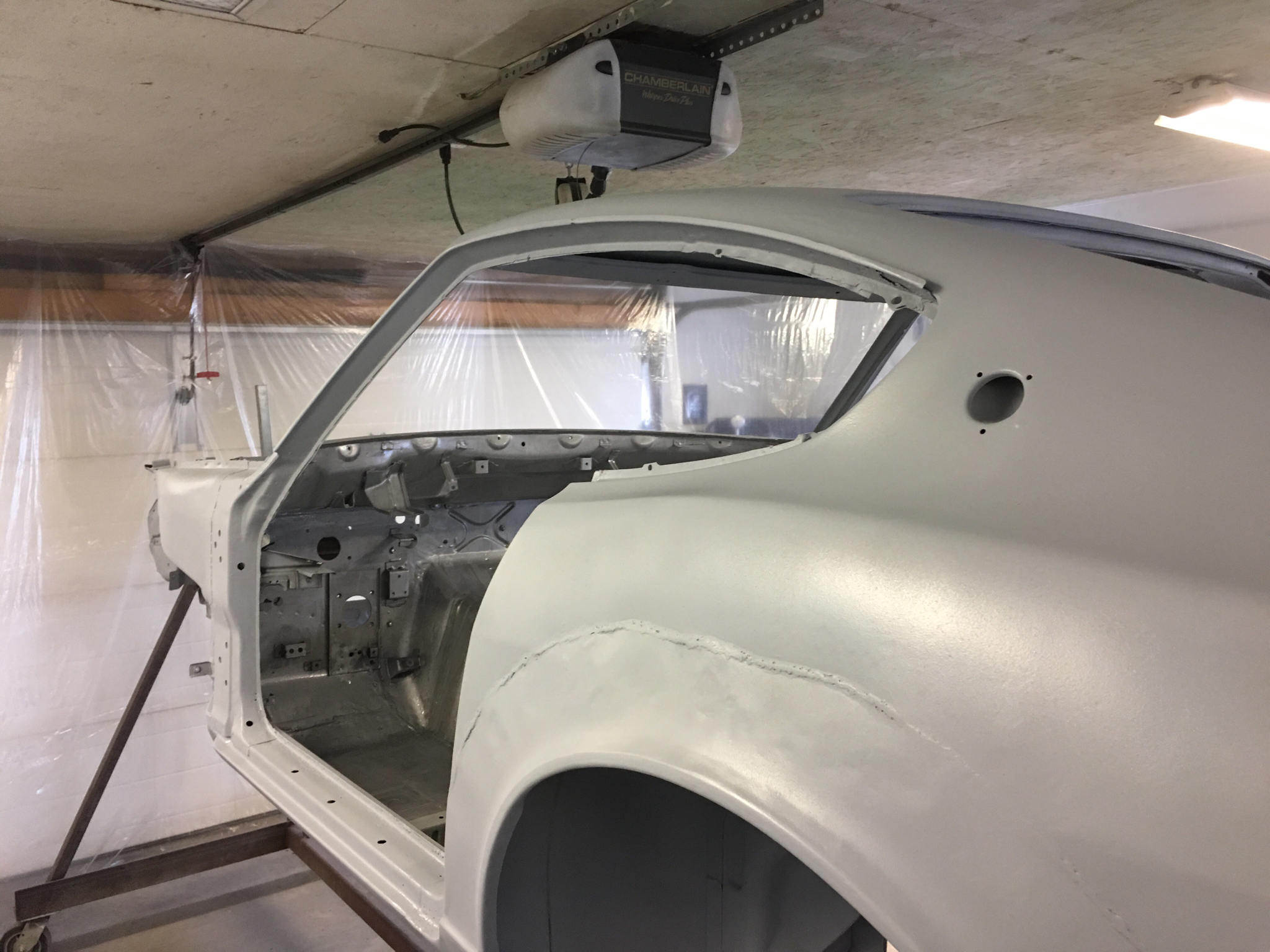

March 29, 20178 yr Author comment_516657 MMMMMMM….. the fresh scent of paint (even though it's primer). Gettin' Closer!I took off the full face respirator and there was very little 'air' left in the shop! All fumes! Luckily I have a good ventilation system. Left the side door open an hour...! Link to comment https://www.classiczcars.com/forums/topic/50908-1976-280z-restoration-project/?&page=99#findComment-516657 Share on other sites More sharing options...
