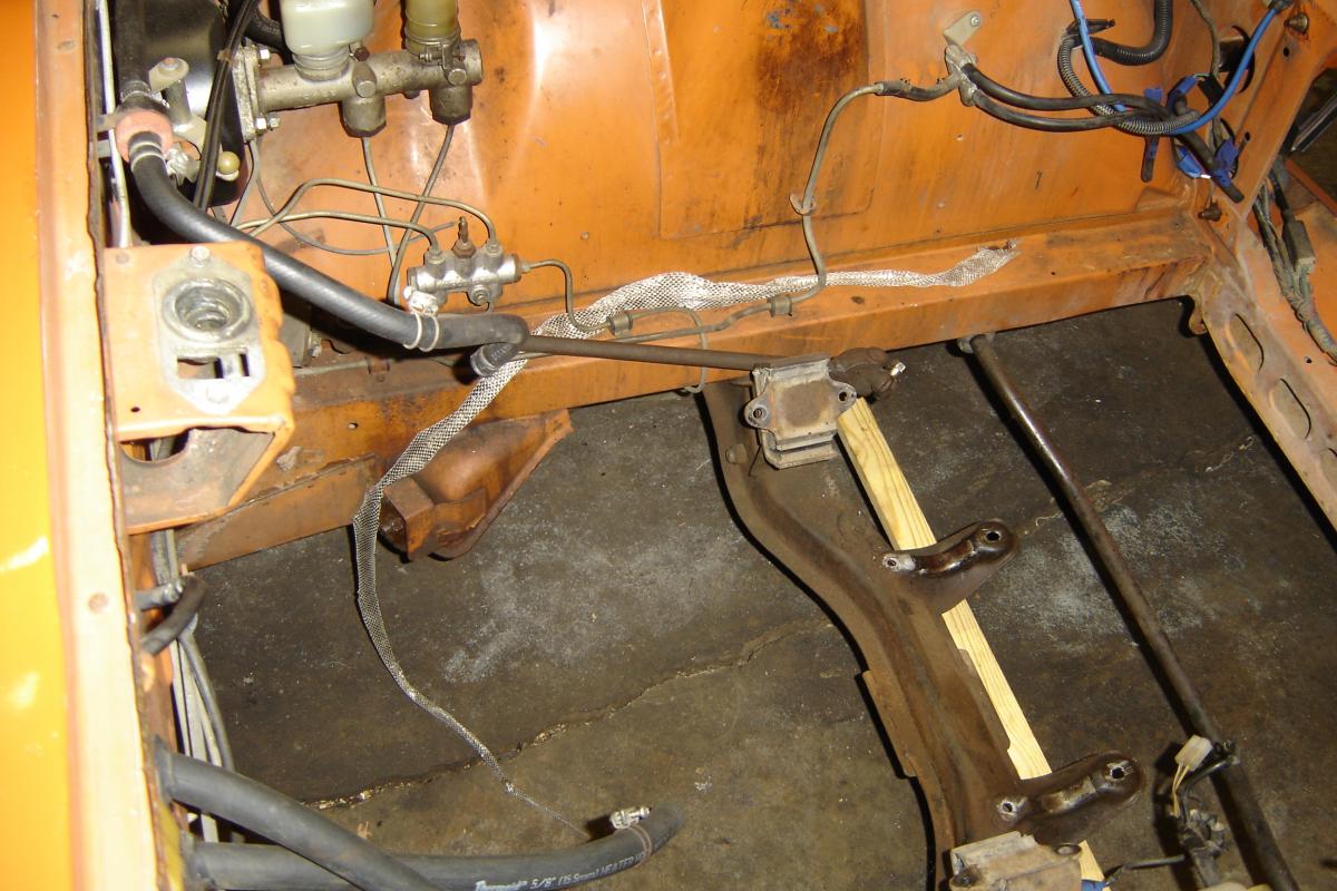

Now I know why there's no acorns in my air filter housings anymore.  I think I have a new pet, hopefully it's just a black snake.  The head is small and the tip of the tail is long and pointed so I'm pretty sure it's non poisonous.
I've had the cover on for so long there's no telling when it slithered out, I just pulled it back yesterday and saw the skin.  When I first bought this car I turned the blower on and pieces of a skin blew out.  So I'm thinking they like to get into there.  I'm making a lot of noise so he'll leave if he is inside.
