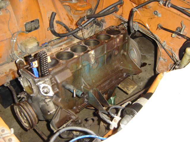

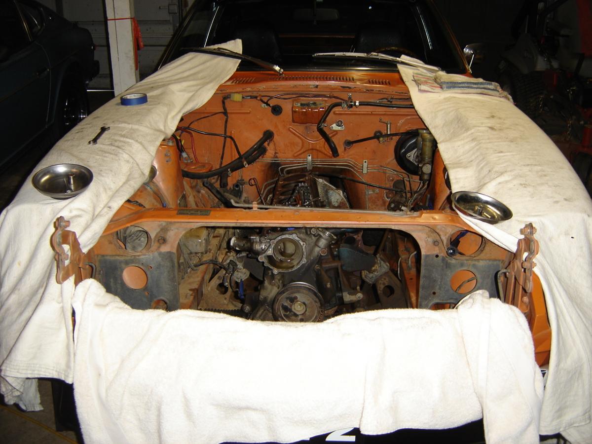

February 12, 201510 yr Author comment_463408 Boy this is a lot easier than before, I'm learning something I guess. It'd be hard not to when I check in with you all everyday. The head has been off before for sure, I guess for the steel valve seats? and a newer style spray bar. It has big phillips head screws in the bottom holes so I guess it's a multi car type. It looks good too. The head gasket has overly large fire rings so I guess it's for a 86mm bore, it has a copper coating on both sides too. The only 2 bolts I broke were the 2 holding the exhaust manifold to the exhaust pipe. I drained the radiator and only got a little over a gallon last Sunday. Today I removed that plug at the back of the block and got a GUSHER of coolant, at least a gallon maybe more, I'll have a catch pan next time. Cylinder walls are as slick as glass, so standard size rings will work fine hopefully. 280Z, 1st rebuild worried me sick and took 6 months. This 240Z will be done in a third of that time and done right, blue block not bar-b-q grill black paint. All the topside is done, tomorrow will be the exhaust pipe then the transmission. Saturday the blocks coming out and apart. Then clean, clean and some more cleaning. Link to comment https://www.classiczcars.com/forums/topic/50909-72-240z-rebuild/?&page=2#findComment-463408 Share on other sites More sharing options...

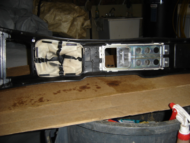

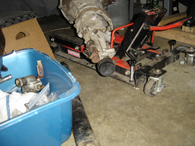

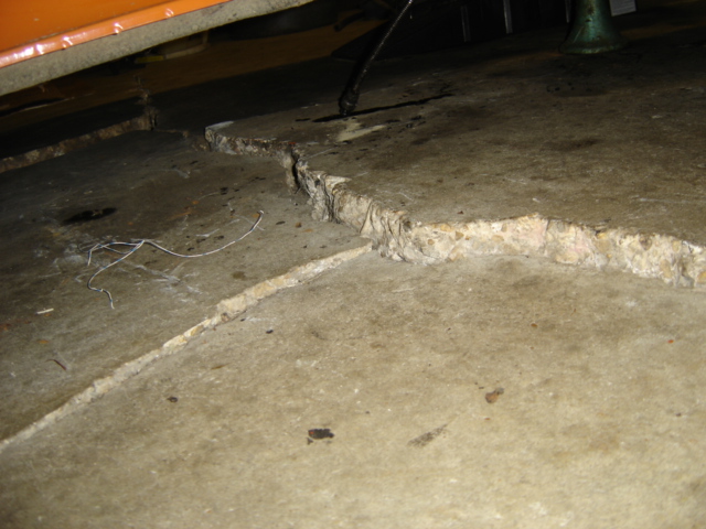

February 15, 201510 yr Author comment_463619 I'm on schedule but will be as sore as ever. I decided to drop the transmission onto a motorcycle jack I've used before for holding it to roll around while I pressure washed it. BAD idea for my 50 plus years old cracked up to hell garage floor. Getting my Dad's cherry picker tomorrow to pull the block out. I can't believe I wouldn't wait and get them both together. Stupid mistake I'll never repeat. This time I'm making a pile throughout the day then going back and bagging and boxing up everything in the evenings. Seems to be a lot less worrisome. RossiZ I have my console out so if I can take some measurements or pictures just let me know. Link to comment https://www.classiczcars.com/forums/topic/50909-72-240z-rebuild/?&page=2#findComment-463619 Share on other sites More sharing options...
February 15, 201510 yr comment_463621 Love the idea of the rubber pipe cap over the transmission output. Do you know what size it is? Link to comment https://www.classiczcars.com/forums/topic/50909-72-240z-rebuild/?&page=2#findComment-463621 Share on other sites More sharing options...
February 15, 201510 yr Author comment_463622 On 2/15/2015 at 1:25 AM, djwarner said: Love the idea of the rubber pipe cap over the transmission output. Do you know what size it is?It's a 2" or something, I'll make sure in the morning and post the size. That works way better than a baggie and tape. Even Carl Beck noticed that a few years ago when I rebuilt my 1st Z. He told someone that was hauling their car on a U-Haul type that holds the front tires only to remove the drive shaft and use that cap on the transmission for a long trip. In the morning, I promise, I'm not about to go back down there now that I'm clean. It was a couple of dollars at Lowes. Link to comment https://www.classiczcars.com/forums/topic/50909-72-240z-rebuild/?&page=2#findComment-463622 Share on other sites More sharing options...
