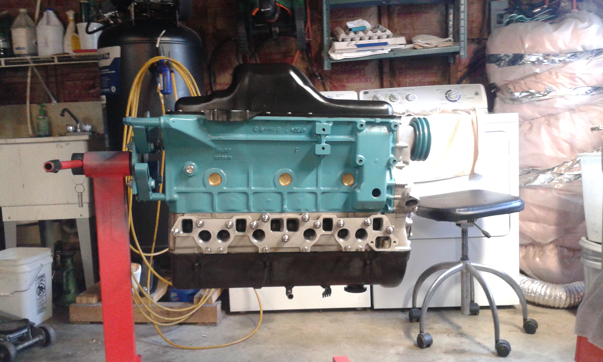

February 27, 20169 yr Author comment_487333 Finally! After much prep work and some other outside my control deals I got the oil pan back on, RIGHT! this time. Golf tees helped hold the gasket in place while I brushed a thin layer of aviation gasket sealer on. Used the flat rails off a ZX motor I had to secure the rear of the pan. So happy I re-did this, it gave a chance to paint the pan blacl like I should've done to begin with. I'll re-tighten the bolts over the next few days. Thanks eveybody for your suggestions! Cliff Link to comment https://www.classiczcars.com/forums/topic/50909-72-240z-rebuild/?&page=20#findComment-487333 Share on other sites More sharing options...
March 11, 20168 yr Author comment_488283 Finally, no leaks! Now I can stress on the carbs. If someone could answer a couple of questions, I'll sleep like a baby tonight. 1st is my timing chain. Super tight but the whole motor seems tight as well so I guess I'm just overthinking? 2nd is the motor is really tight! It turns smoothly by hand using an 8" socket wrench with the 27mm socket, overthinking again? Spark plugs are out. All new parts, timing kit, bearings and chrome faced moly rings. Honestly I just don't remember the 2.8 I built being this tight. But I keep telling myself, before I bought a remote starter, the motors were pretty tough to move when I adjusted the valves. I remember using a 36" piece of pipe on the crank bolt as a cheater bar and so I could turn it from the top side. Thanks for any confidence building advice or just put it in and crank it, it'll loosen up. Cliff Link to comment https://www.classiczcars.com/forums/topic/50909-72-240z-rebuild/?&page=20#findComment-488283 Share on other sites More sharing options...
