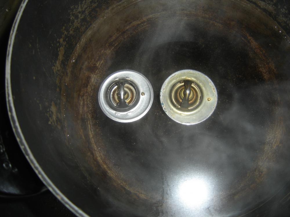

Never in my life have I actually tested a thermostat, how can something that simple not work?  Well, well, well they do go bad. :o
