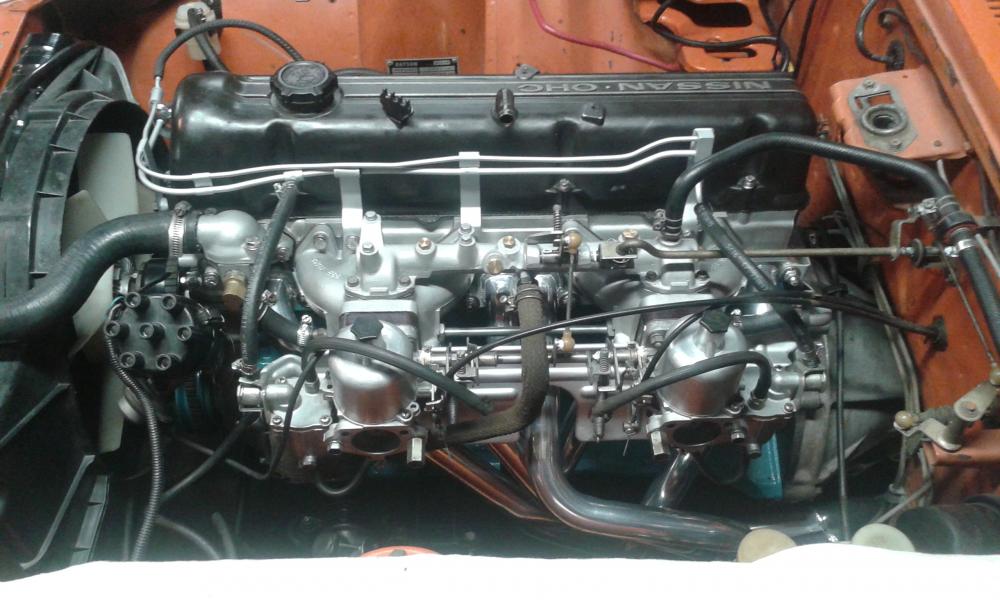

I marked the mark location.  It looks fully retarded I think.  Rotation is counterclockwise and when you turn the dizzy, you're moving the pickup.  So yours shows the pickup moved away from the reluctor as it rotates, which would be delayed or retarded.

My new remanufactured distributor is in need of adjustment according to Blue's rebuild.  I don't have equal spacing between the reluctor and stator.  Thanks @Blue
Mine looks like this,

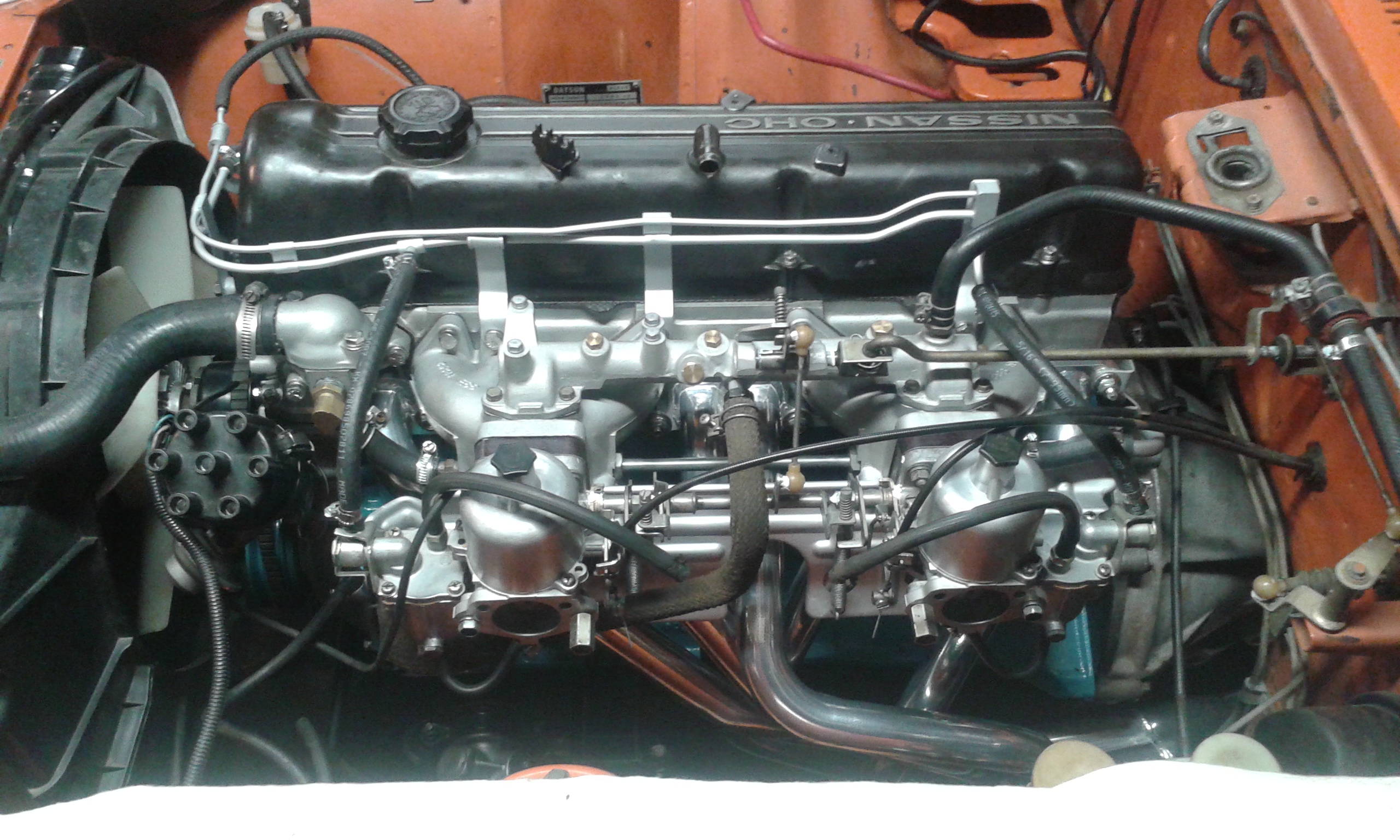

And it should look like this,
