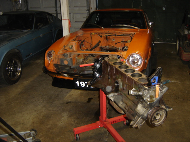

Nice pictures.  I can see the factory hone marks in the cylinders but also the classic rust line of an engine that's been sitting (my old one has that).
I see that you have a chain tensioner block installed.  Like you haven't decided yet how far to tear it down.

I'm getting practice on removing heads the right way.
It's going to be completely torn out and down maybe today.  Thanks for the info on that rusty color on the walls, I did not know that was the reason.  It sat for 6 years.  :(

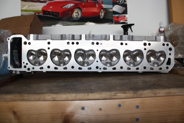

Now that the cam sprocket is off, TDC lines up with the right mark on the pulley and the oil pump spindle is at 11:25.  The sprocket was off a link or so after all.  I scratched around the valves seats and they look brass so I'm assuming they're bronze.  It had a Nissan clutch that was worn down pretty bad too.  I can't decide if this motor's been worked on or not.  The head gasket was covered with copper looking paint, what does that mean?

Getting my Dad's cherry picker tomorrow to pull the block out. I can't believe I wouldn't wait and get them both together. Stupid mistake I'll never repeat.
No problem Cliff.......just put a section of chain on your hoist.......put a head bolt and washer through the chain on number 1 driver side and number 6 passenger side. The chain will rise up to the washers and stop......lift her out.
Would Nissan have used a similar product at assembly?  The sprocket being out of time with the crank gear has me thinking it's been off before (the head) but they didn't update the valve seats and it was set to #1 hole so I'm not sure.
That's what I did. :)   I used the hood latch housing to hold the rear of the motor up until the hoist was holding the weight of the block.
