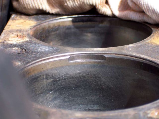

February 18, 201510 yr comment_463853 I was suprised the sanding drums cut the block myself. It's a slow process and you will burn up a lot of drums, but slow is better. Or you could start out with a steel carbide and finish out with the sanding drum.A plan is good Link to comment https://www.classiczcars.com/forums/topic/50909-72-240z-rebuild/?&page=5#findComment-463853 Share on other sites More sharing options...

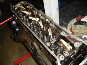

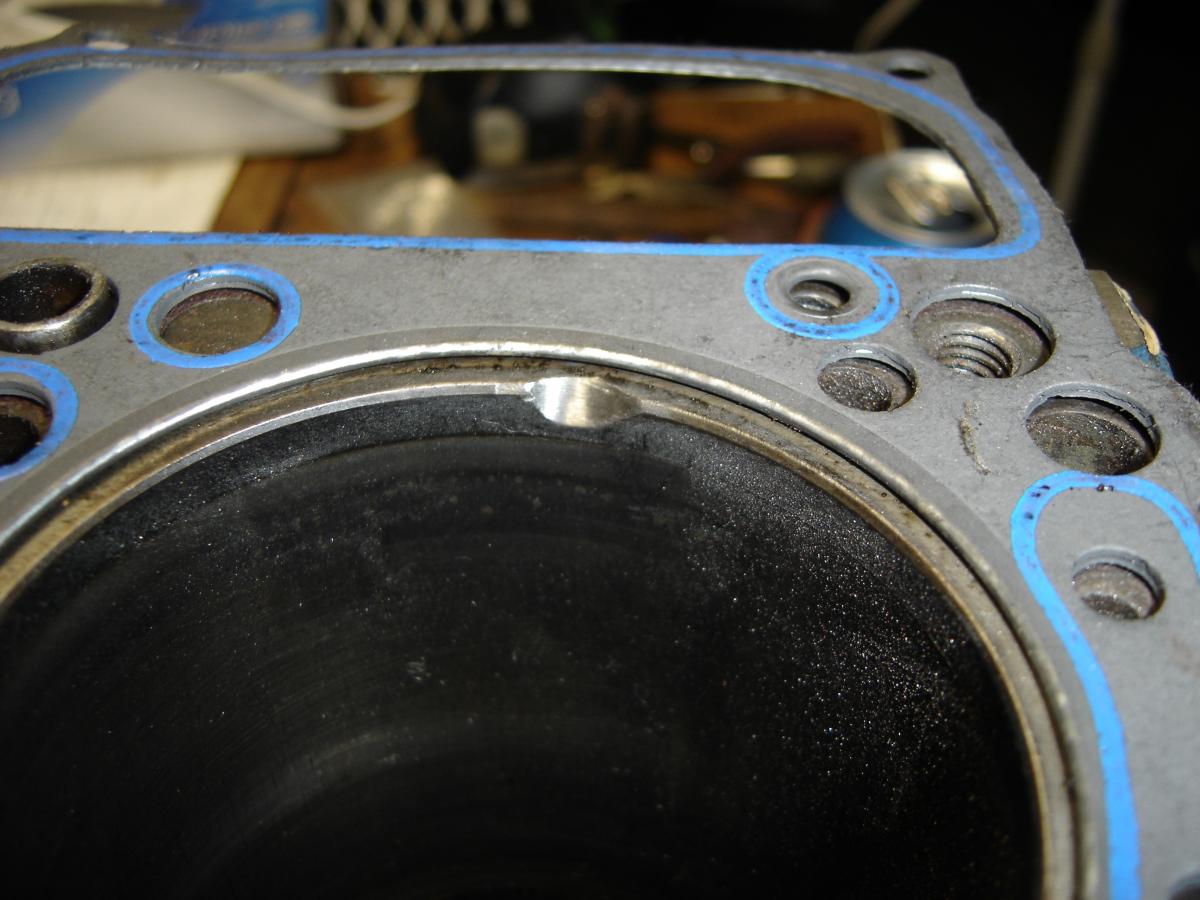

February 19, 201510 yr Author comment_463878 Well I have an idea of what to do. I took a bare N47 and put the exhaust valves in held up by clothes pins then chucked them to a drill and spun some marks on there. Then I used a pink grinding stone that came with my Dremel. One or two I'm not happy with but I'll get more practice tomorrow. Link to comment https://www.classiczcars.com/forums/topic/50909-72-240z-rebuild/?&page=5#findComment-463878 Share on other sites More sharing options...
February 19, 201510 yr comment_463900 are you notching for clearance due to high-lift cam, or just to de-shroud for flow? Link to comment https://www.classiczcars.com/forums/topic/50909-72-240z-rebuild/?&page=5#findComment-463900 Share on other sites More sharing options...
February 19, 201510 yr Author comment_463904 are you notching for clearance due to high-lift cam, or just to de-shroud for flow? I've got an E31 with exhaust valves for a N head, which are larger and just barely hit the edge of the bore. From zhome.com E31 HEAD '70-71 240Z This head has a 9:1 compression ratio. The quench area is the best of the Z heads with the exception of the P79. As stated before 280 valves are an easy installation and recommended. A note of caution here , however, if the 280 valves are used with a stock 240 or 260 bore ( they're the same) you will need to notch the block for the intakes. They JUST touch and make a hell of a noise ( take my word on this I know). If an oversize bore is used here then clearance is not a factor ( even a .010" overbore will do). This is considered by many to be the "best" head because of the "better" quench area and higher compression. I can't decide which to do here. Please advise me somebody (named Steve). Link to comment https://www.classiczcars.com/forums/topic/50909-72-240z-rebuild/?&page=5#findComment-463904 Share on other sites More sharing options...
February 19, 201510 yr Author comment_463905 Nissan has the turbo head bolts for less money, $60 for mine locally. PNsNine of the shorter ones 11056-P7600Five of the long ones 11059-P7600 Link to comment https://www.classiczcars.com/forums/topic/50909-72-240z-rebuild/?&page=5#findComment-463905 Share on other sites More sharing options...
February 19, 201510 yr Author comment_463908 Holy guacamole! I've been focusing on the exhaust valves but it's actually the intakes that will hit. Thank goodness I did that to a spare block. I'll get the intakes out and see where they hit. I almost stepped in a big ole pile of doo doo. Link to comment https://www.classiczcars.com/forums/topic/50909-72-240z-rebuild/?&page=5#findComment-463908 Share on other sites More sharing options...
