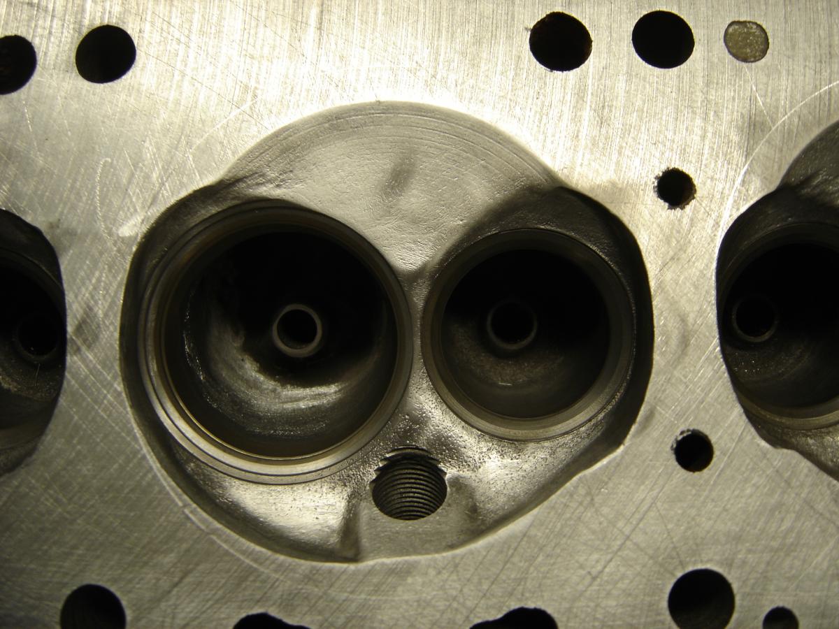

siteunseen Posted March 7, 2015 Author Share #73 Posted March 7, 2015 I figured that would be the answer to my question, thank you both. So that means the head has had the bigger valves for awhile. The intake seats do have a little magnetic pull though but nothing like the exhaust side. I guess beryllium bronze has enough tin in it to attract the magnet. Oh well, at least the steel seats are cheap but my machinist is gonna get sick of me quick. I've been smoothing all the sharp edges in the combustion chambers and I tried my hand at unshrouding the valves. Am I trashing an E31? I sure hope not. Link to comment Share on other sites More sharing options...
madkaw Posted March 7, 2015 Share #74 Posted March 7, 2015 (edited) I assume you are using the Hg as a guide-though I see no guide lines marked on the head. Don't get under the fire ring of the HG, just the edge. Don't forget to do those nasty spark plug threads in the chamber. Smooth out any threads no being used. Edited March 7, 2015 by madkaw Link to comment Share on other sites More sharing options...
siteunseen Posted March 7, 2015 Author Share #75 Posted March 7, 2015 I used a scribe to scratch the outline of the HG. You can see it, barely. Do you think soda blasting the bare head would be okay? I'd like to clean the outside, not getting near the combustion chambers. Thanks Steve. Link to comment Share on other sites More sharing options...
madkaw Posted March 7, 2015 Share #76 Posted March 7, 2015 I see the scribe mark now. Don't know about soda blasting but I couldn't imagine it hurting anything top or bottom.What month/ year is that head? Looks like the casting is not quite as good as mine. Mine is 9/71 Link to comment Share on other sites More sharing options...
siteunseen Posted March 7, 2015 Author Share #77 Posted March 7, 2015 I haven't seen anything that looks like a date code. It's an E31 that came with the tomato colored 240. Triple webers aluminum flywheel f54 bored thirty over with new dished itm pitons. He was following datsungarge.com to the letter. Needed money so now it's mine. Had to do something with it. Link to comment Share on other sites More sharing options...

madkaw Posted March 7, 2015 Share #82 Posted March 7, 2015 How much or are you going to shave the head? CR you are going for? Link to comment Share on other sites More sharing options...
siteunseen Posted March 8, 2015 Author Share #83 Posted March 8, 2015 I'm not planning on cutting any off the bottom unless it's not straight. I am being careful not to cut much, just trying to blend everything together. Am I making a big mess? I got the P79 down for comparison and ended up spending the day cleaning up my garage. It was 60 degrees and sunny, I needed that. Link to comment Share on other sites More sharing options...
