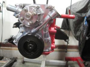

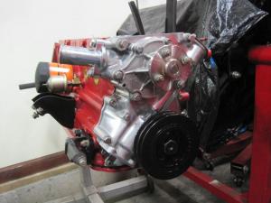

May 8, 20159 yr Author comment_469345 Well blue just don't cut it in a red engine compartment. Black is kind of dumb, especially when you start trying to find oil leaks. Red off the shelf actually matched really well to my car, so there it is. The side seals; Guy, appreciate the tip, but the rear main is already bolted down and I don't own a puller, so it's a pain to pull back out. I've read numerous posts regarding these damn things and I have read no rtv, yes rtv, cap in place, cap not in place. I don't own the how to rebuild book, but i'm ordering it tonight! I have time to sort this out because my head is on B.O. I guess.Blue; I had SS valves in there before and I guess the machinist ordered SI valves to replace my old ones. Link to comment https://www.classiczcars.com/forums/topic/50936-l24-rebuild-again/?&page=5#findComment-469345 Share on other sites More sharing options...
