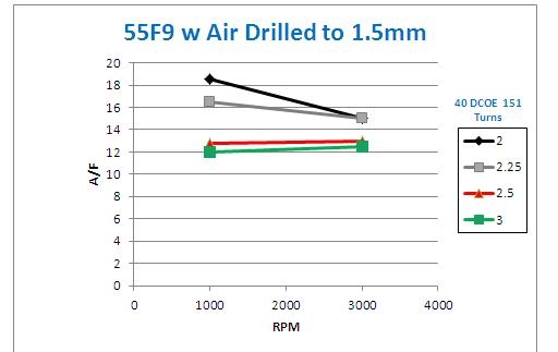

Here is a graph of how enrichment screw affects idle and cruise. post-7641-14150828787847.jpg
I can't raise the fuel float level any higher I'm afraid. The middle carb's float adjusting screw bottoms out at the current setting which is showing 29mm on the glass measuring level I have. I don't think I should force it either.
That's an awesome graph you have there though, I will have to play around with the mixture screws and see if it makes a difference to the driveability, even if it means sacrificing idle AFR mixtures.

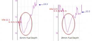

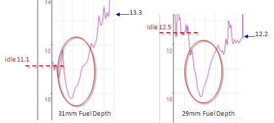

I had a closer look at the data. Here are some observations:
The time you are driving from 1000 to 3000 is only ~4 to 5 seconds. It looks like the accelerator pump is coming in and driving the A/F ratio towards 10. (This same "V" shaped dip signature [circled] is evident in all plots after all gear changes...It seems to last ~2 seconds). To remove this extra circuit when collecting data, try idling for 5sec then driving for 5sec at 1000, 5 sec at 1500, 5 seconds at 2000, 5 seconds at 2500, then 5 seconds at 3000 (you will need a nice straight). So no big pushes on the accelerator and slow smooth acceleration. You can also replace the spill jets with bolts to eliminate the acceleration circuit altogether. This will make the data less cloudy and help focus on the right idle jet and fuel level. FYI The 2 second blast low A/F ratio after a shift may be causing your transition bog problem (i.e. a false lean) so it is good to note. The extra fuel squirting on the intake wall (thx to Bryan Little!) from the accelerator pump may cause intake popping if it ignites.
Going from 31mm to 29mm seemed go give you a point lower of A/F ratio at cruise (from 13.3 to 12.2). However the idle seems to be richer at 31mm (11.1 vs 12.5)? Were the idle enrichment screws the same for both of these runs or was the throttle pumped at idle? This is a bit confusing?
With respect to your timing, keep it at 15 degrees at idle while tuning. triples like lots of initial advance at idle.
Your Emulsion tube and main jet will also affect cruise but focus on the tuning with these tubes removed first as you are doing. Also try to disable the accelerator circuit by replacing the spill jets with bolts at the bottom of each fuel bowl.
Bottom line:
It looks like 31mm fuel level and the 57.5 idle jet can give you a nice fuel average distribution ~ 13.5. Just get rid of the rich-dip to evaluate better.
If you want to tune to 12.5 A/F, the 29mm fuel level and 57.5 idle jet will be the ticket.

Once again, awesome feedback Blue. Much appreciated.
Removing the pump jets is one thing I really need to do to eliminate the possibility of it richening my mixtures, I will have to source a bolt that fits.
And going from 31-29mm float levels, I kept all mixture screws and settings the same. It is honestly quite hard to tell idle AFRs though, bounces around quite a bit. I have been getting average figures for them.
