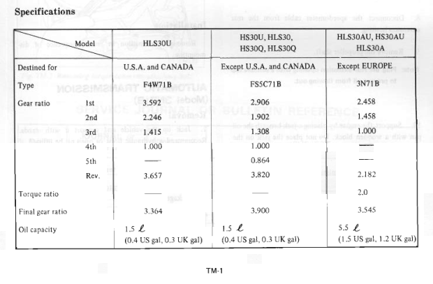

February 26, 201510 yr comment_464400 Actually, I was kind of lazy in my response. The ratios are listed for the 5 speed in the FSM. 5th is not direct. The "mysterious" 5 speed I was referring to is commonly called the direct-drive 5 speed dogleg "comp" box. Comp for competition. I think it was an option from Nissan at some time. Anyway, even if there was a list of codes for the transmissions, with the interchangeable parts you'd still have to do some calculations or open it up to know what you had. From the 1972 FSM. Note that the ratios do seem backward, compared to the ratios of the transmissions. The 5 speed needs the 3.9, and the 4 speed, the 3.36. Edited February 26, 201510 yr by Zed Head Link to comment https://www.classiczcars.com/forums/topic/51006-identifying-5-speeds1/?&page=2#findComment-464400 Share on other sites More sharing options...

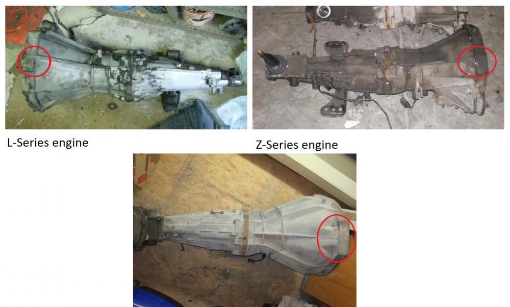

February 23, 20169 yr comment_487051 14 hours ago, Matthew Abate said: I have another thread going in the parts swap section about the 83/84 200sx FS5w71b. Anyone know how much it needs modifying and how hard it is to do to get it to fit a 240z/280z? Can't seem to find anyone who's done it. /M The 83 had the Z series engines. The bell housing will bolt up to the L-engine, but the tranny will lean to the passenger side. The easiest way to identify which bell housing it is: Look at the ridge going up the centre of the bell housing. Looking from the transmission towards the engine. If the ridge is close to the right bolt hole its a Z-series bell housing. If the ridge is close to the left bolt hole its a L-series bell housing. In the middle between the top two bolt holes its a VG-series V6 bell housing. Both the Z and VG bell housings will need to be changed. It seems like a lot of trouble just to get a FS5W71B transmission in a Zed. Something that is a fairly common feature in the 280Z. You won't need to modify the bell housing like the 71C, but still I think I would look for a 280Z or ZX. If you don't wont a close ratio gearbox (in front of the 3.36 diff) go for the 280Z or a 280ZX 2+2. The wide ratio Zed tranny is similar to the 200SX. Thats probably why you haven't seen it done yet. Link to comment https://www.classiczcars.com/forums/topic/51006-identifying-5-speeds1/?&page=2#findComment-487051 Share on other sites More sharing options...

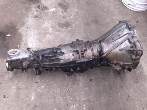

February 23, 20169 yr comment_487057 I think that he meant NAPS-Z. Maybe. The tell on the bellhousing is the position of the starter mounting area relative to the bolt holes and flat top section. It will look higher on the VG30 and the other engines. Can't you post a picture? Use the Snipping Tool in Windows. Link to comment https://www.classiczcars.com/forums/topic/51006-identifying-5-speeds1/?&page=2#findComment-487057 Share on other sites More sharing options...
February 23, 20169 yr comment_487059 Stamp on the housing says TA71B #1. Edited February 23, 20169 yr by Matthew Abate Link to comment https://www.classiczcars.com/forums/topic/51006-identifying-5-speeds1/?&page=2#findComment-487059 Share on other sites More sharing options...
February 23, 20169 yr comment_487061 Posting a picture from the 1986 200SX FSM. Maybe the FSM is wrong. But if it's wrong there, gear ratios might be wrong also. I still don't know what the C and the B signify. Maybe just the change in countershaft bearing size. Nissan used the 71C designation all the way up to 1994 in the 240SX, maybe beyond. I did find something in the MT chapter. Two transmissions. Could be they left out the CA18ET variations. Looks like a good puzzle. You could have the guy check the 1st gear ratio. 3.592 is over 3 1/2 turns, 3.321 is less. Edited February 23, 20169 yr by Zed Head Link to comment https://www.classiczcars.com/forums/topic/51006-identifying-5-speeds1/?&page=2#findComment-487061 Share on other sites More sharing options...
