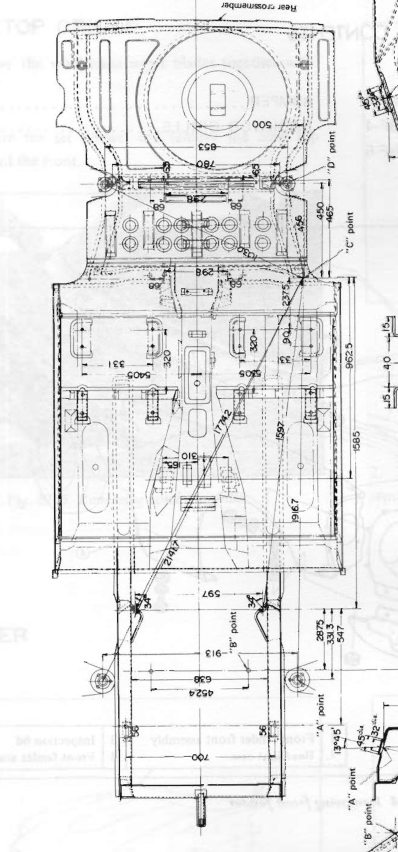

March 25, 20169 yr comment_490383 I'd actually looked through the Hybridz thread before but how they fit didn't really sink in (or I forgot). Didn't really think of the rear transverse-oriented sub frame (where the BD rails terminate and weld on) as the rear sub frame. I've been looking at the arched piece that goes over the axles, thinking in terms of a lengthwise frame rail, trying to connect two parallel rails in my head. The rails should probably actually be called bracing, or stiffening ribs, or boxed sections, or boxed bracing. The metalwork in front, where the engine bolts in, would be a sub-frame. I think. The 240Z rear "rail" might better be called a rail (brace) extension. History prevails though. Found another good BD rails thread, describing how to make them fit and weld them in. http://forums.hybridz.org/topic/58497-installing-bad-dog-frame-rails/ I'm almost disappointed that I have a 280Z, with decent shape rails/boxed braces. No good reason to modify yet. Nissan shows where all of the sub-framework is in their Body chapter, as dotted lines. Here's 1972. Link to comment https://www.classiczcars.com/forums/topic/51020-shock-tower-brace/?&page=4#findComment-490383 Share on other sites More sharing options...
