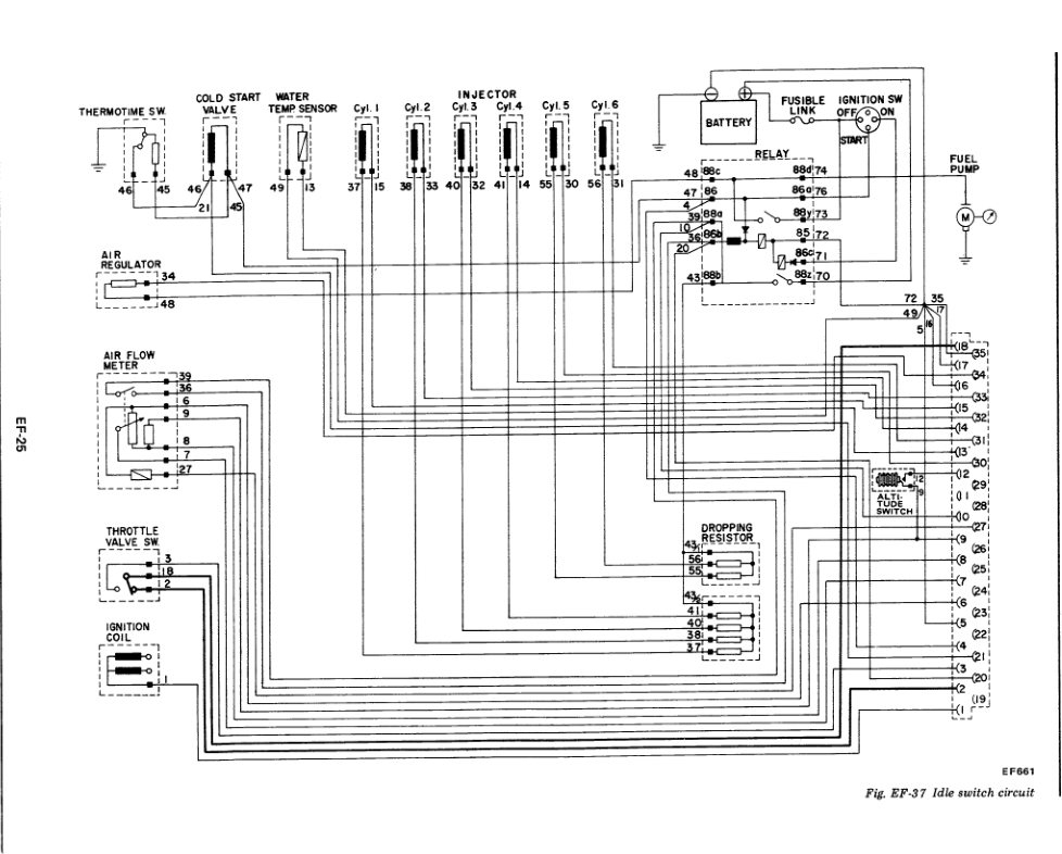

March 11, 201510 yr comment_465348 The fuel pump control side of the FI relay does have a fusible link between it and the battery. It's the driver's side rear link of the four on the wheel well. If you've got 12V on both sides of that link while the problem is occurring, that's not the problem. So are you familiar with the numbers on the FI combo relay? Here's the pin numbers related to the fuel pump and AAR:- Pin 73 is power from the battery. Should be hot at all times.- Pin 76 is the control signal from the ignition switch. Should go hot only in the START position.- Pin 36 is the control signal from the AFM. Should be hot only when the AFM is passing air.- Pin 74 is power output to the fuel pump. Should be hot in START and when the AFM is passing air. The system works like this... Power comes from the battery through the driver's side rear fusible link to pin 73. When either control signal (pin 76 or pin 36) goes hot, the relay connects pin 73 to pin 74 which then goes to the fuel pump. So when either in START or when the AFM is passing air, pins 73 and 74 are connected together and that sends power to the fuel pump. So in your case, one or more of those four pins isn't working properly. Either because of a wiring or connection problem or a problem inside the relay itself. Link to comment https://www.classiczcars.com/forums/topic/51036-77-z-drives-for-about-10-to-15-minutesthen-dies/?&page=5#findComment-465348 Share on other sites More sharing options...

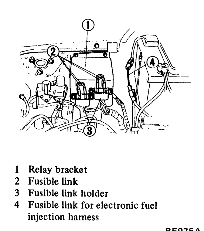

March 11, 201510 yr comment_465354 #4 and upper right should help. Link to comment https://www.classiczcars.com/forums/topic/51036-77-z-drives-for-about-10-to-15-minutesthen-dies/?&page=5#findComment-465354 Share on other sites More sharing options...
March 11, 201510 yr comment_465358 Zed Head, About the info you posted above... Yes, you are right that there are actually FIVE fusible links on the EFI cars with the fifth one coming directly off the positive terminal of the battery. That's the one you identified as #4 in the sketch. But... That fifth link (item number four) runs the injectors and a bunch of other stuff related to the FI system, but it doesn't power the fuel pump directly. It DOES supply power to the AFM switch, so it does provide the primary side control power for the AFM signal once the car has stopped cranking, but other than that it has nothing to do with the fuel pump. The fusible link that directly runs the fuel pump and the AAR is the driver's side rear link located in the fusible link blocks. Also note that the link that runs the fuel pump and the AAR is the one in the schematic you posted. Also interesting to note that the other FI link (item number four) that comes right off the battery is not shown at all on that schematic. Haha! Don't mine me... I'm just trying to make things more complicated by making them simpler! On edit - I fixed an overextended statement I made prior. Edited March 11, 201510 yr by Captain Obvious Link to comment https://www.classiczcars.com/forums/topic/51036-77-z-drives-for-about-10-to-15-minutesthen-dies/?&page=5#findComment-465358 Share on other sites More sharing options...
