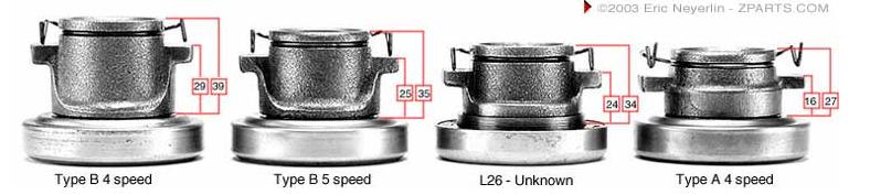

I couldn't find my sketch, but here is a photo of my clutch fork. The distance from the bellhousing to the front side of the fork (measured at the outer edge) should be around 110 to 115mm max. If its longer than that, you probably have (and Im now almost certain of it) a throwout bearing collar for the "early" 240Z (pre 07/1971) with the Type FS4W71A 4speed transmission and the new pressure plate for the later version Type FS4W71B transmission. If this is the case you should be measuring around 120mm or maybe a bit more than that.
Note: Those measurements are taken with the clutch at rest, clutch pedal NOT depressed.
An easy way to tell the transmissions apart is the Type A has a seperate bellhousing (3-piece transmission housing) and the Type B doesn't. The Type A also has the clutch fork with the return spring and adjustable slave cylinder pushrod.
Im afraid your only option will be to remover the transmission and find a new throwout bearing collar for the later pressure plate.

Well I went ahead and droped the trans, and shure as s@#t the pressure plate is indeed the culprit. Original measures 2 1/4" from flywheel to fingers, and the new one measures 1 3/4".

That kit shows that it came with the collar/carrier that should have matched the pressure plate.  Did you use an old collar or did the kit only come with a bearing?  The collar that came with the lit should have made everything work fine.  IT's the collar and pressure plate that have to match, nothing else, not year, or transmission.
http://www.oreillyauto.com/site/c/detail/PTQ5/KF53601/01351.oap?year=1971&make=Nissan&model=240Z&vi=5142639&ck=Search_clutch+set_5142639_-1&keyword=clutch+set
Someone else just had this same problem (drawing a blank on the name) and ordered the complete kit with collar from OReilly.
Measure from the surface of the flywheel to the surface of the collar that the fork rides on.  It should be ~92mm.
The original "size" pressure plates have not been made by aftermarket or nissan for years. They all refer to the later type. Only problem is they forget to mention you also need the bearing collar for the later version.
If you can't find one in a yard, you can get one through MSA.
