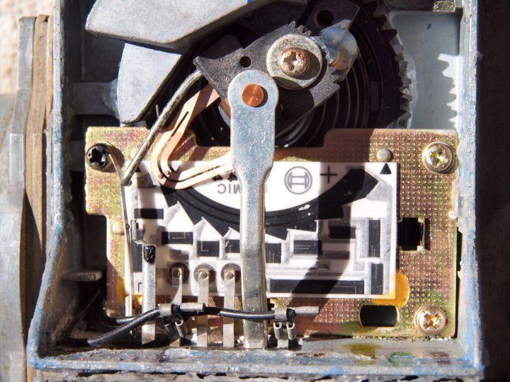

Blue, the zig-zags in the potentiometer tracings lead to a voltage ladder that insures the linearity of the scale, probably preventing drift as the tracings wear.
I have to say that I can't look at a potentiometer diagram and figure out what should happen.  But I do notice that the air temperature circuit seems to be in series with the AFM circuit.
I wonder if a broken air temperature sensor, either opening the AFM circuit, or shorted, removing the 2500 ohms of resistance, would cause everything to go rich?

Here is a pic of the wiper in my AFM, hope you see the tracks from the wiper arms and the worn off spots on the carbon trace. I gently cleaned the wiper arm contacts and very minutely bent them to make a little firmer contact with the trace.

I'm traveling so my resources are very spotty, but I can tell you that pin 6 Is a ground line. It's an analog ground for the sensor, so yes, those two parts ARE in series, but not in the usual sense.
Yes, if the temp sensor in the AFM has gone open circuit, you will run rich.
