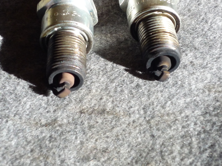

March 24, 201510 yr comment_466297 One plug looks much richer than the other. I wonder if something else is going on? Link to comment https://www.classiczcars.com/forums/topic/51130-im-about-done-with-the-ing-efi/?&page=6#findComment-466297 Share on other sites More sharing options...

March 24, 201510 yr Author comment_466303 Blue, just to make sure that I get the best out of the Z, I believe I'll order some new injectors, I'll have to scour the club because I know I've read about which ones were the best. The other option is to send the old injectors off to be be re-done per se, but that'll leave where I'm at with this until they come back, hmmm. The "richer" looking plug was from #3, I'll recheck all 6 in the AM to see if maybe the front 3 are different from the back or any other differences. I kinda thought the #4 plug looked better. Edited March 24, 201510 yr by mjr45 Link to comment https://www.classiczcars.com/forums/topic/51130-im-about-done-with-the-ing-efi/?&page=6#findComment-466303 Share on other sites More sharing options...
March 24, 201510 yr comment_466306 10 MPG ought to be easier to find than this... Those plugs don't look all black and sooty as I would have expected. At 10 MPG, I would have expected loose fluffy. Link to comment https://www.classiczcars.com/forums/topic/51130-im-about-done-with-the-ing-efi/?&page=6#findComment-466306 Share on other sites More sharing options...
March 24, 201510 yr Author comment_466311 Captain, they were a few days ago. I'm not sure what I did, but they do look better, I'll see what all the others look like tomorrow. Link to comment https://www.classiczcars.com/forums/topic/51130-im-about-done-with-the-ing-efi/?&page=6#findComment-466311 Share on other sites More sharing options...
