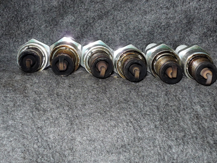

Also, I don't think you've mentioned your driving style on these bad mpg trips.  If you're climbing a lot of hills and goosing it often, you could easily burn some extra fuel.  It's a performance engine, designed to burn fuel if asked.  Your plugs don't look like 10 mpg plugs, as noted.  I took another look at your post 44 numbers and they look just like my old setup (except for the TPS NG) with stock injectors, that typically got 18-20 mpg.  That's mostly flat land, but with goosing.

Honestly, I agree with Captain.  The plugs are a bit dark, but not really all THAT bad.  Your fingering test confirms that the mix is a bit (and not a whole lot) rich, at least at idle.  Maybe that 9% reduction for altitude would do the trick for you.  That said, I've looked at the EF section of a '75 FSM now, and I don't see any evidence of an altitude switch feature for that year.  Therefore I wouldn't short those two pins together.  It's likely nothing would happen (unused pins), but it's still possible you could blow something out.

It will be interesting to see all 6 plug reads.

As I've said, the car runs well just has crappy MPG, I'm also thinking I'll replace the TPS because its NG @ WOT. I'm still on the fence about new injectors and maybe an adjustable FPR but I've read they are not all that great. Here are all 6 #1 on the right. #1 looks pretty good, #2 not as good, #3 a little worse, #4 worse about like #2, #5 bad, #6 a lot worse than the others. In person 4,5,6 look much worse, pic makes them look better.post-20235-0-70159800-1427208056_thumb.j

After looking at the pic of my plugs, it looks like there is no consistency to the burn on all 6, #1 looks the best almost right on, but the rest look worse in terms of burn with #6 being the worst, so maybe its faulty or wrong injectors, don't know.
