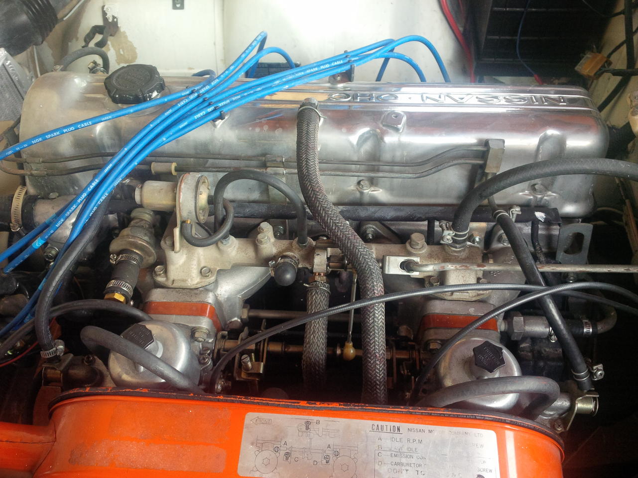

March 24, 20159 yr Author comment_466342 Ok! You guys are great giving me advice! Just to be sure i will only need to install a working Servo diaphgram to my car before installing the Sanden 508 compressor and Vintage Air Gen II Mini Evaporator: Please confirm if i will also need the Throttle opener valve shown in the first picture or this is not needed? Edited March 24, 20159 yr by jalexquijano Link to comment https://www.classiczcars.com/forums/topic/51152-trying-to-mantain-my-idle-in-1000-rpm-but-not-possible/?&page=2#findComment-466342 Share on other sites More sharing options...
March 24, 20159 yr comment_466354 I can't remember exactly what that large vacuum valve above the left side carb is... but you don't need it. ( Some sort of Emissions device ) I also used to own a couple of early 240Z's. Both 71's with early style SUs. My street car had a local regrind ( Shadbolt M445 ) that is similar in specs to the Shnieder 274. 10 to 1 CR, Ported and Polished head, Cannon 2.5" exhaust system. Revved to 7,000 RPM. Idled just fine at 1,000 rpm, with a pretty heavy " rumpita rumpita " though. Sweeeet. . Took some distributor tweaking though. No AC however.... For the AC throttle kicker you may be better off get an Idle " kicker " solenoid off of a mid 70's or early 80's GM carburated car. These are an electrically operated solenoid that extends and retracts to raise the throttle speed. They are designed for a 100% duty cycle and are very reliable. Cheap too. Much easier and cleaner to install than all of the Vacuum diaphragm junk. Since the factory AC system uses an electrically operated Vacuum valve ( Called an FICD ) to actuate the " Kicker " vacuum diaphragm, you can just take the electrical wire that actuates that FICD valve and run it direct to the GM electric solenoid. Fabricate your own bracket and you have eliminated the most troublesome and unsightly parts ( vacuum parts ) of the AC idle " kicker " circuit. Edited March 24, 20159 yr by Chickenman Link to comment https://www.classiczcars.com/forums/topic/51152-trying-to-mantain-my-idle-in-1000-rpm-but-not-possible/?&page=2#findComment-466354 Share on other sites More sharing options...
