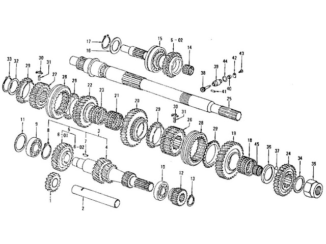

Picture of Blocker Dogs and springs below. F4W71B ( F4W71A is similar ) . Numbers 30 and 31 in picture.
Synchro hub assemblies consist of #28 ( x 2 ) " Sleeve Coupling "  and #26 and #27 " Hub Synchronizer in this example:
