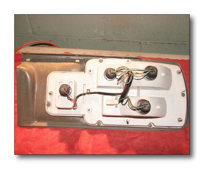

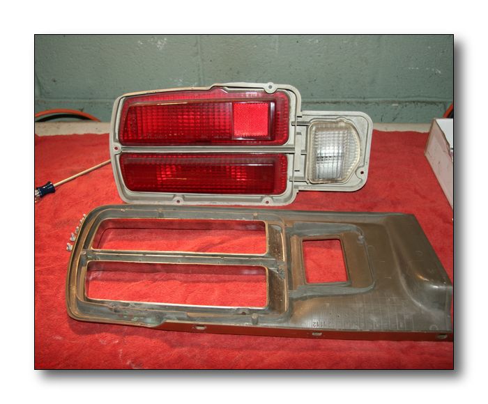

April 8, 201510 yr comment_467327 Here are a couple of pictures of a 76-280. If you car is a late model 260 they should be the same. On the back of the first picture you can see the stude that hold it to the inside of the car. Edited April 8, 201510 yr by mgood Link to comment https://www.classiczcars.com/forums/topic/51261-rear-panel-surrounding-tail-and-reverse-lights/#findComment-467327 Share on other sites More sharing options...
April 9, 201510 yr comment_467329 It's not just LATE 260Zs. The EARLY 260Zs used the same rear panel. Link to comment https://www.classiczcars.com/forums/topic/51261-rear-panel-surrounding-tail-and-reverse-lights/#findComment-467329 Share on other sites More sharing options...
