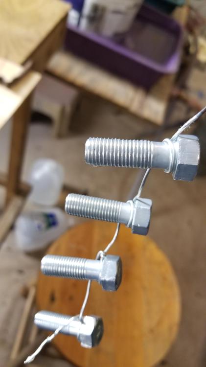

Please forgive if I have already posted these, I lose track...
This is what you want right out of the tank! the shinier the better!

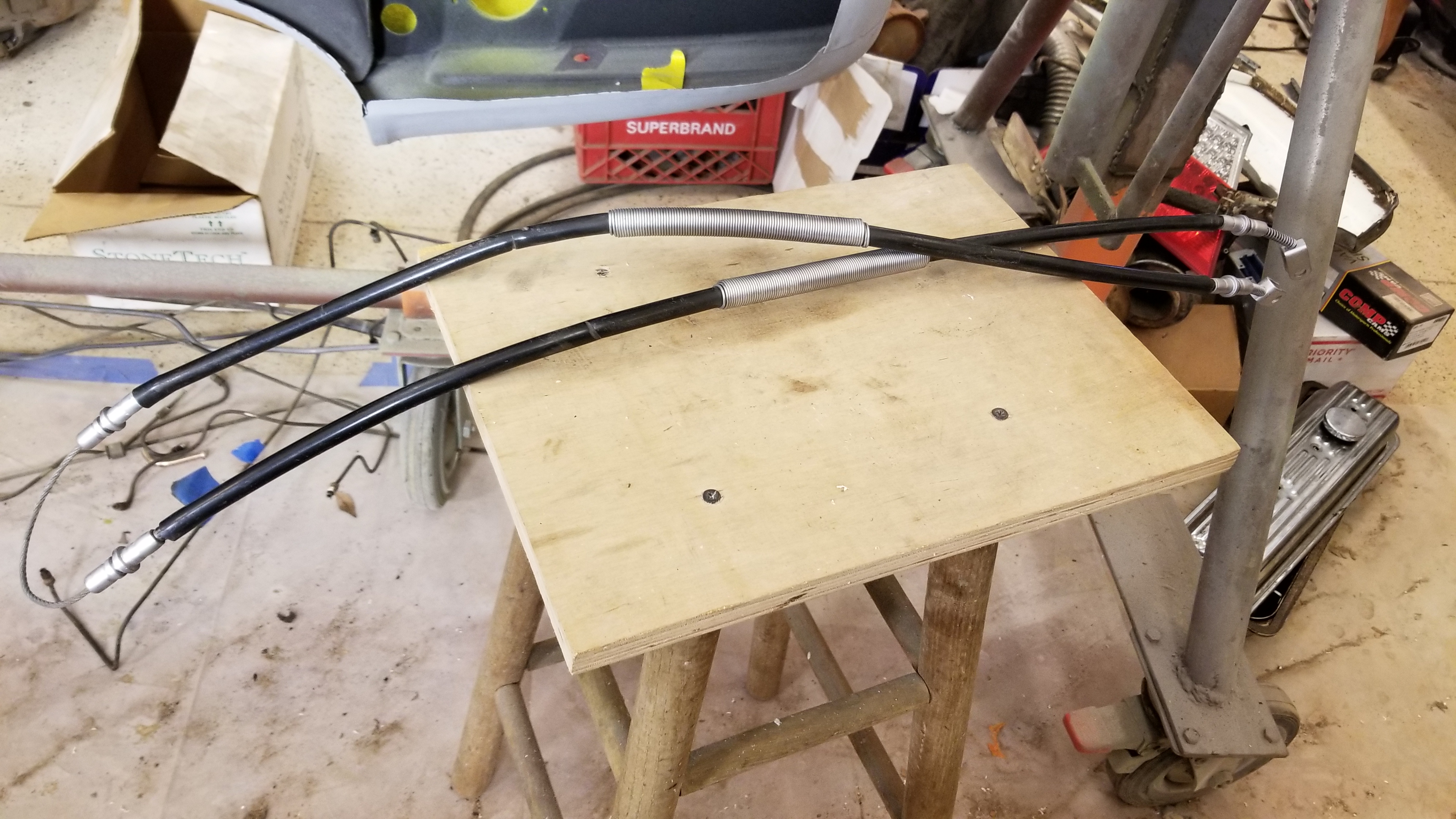

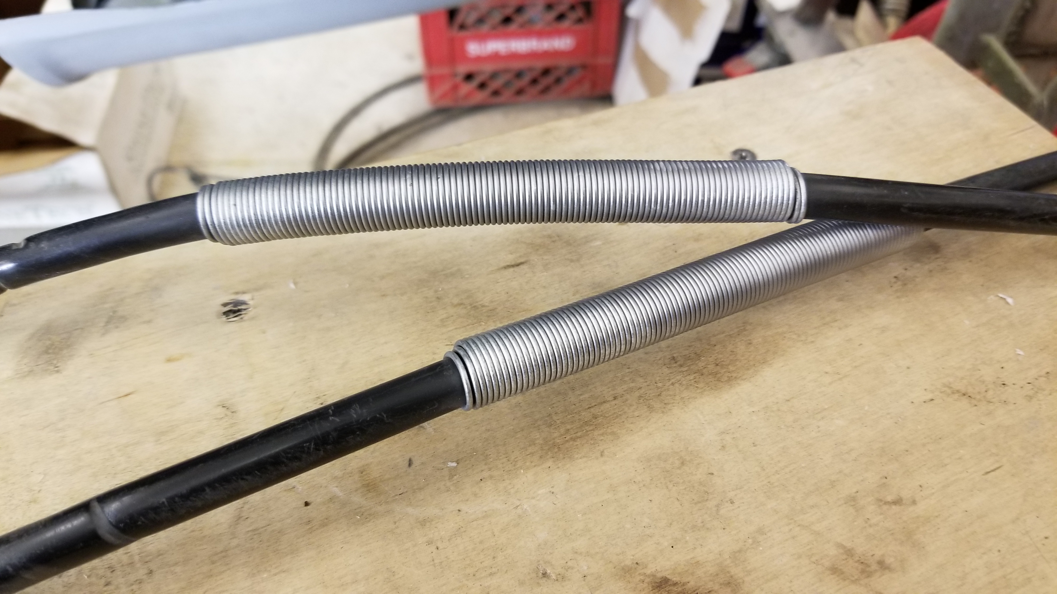

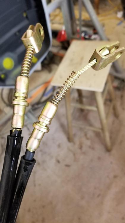

I took a shot at the E-brake cable. I blasted them and degreased them. Then immersed the ends  and plated. Then I folded it in half and plated the center springs.

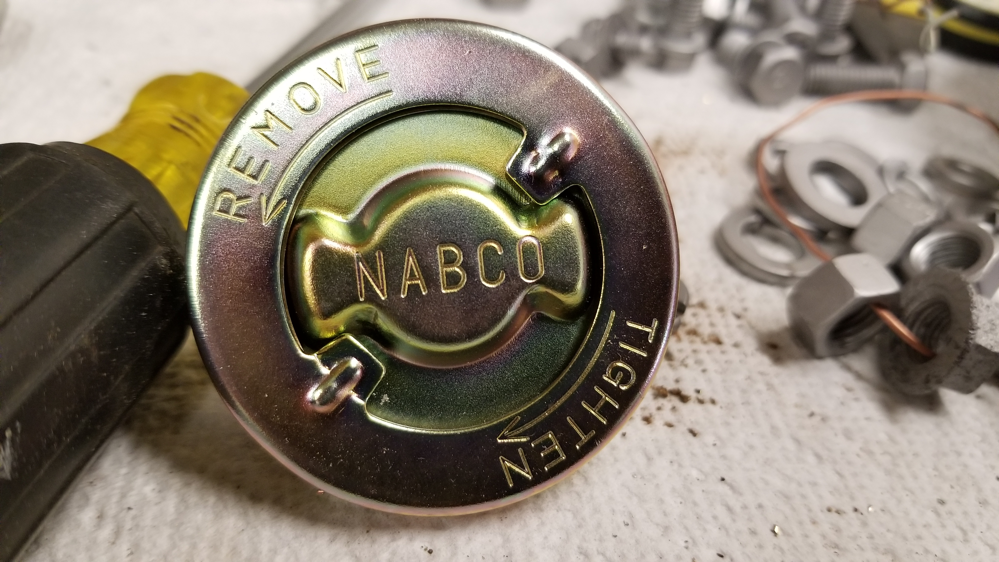

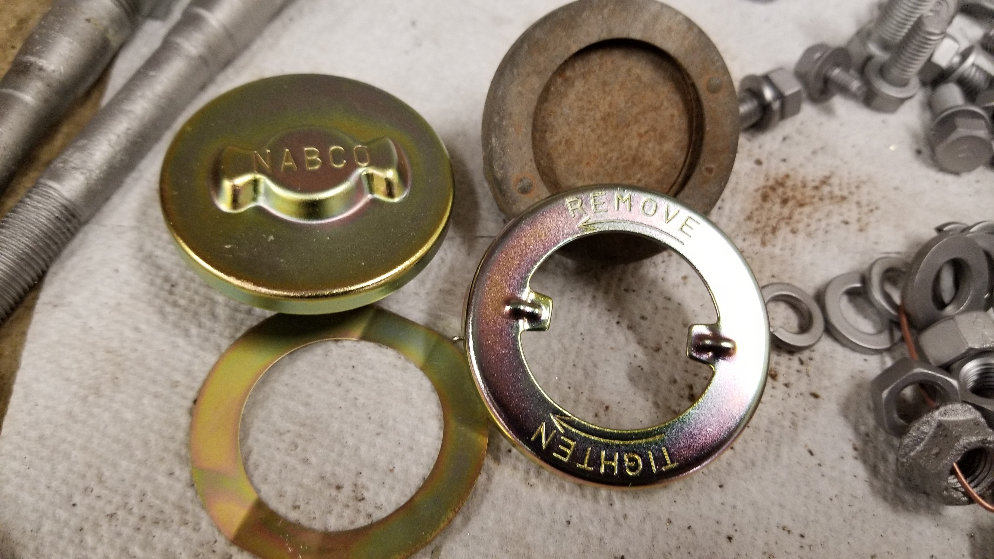

I also took a shot at some old master cylinder caps.
They turned out pretty good. The corroded cap is similar to what I started with

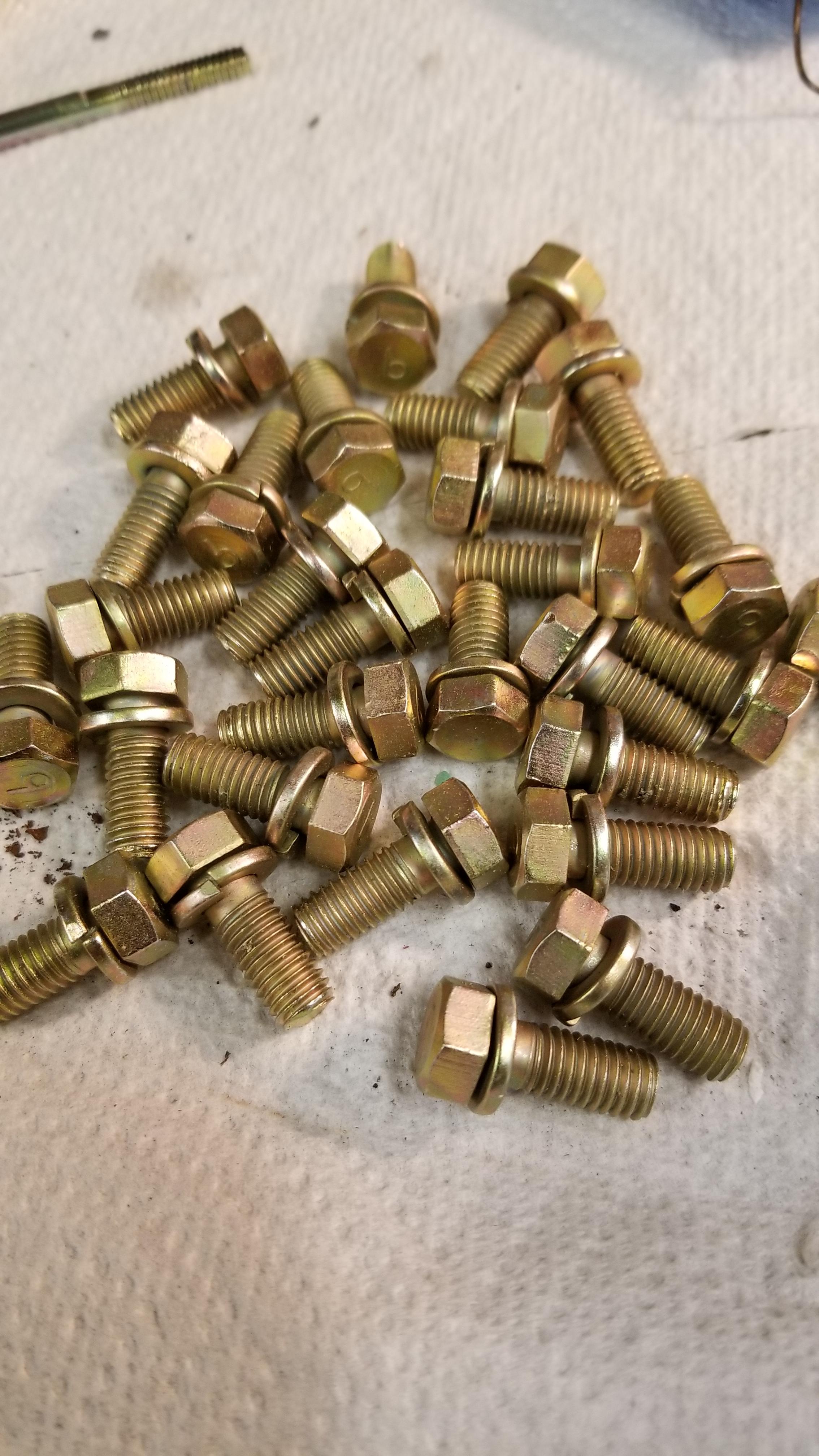

This is my first batch out of the barrel plater.
They look ok, but some of them burnt. They could also be shinier. The barrel is so slick inside, the material doesn't rotate. It just slides. So I worked on modifying it yesterday.

looking good.... now you know how hard it is to tell someone how to setup for plating. Once you figure out what works for you then keep on doing it the exact same way.

I totally agree. My biggest thing now is sometimes I get a really shiny plate and sometimes I don't. I have used a lot of brightener, but am not sure if that's the secret or not. Part of it is the way the parts are wired, hung and powered.
Someone else's experience does help narrow the process substantially. Also I have found that other Caswell platers are better at troubleshooting than the Caswell forum or support unfotunately.

I have found that water circulation on and around the part is the key to shiny parts. I use 3  small pumps, harborfreight is what I use.

Temperature and current also affect shininess according to some documents I have read.
I believe current plays a major part. I lean towards more current is shinier but I haven't done anything that makes that conclusive.
It would be interesting to know how temperature affects shine. My bath is thermostatically controlled about 117F or so
