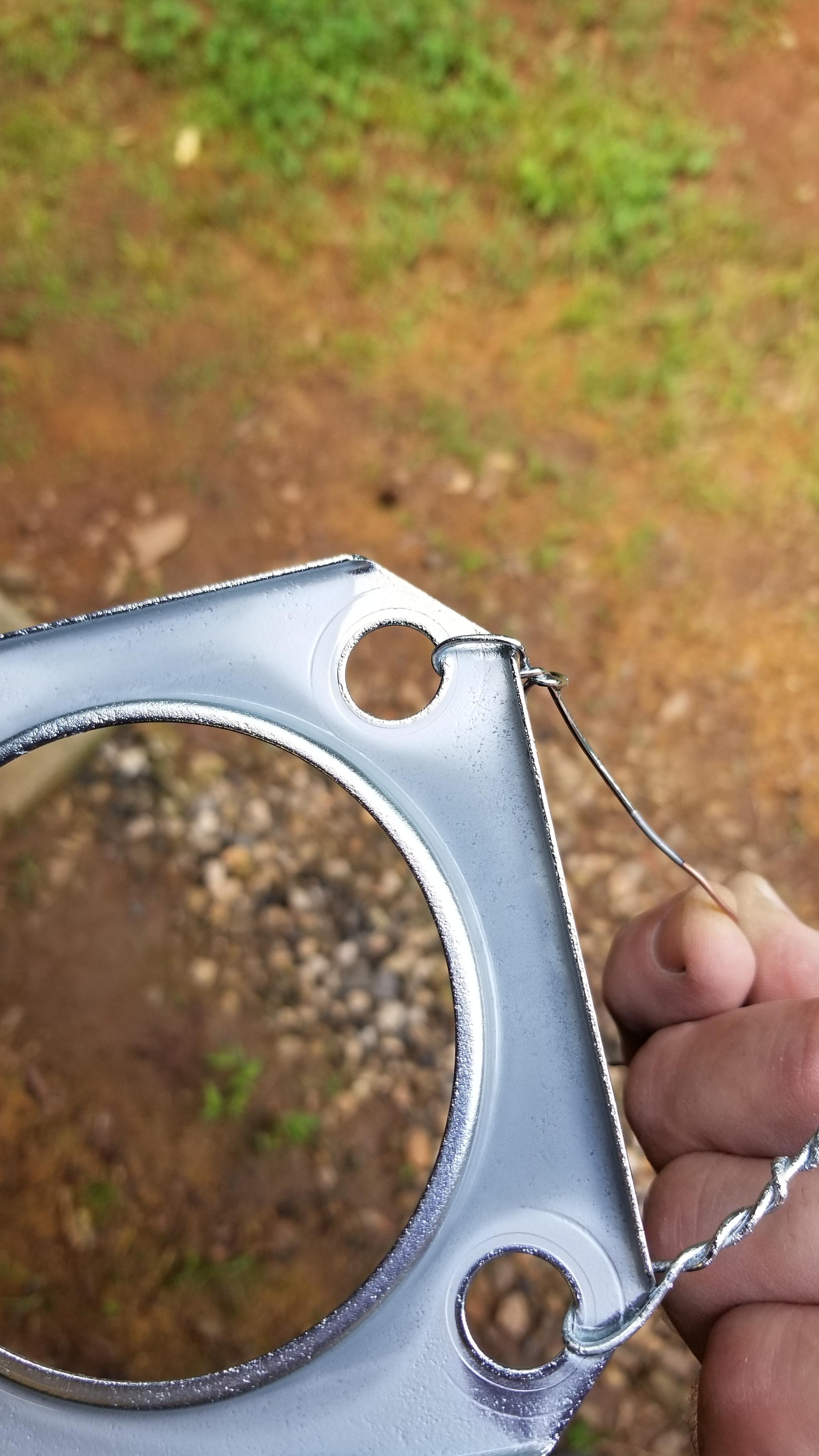

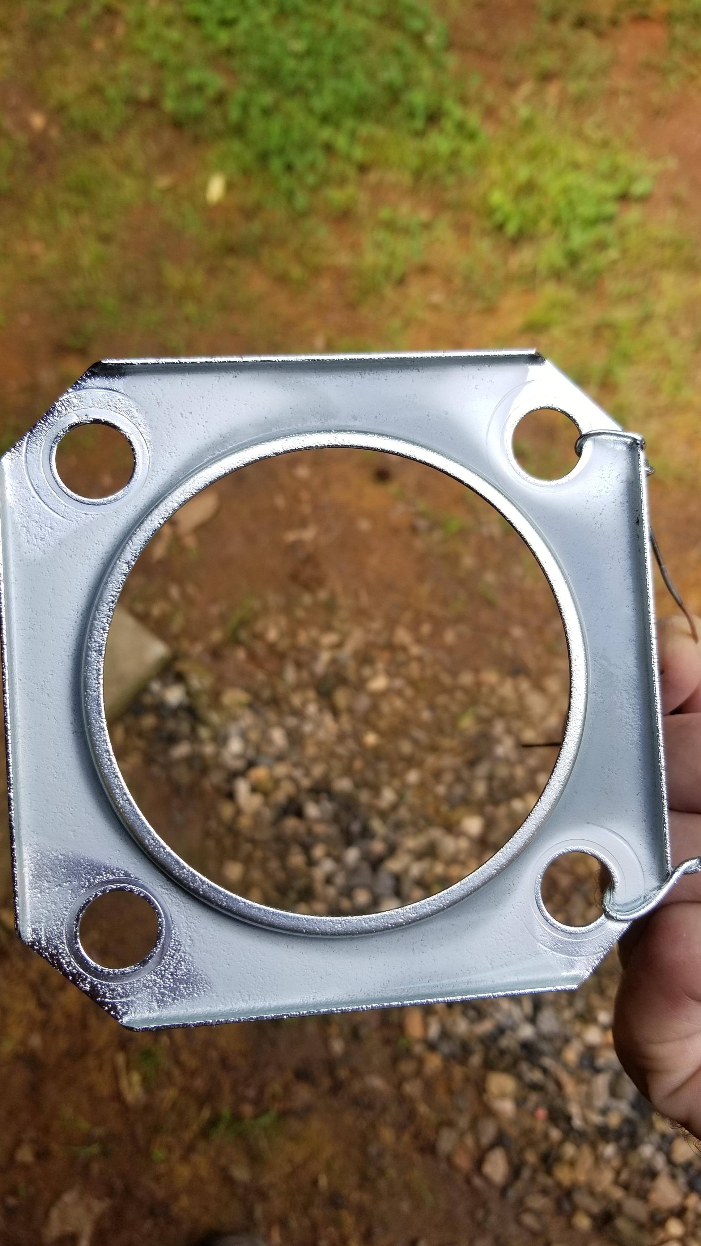

I ran some plating last weekend and I ran it at a lower temp. Got pretty good results. Not conclusive...
This is a run coming out of the plating tank. Really nice chrome-like results. Might be hard to see in the pics

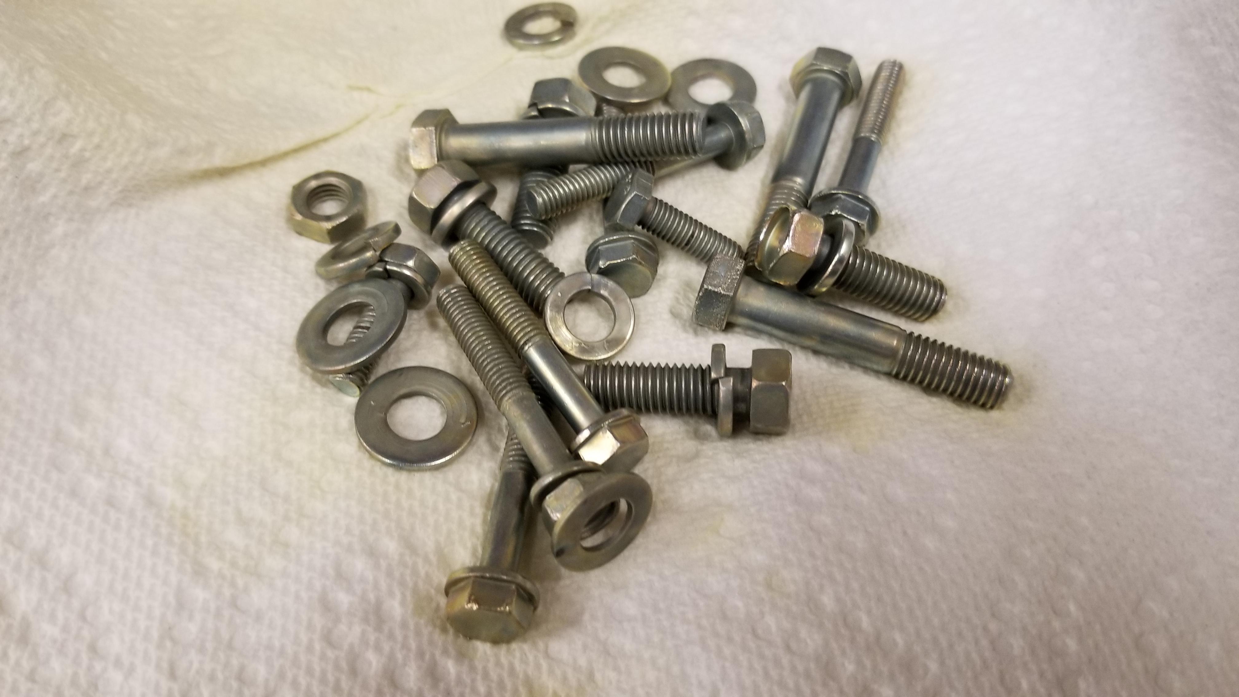

Zinced
Overall a good weekend in the shop...

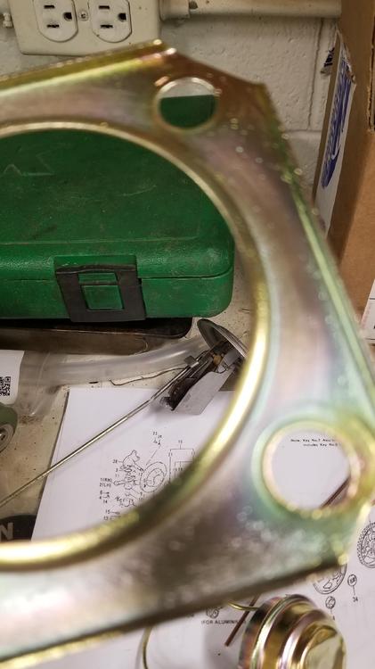

Fired up the plating bench again today. It's sort of hard to start and stop. Would probably be easier to just plate until everything is done. The starting and stopping can make it hard to get the setup working right again.

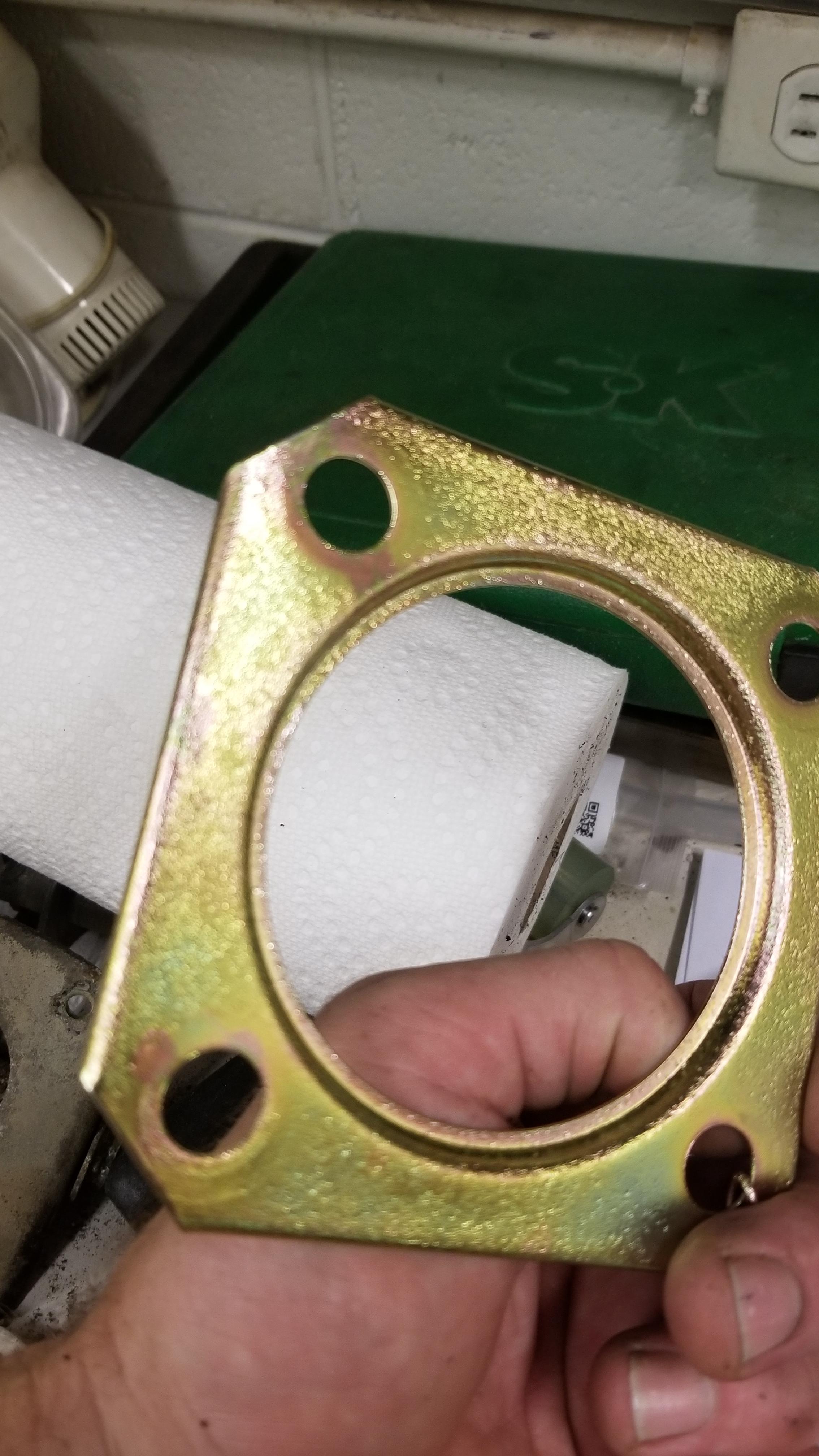

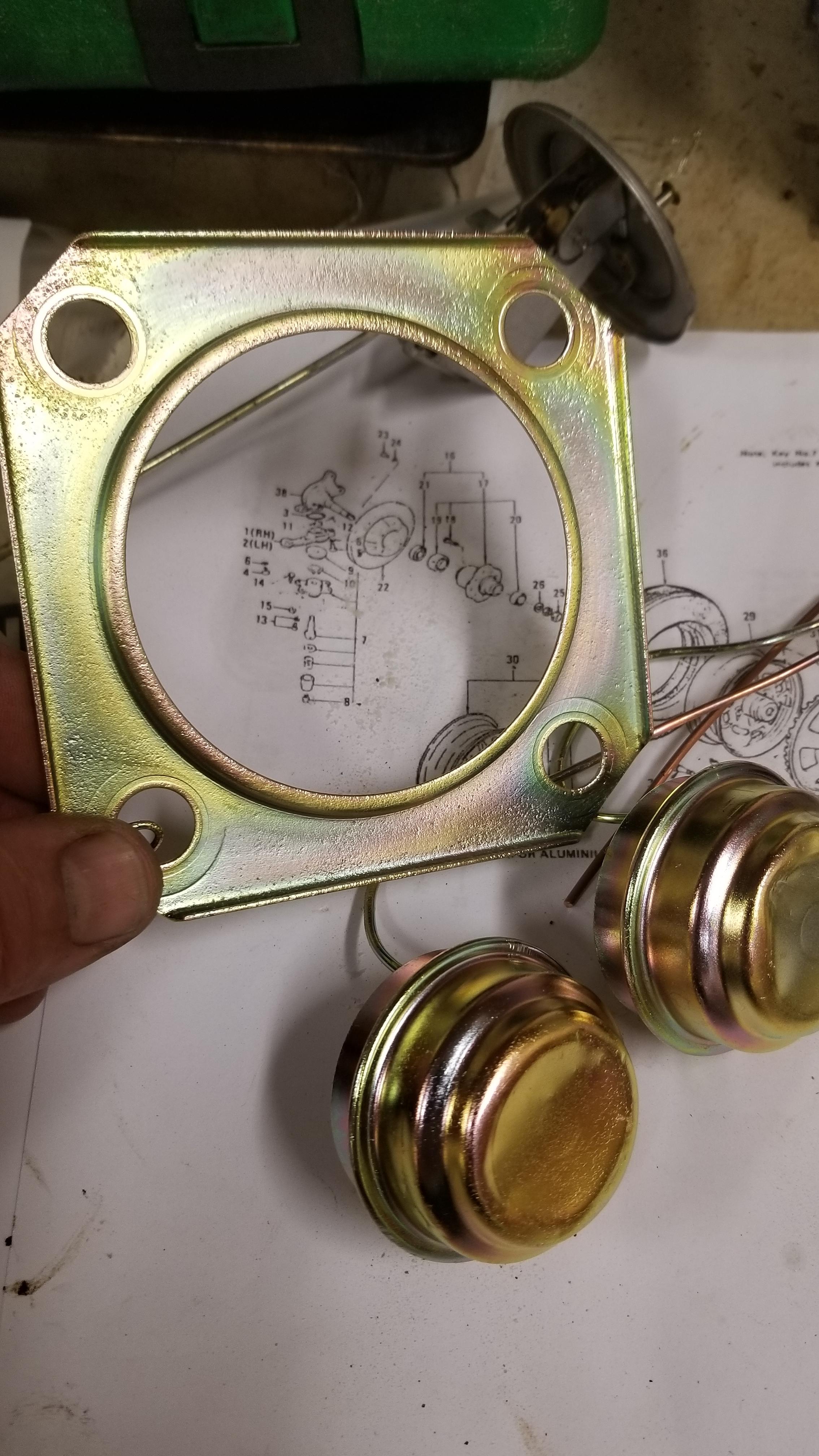

I tried to plate this "grease catcher" today. It goes on the back side of the front hub, held on by the wheel studs. Got mixed results

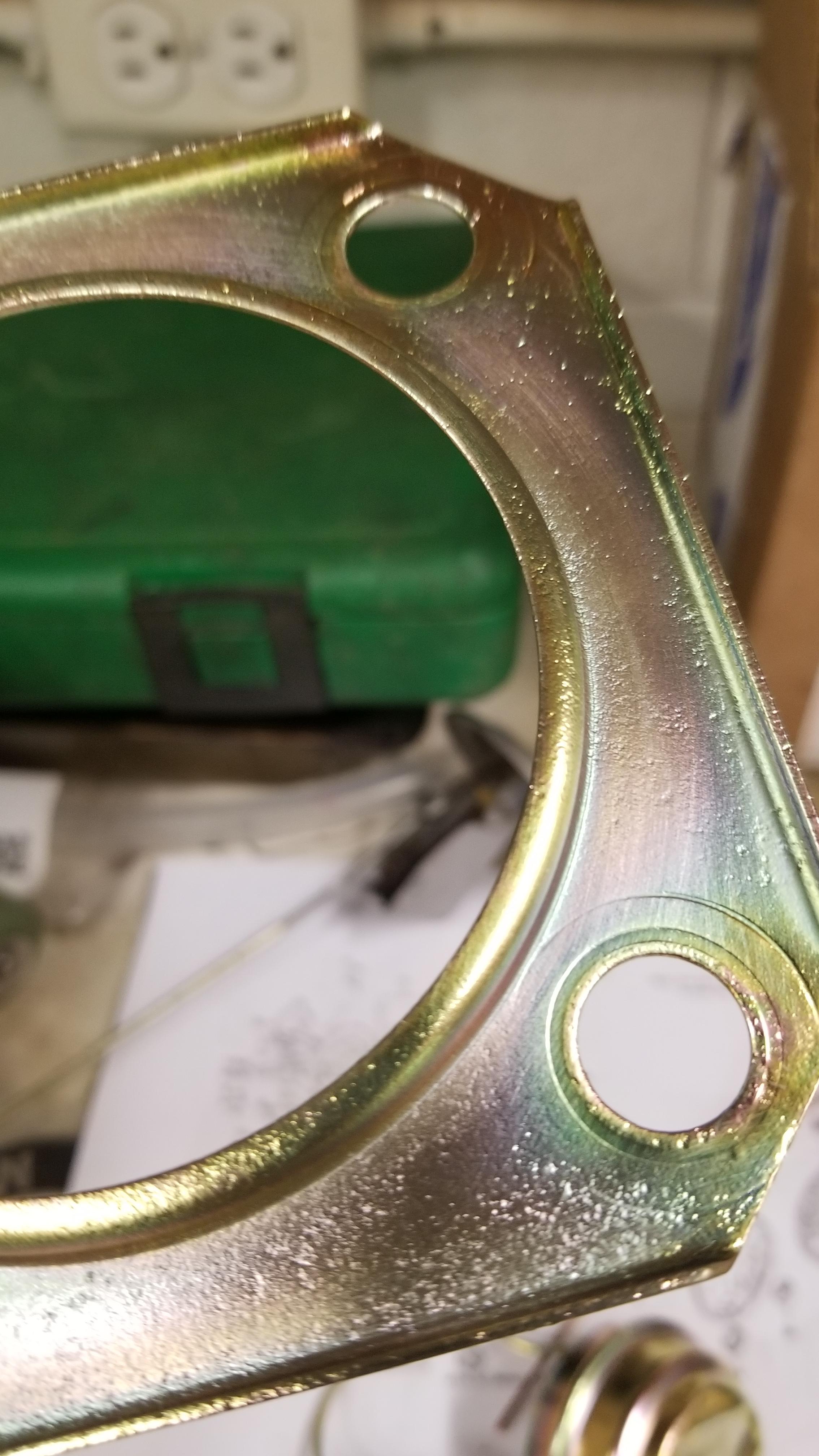

I had these dull spots. I ran the current up and down and couldn't get rid of it. I ran this all the way through yellow cad and dried it. The dull spots wouldn't take color. Then I bead blasted it again and replated it. I had to rotate it a good bit to get it all to plate. I still had a few dull areas that I polish with a scrubby pad before chromating. Here is the result
I think part of the issue was my power supply was maxed out. I ran this basically at 10 amps and I think it could have been higher. I have found higher currents make my parts brighter. I plated some front grease caps at close to 6 amps and they fizzed the whole time, but they came out shiny and nice. You can see them in the earlier picture...

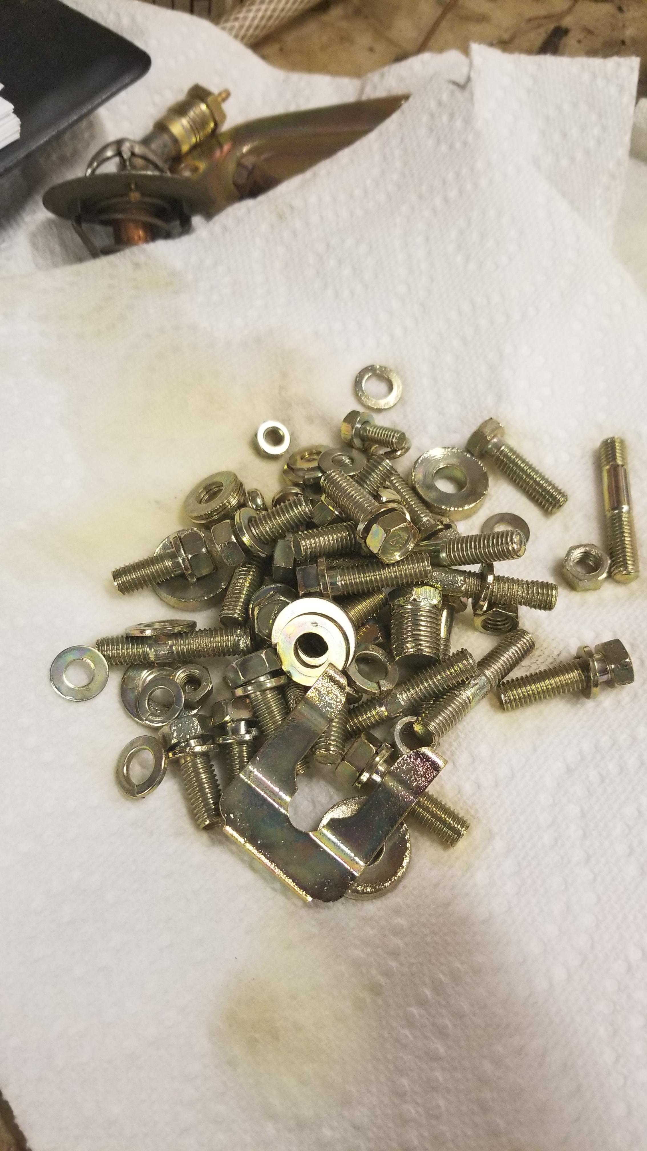

I love having the barrel plater!!! I did these today in one batch. Load em up and let it run for like an hour.
I have found when my plate comes out really shiny, I blue dip for a minute or so, maybe less but I have to color dip for as much as 7 minutes to get color. I assume it's because the really shiny zinc is just harder and doesn't take color as well. I have also found when my plate isn't shiny I can turn up the current and the plate will brighten up. I have run as much as .32 per inch.
