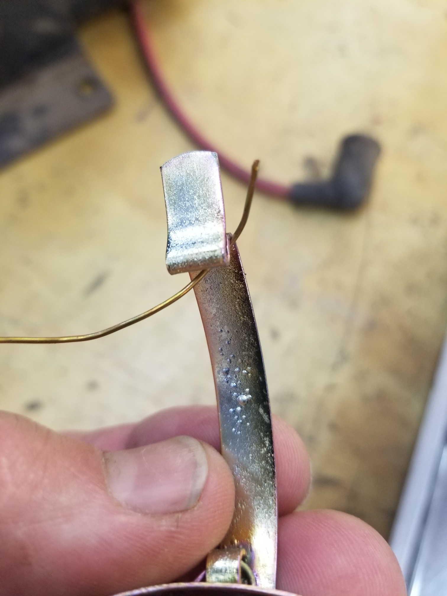

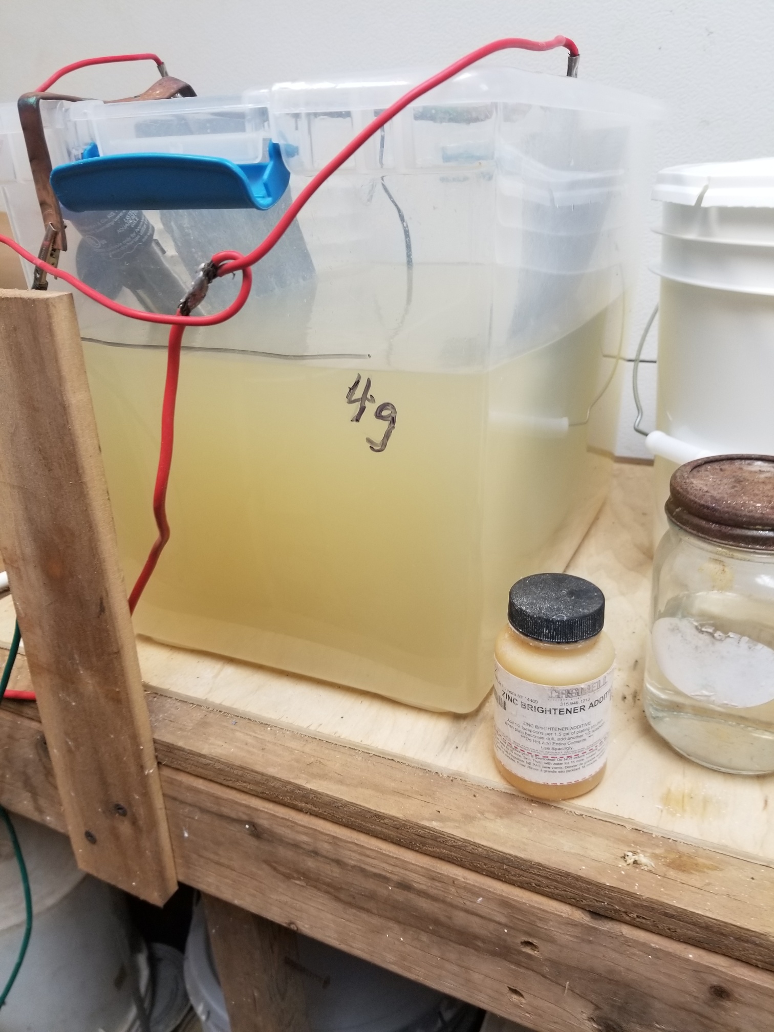

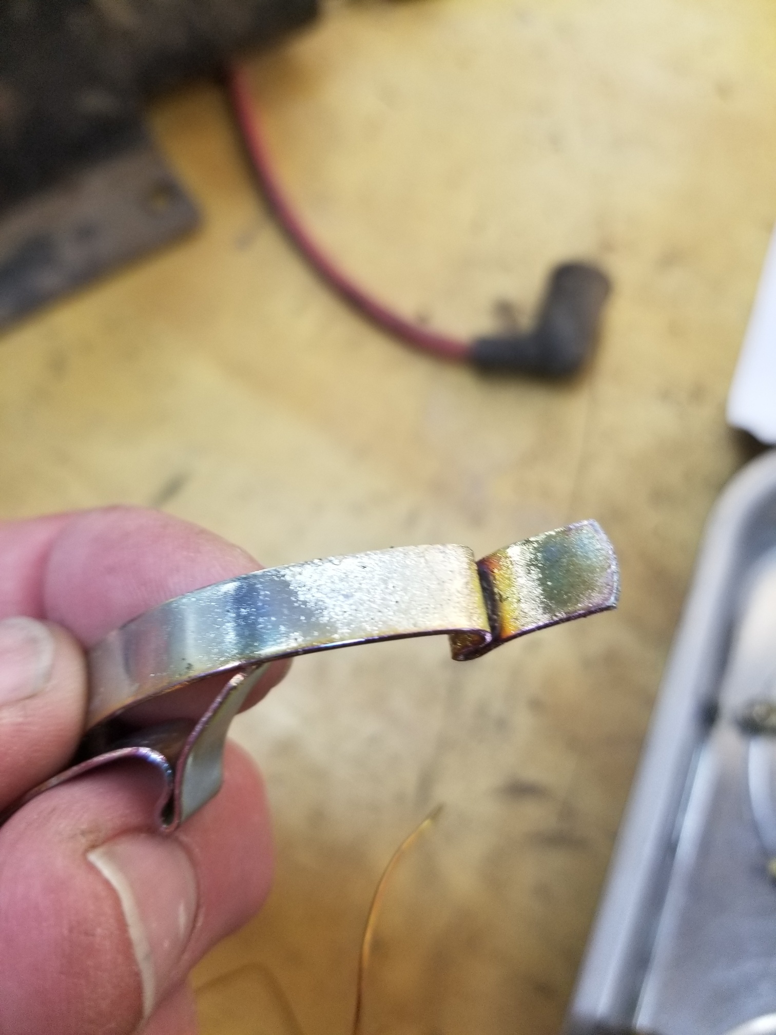

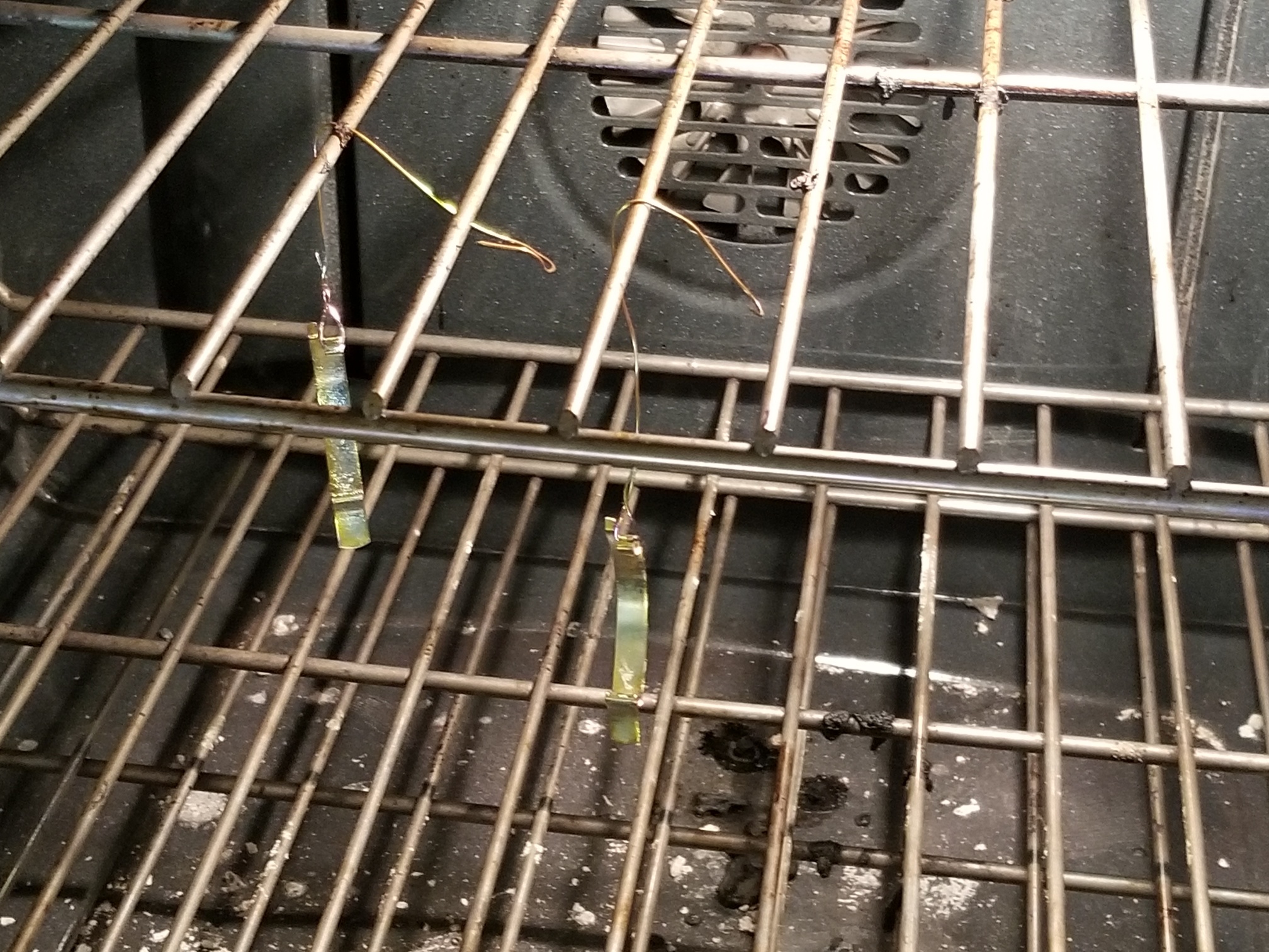

I have been doing some plating while working on other things. These distributor clamps were plated yesterday. I plated them and then baked them for 4 hours to reduce any embrittlement.
But after plating they blistered. So they will have to be redone. I suspect this is from too much brightener.

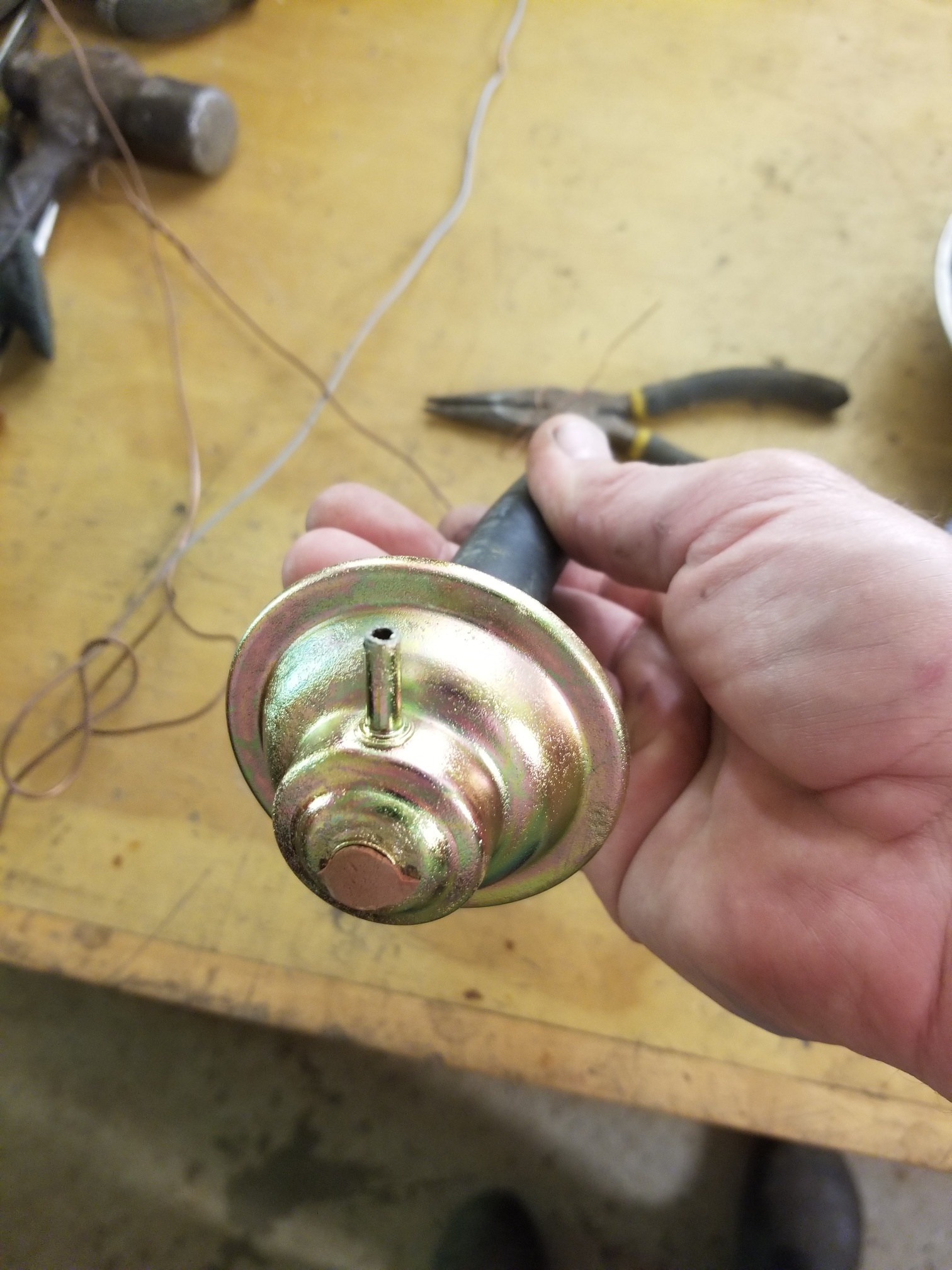

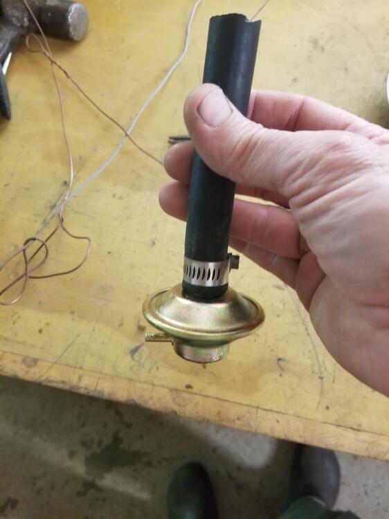

I plated the vacuum advance the other weekend
I wired it and then put the hose on it to keep the liquid out. I plugged the advance port
It turned out pretty nice for as crusty as it was. What was interesting was when it was in the tank one side would get really shiny but the other got dark. Rotate the piece and the discolorations would move. So at the very end I just wired the negative directly to the wire coming off the part and held it in the tank by hand. I rotated the part slowly and all the plate brightened up. It was really cool to watch. So this would tend to support barrel plating as giving the best finish results...

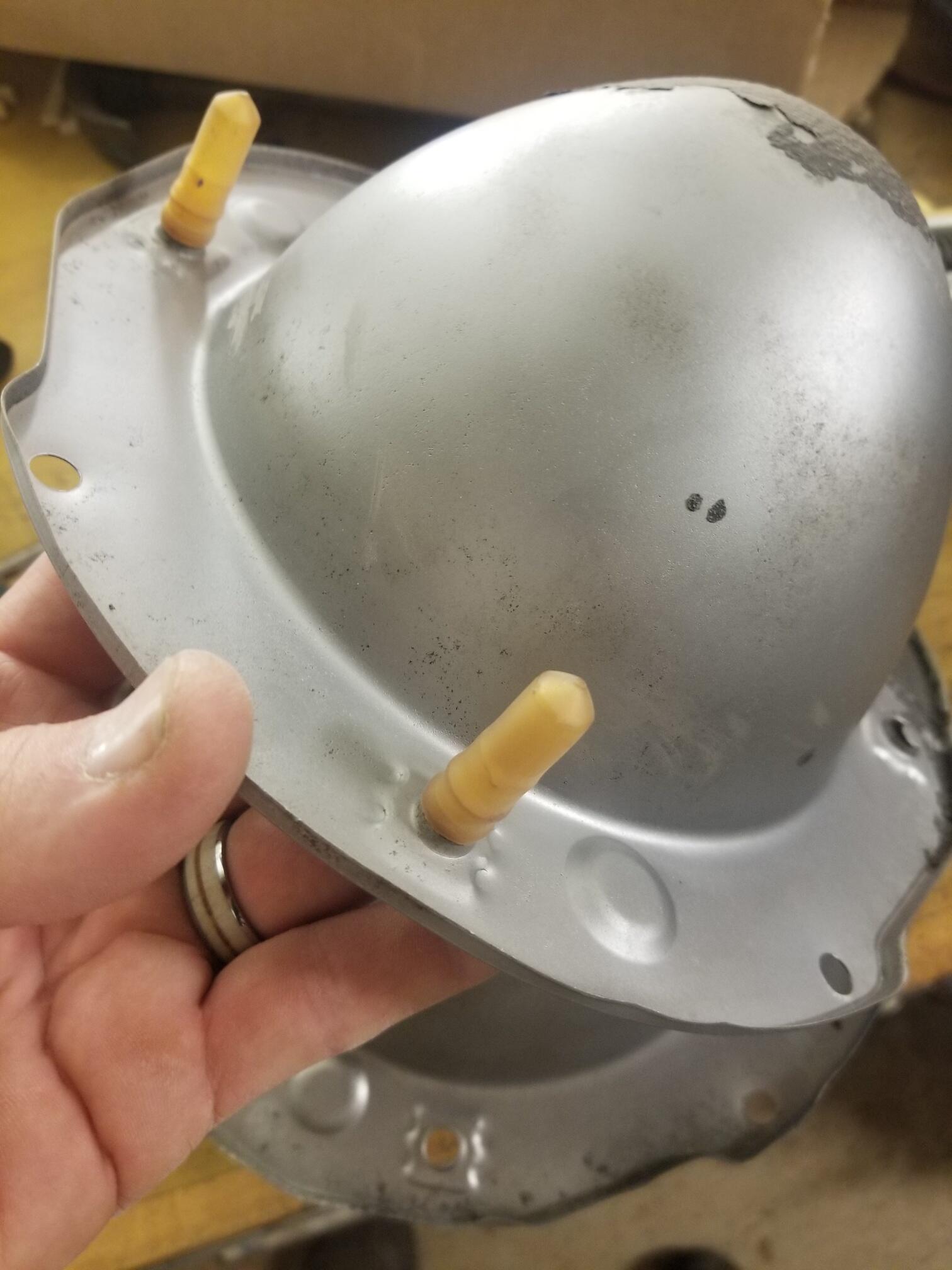

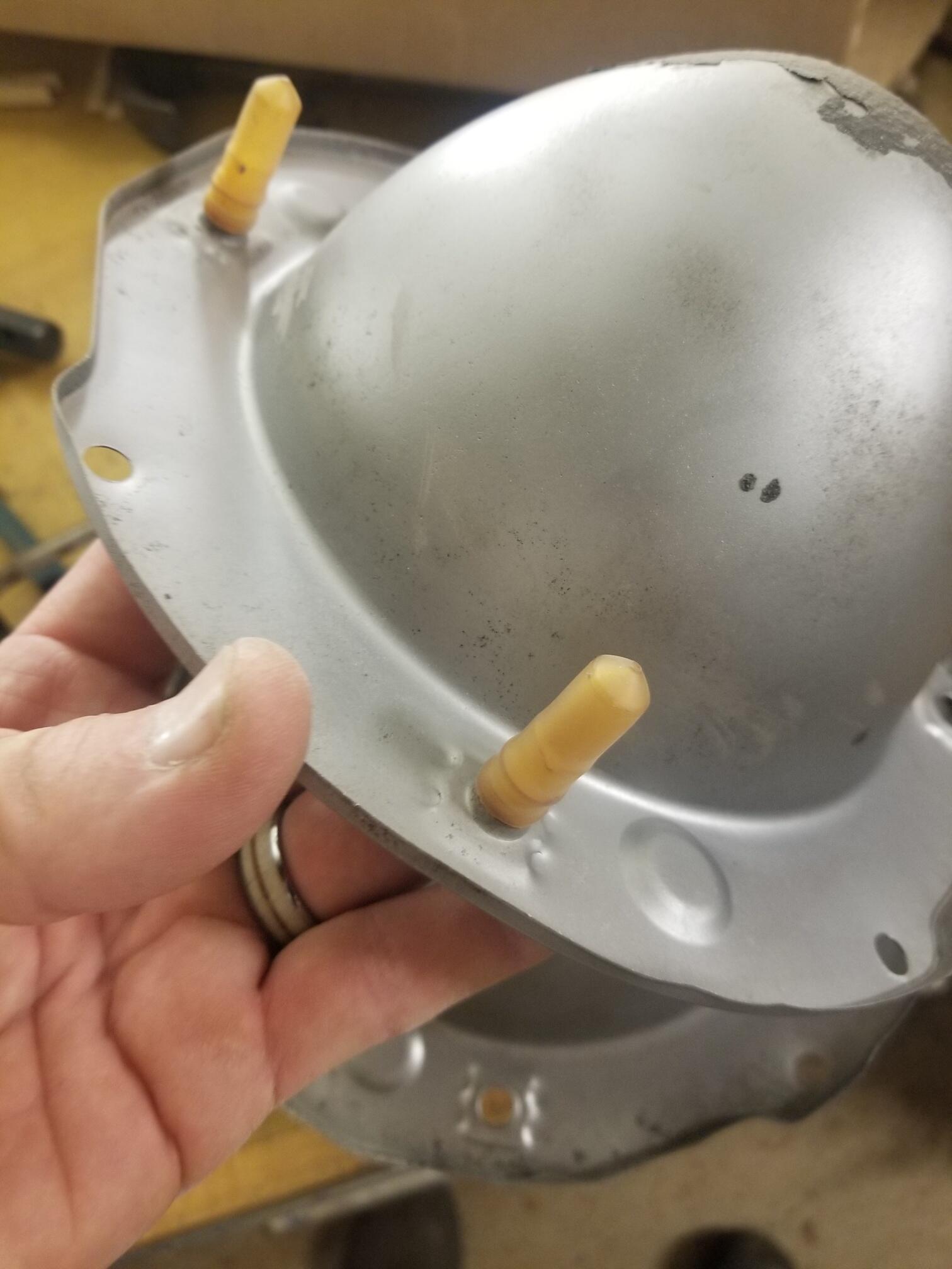

When people are getting the headlight buckets plated, are you leaving the plastics for the adjuster screws in the buckets?

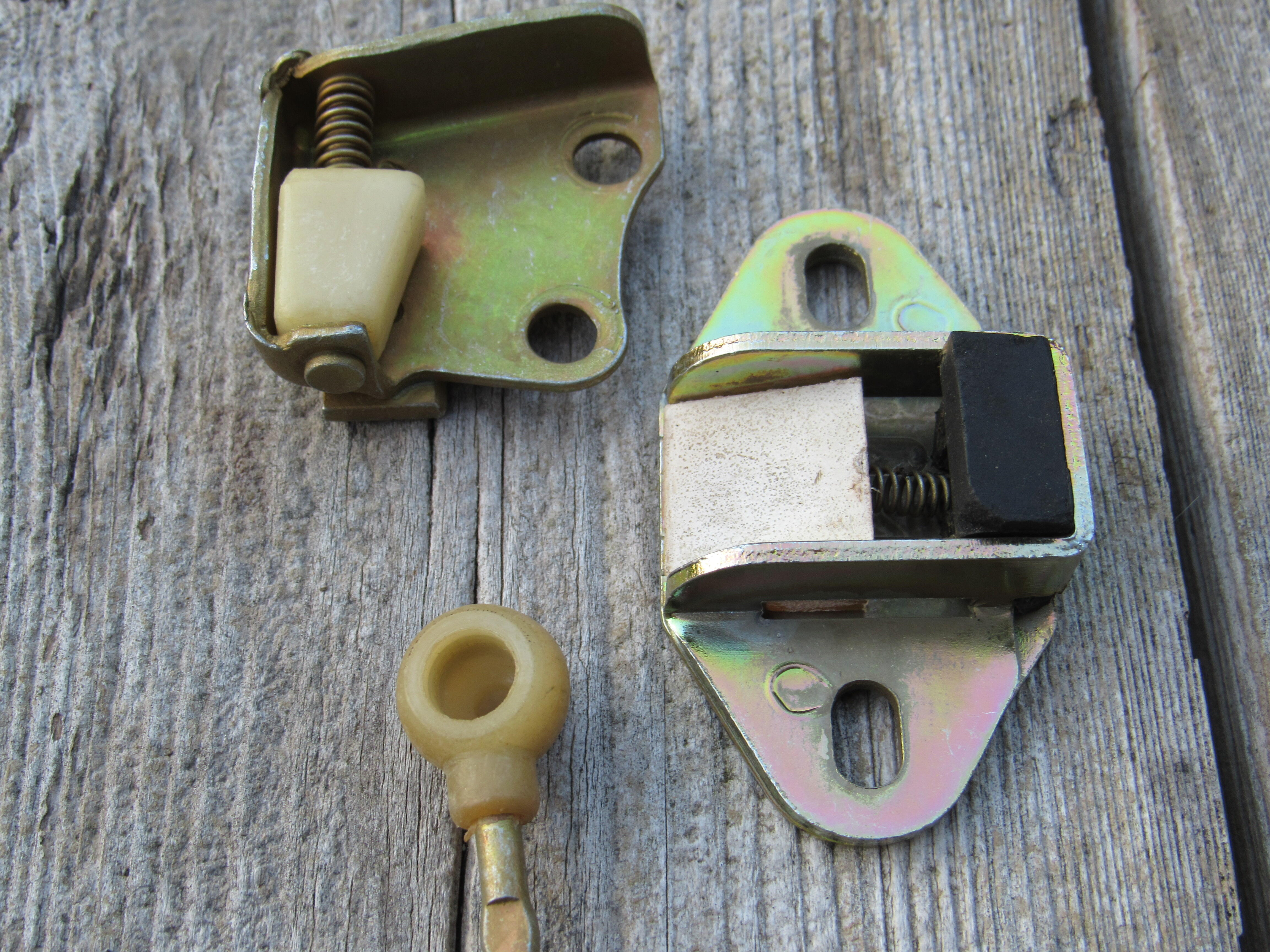

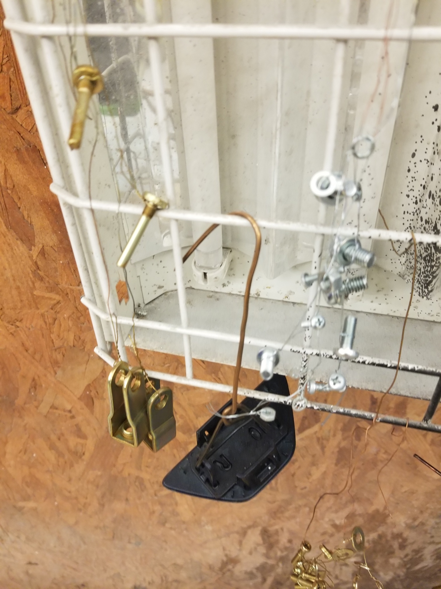

Also when people are plating the latch mechanism from the edge of the passenger doors. Are you just cleaning them the best you can and plating them or are you disassembling them to some level?
I would suggest that if you are plating for corrosion resistance, remove all removable parts.
It's a different problem with assemblies that are riveted or staked.  How do you replace the rivets or restake something without tooling?  I suppose you could always make them.
If you plate the door latch as an assembly, I suspect you'll get little protection for your effort.

I agree in principle but I know those plastic pieces aren't going to come out whole. They're too brittle. That means I would have to have replacements for the three pairs of headlights I am redoing. Also since I can't find the special rubber caps for the adjustment screws, the hardware will be exposed to the debris and water coming off the front tires. I don't think that is a good idea either for a long term solution. I was hoping someone would have a source or an elegant solution...

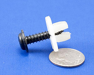

I can't find my pics now but in the past I bought a box of square white plastic screw anchors then removed the stock anchors and filed the round holes to a square and popped in the new inserts.  Then a 2"piece of 1/2" dia shrink tube, you want to use a fine tip butane torch or even a match will work, slip the shrink tube over the anchor and heat up the area just covering the anchor.  You want most of the tube unshrunk so the adjustment screw can travel, then the last thing is to heat up the very end and pinch in hard until it seals up and is water proof.
The square white anchors I used were large enough to accommodate the stock M6 adjustment screw, the pic below is just something I lifted from the net.

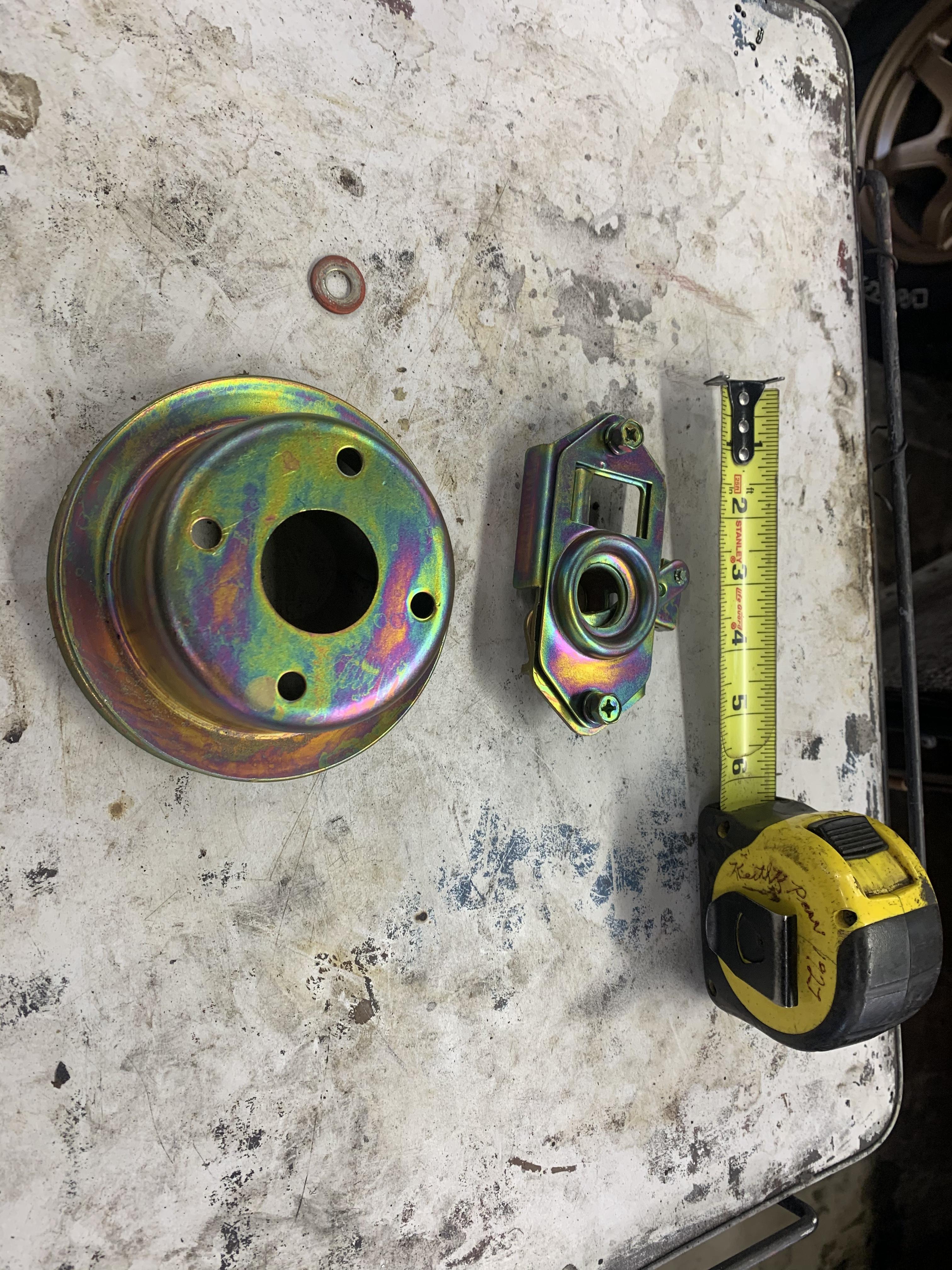

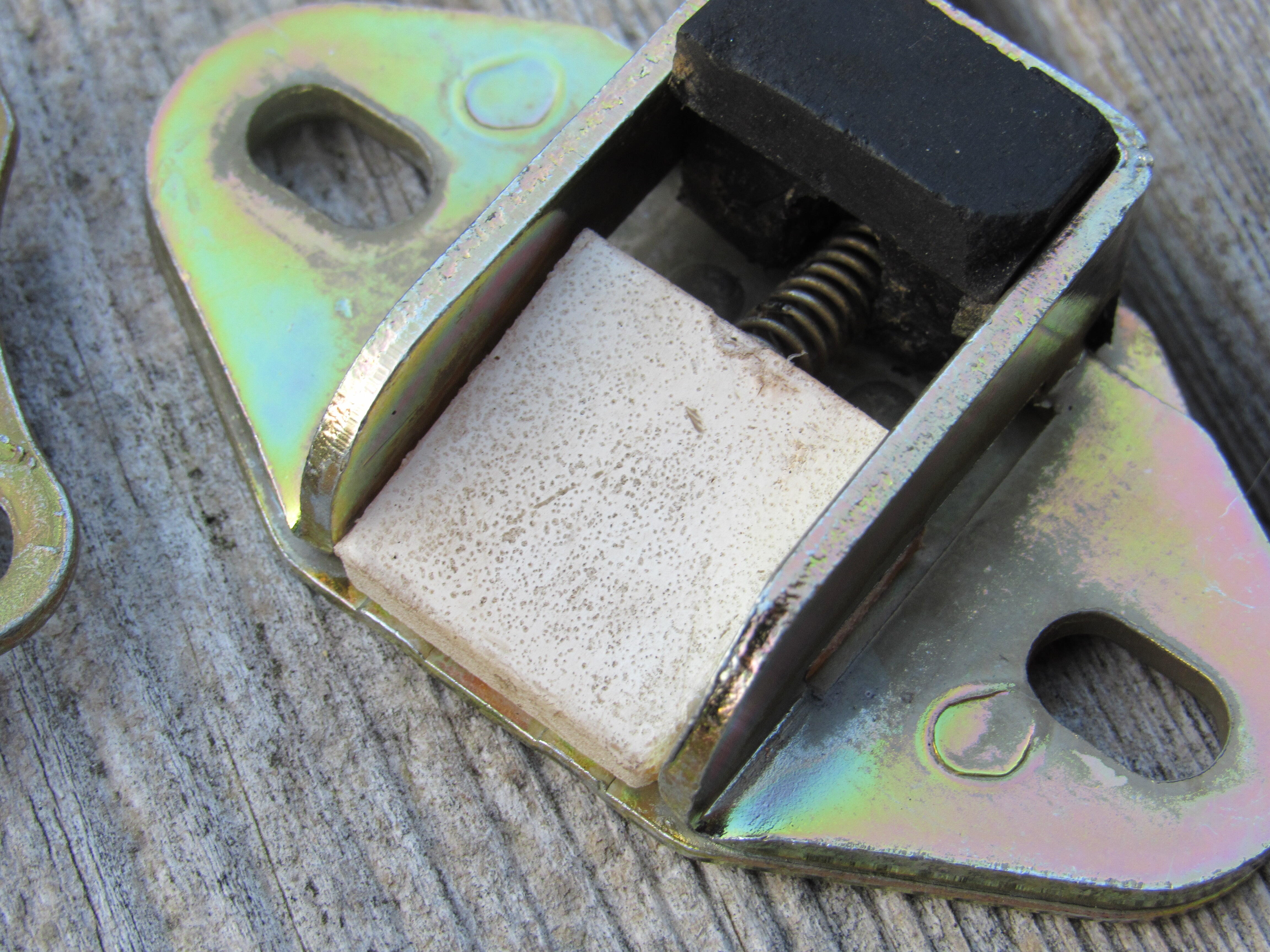

As for the plastic parts that can't be removed, the chemicals they are using to remove rust at the platers can be hard on the surface of the plastic so if you do have to send in those kind of parts then it is best to remove all the rust using electrolysis or citric acid before you send them in so the part doesn't have to sit in the acid for too long.
You can see in the pics the 2 pcs to the left the plastic wasn't damaged at all but the plastic rear hatch wedge has turn white and rough from the acid.
