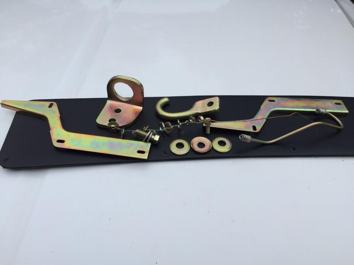

Nice work, Chris.  Pretty labour-intensive, but a great end result.  Looks like the acid prep and chromate finishing dips have paid off, so I guess I'm off to the hardware store to buy a few more buckets to add to my growing collection.

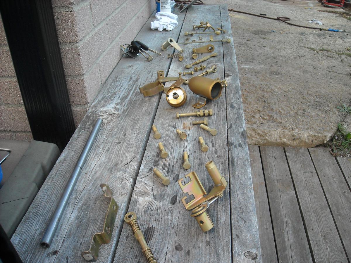

I skipped off work early today so I could get a production line going and get a bunch of stuff plated,
about a 1/3rd of everything I plated had to to be re-done because of spots I missed in cleaning or was contaminated on the way to the tank. This process doesn't let you get away with anything.

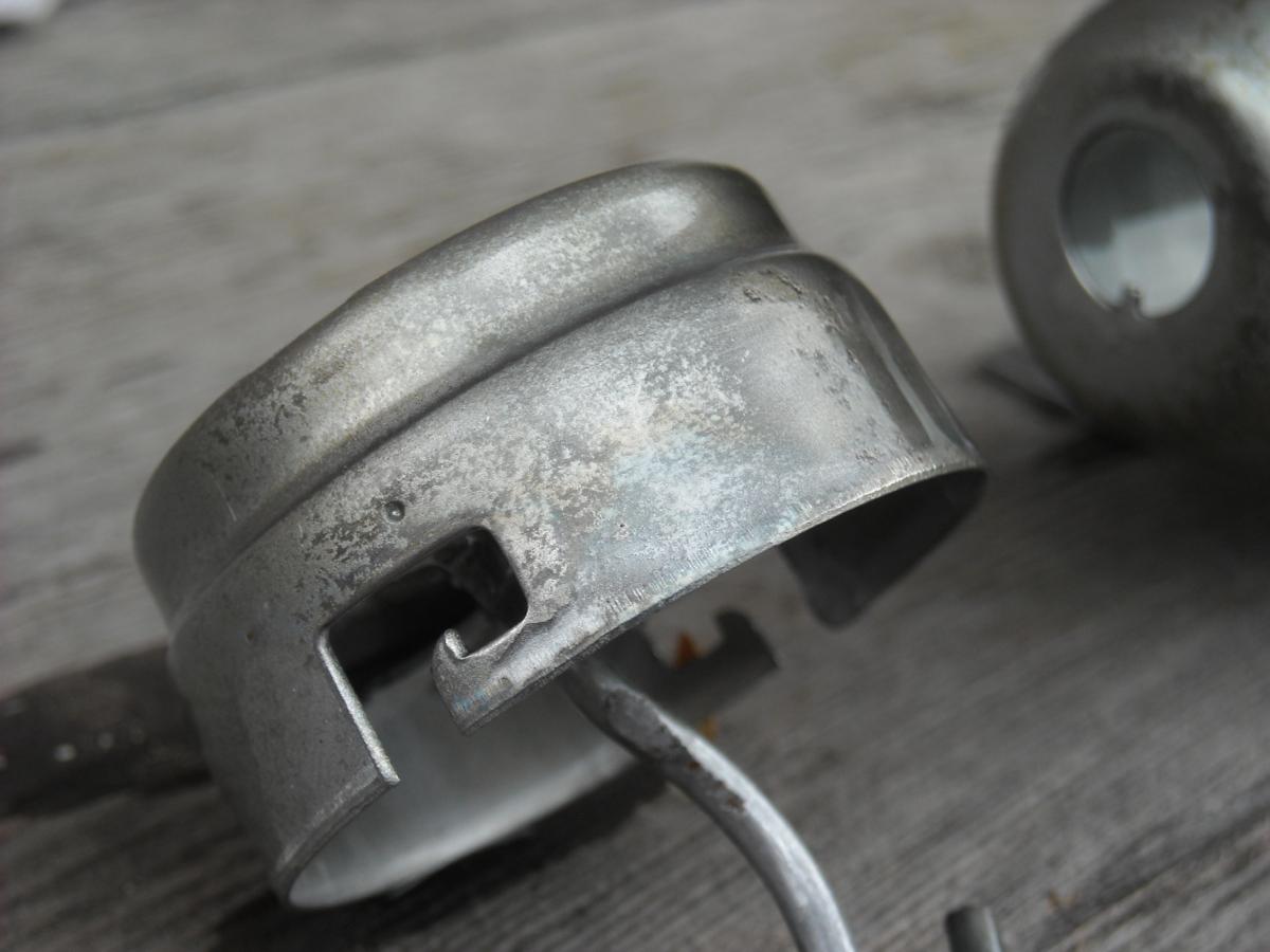

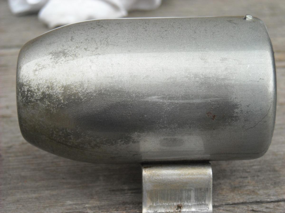

The muriatic acid is excellent in showing what still has to come off with the wire wheel, the pic of the engine bay trouble light shows a layer that still needs to be removed.

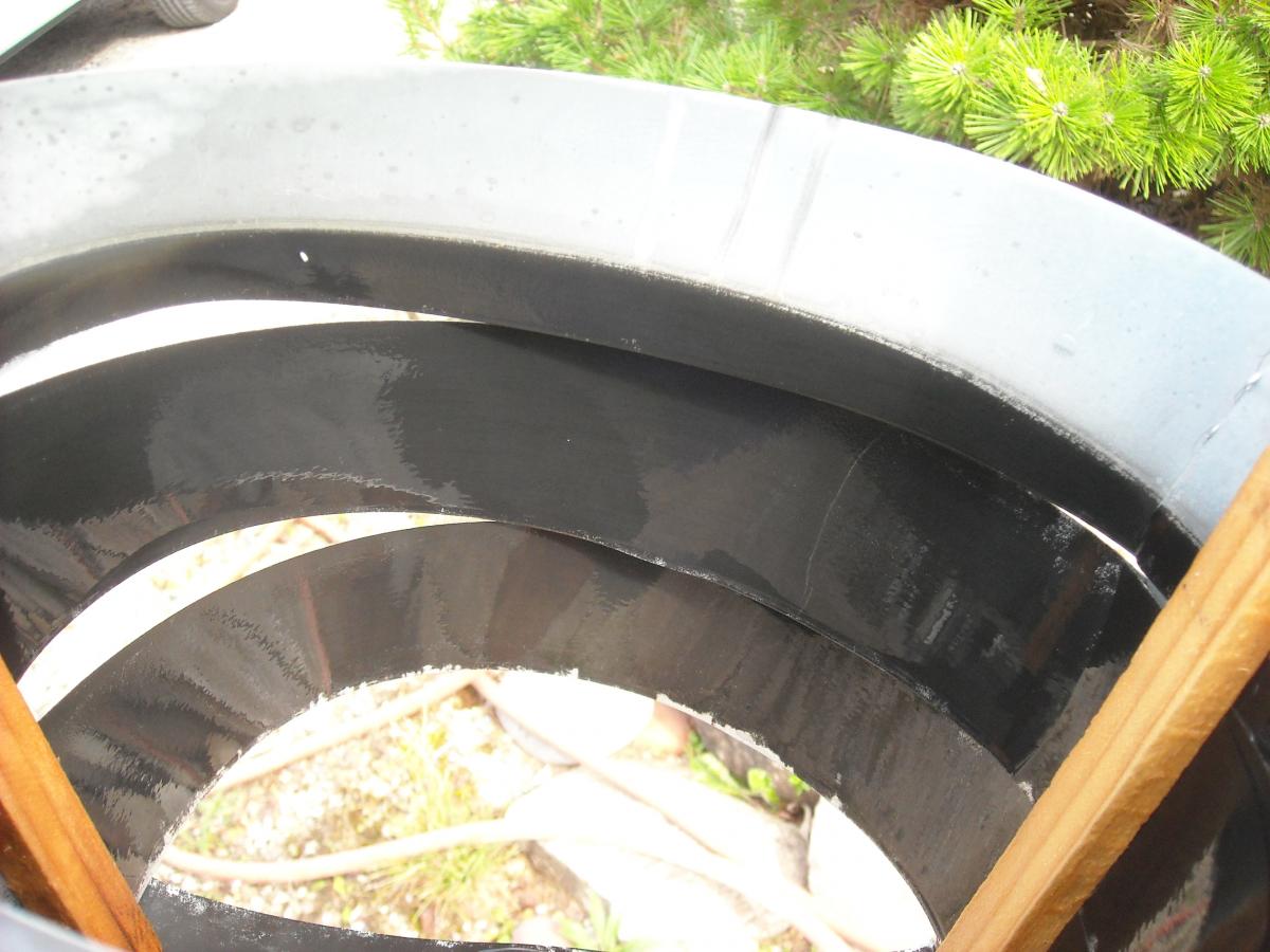

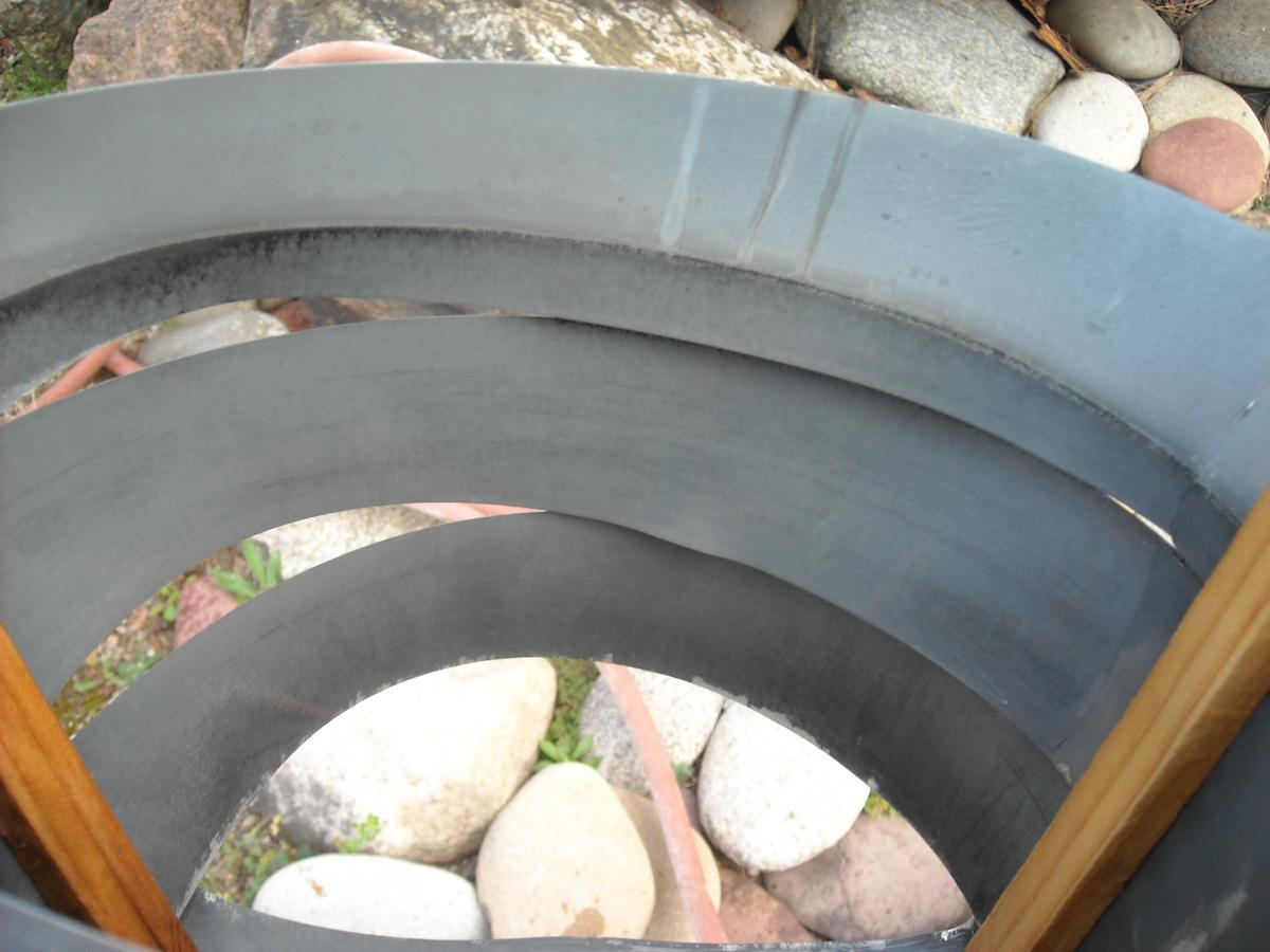

After a couple of hours this black soot stuff builds up on the zinc anode, it just rinses off but it starts slowing down the process. The pieces started coming out kinda milky or cloudy towards the end,
not sure what is causing it.

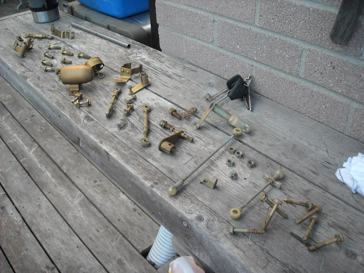

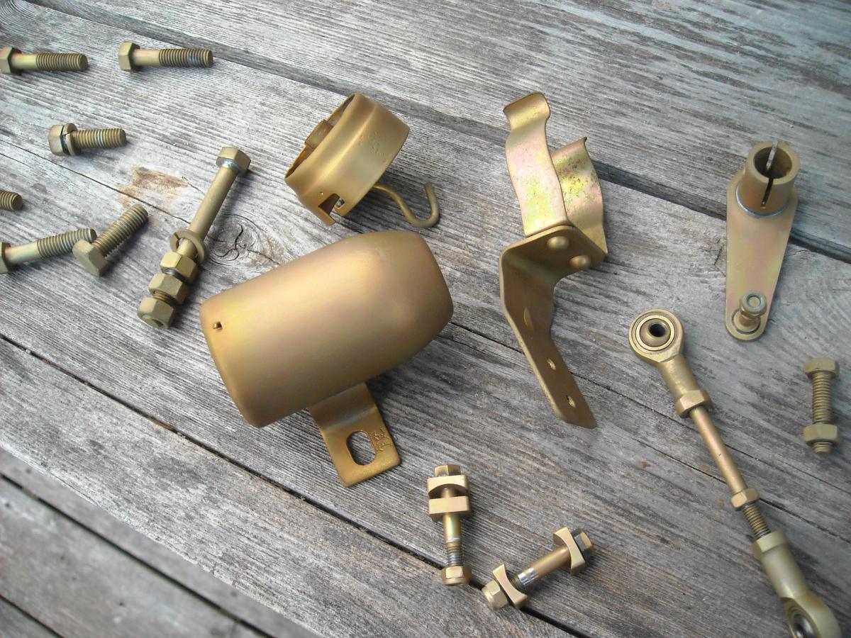

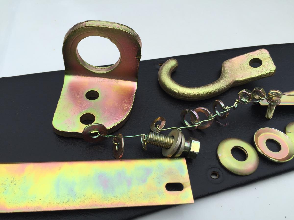

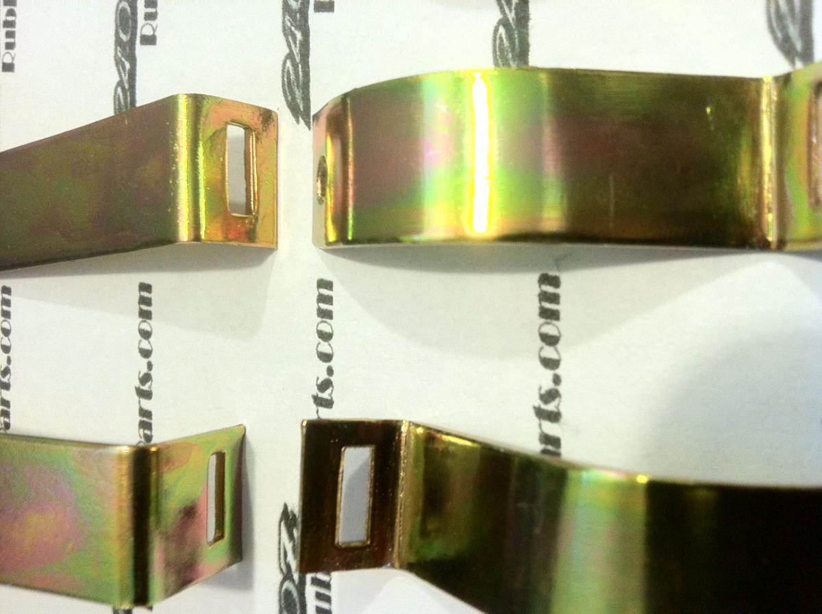

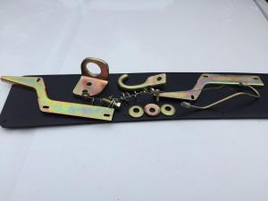

A few pictures of some of the last things I plated.

I have seen Steve's work and it is beautiful. He walked me through it one day when he was plating. I have notes somewhere...I believe Steve is right though to some degree everyone's setup will work a little different but you would think the overall method would be the same with just minor differences

Each part must be shiny to start with, I also make sure my zinc plates are shiny and clean and not dull. Agitation is a must when plating and I do use a small amount of zinc brightener.
Then it all comes down to your technique what will work with your own setup.
What works for me might not work for you, I tried many other peoples way and it just would not work for me.
very important is the prep and the correct calculation on amps to use, if this is to high you will burn your zinc plates and if it is to low you will get the same result as being to high, which is dull plating.
That is why you must do a lot of trial and error and figure out what will work for you. If you use to much brightener your  chromate will wipe off, to little and it will be dull.
Once I figured my setup out, I do it the exact same way even down to the seconds on some of the steps.
As funny as it sounds but seconds count on some of the steps.
