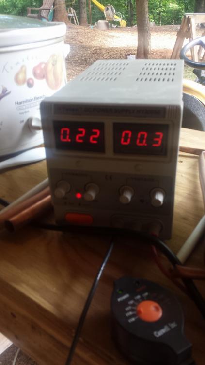

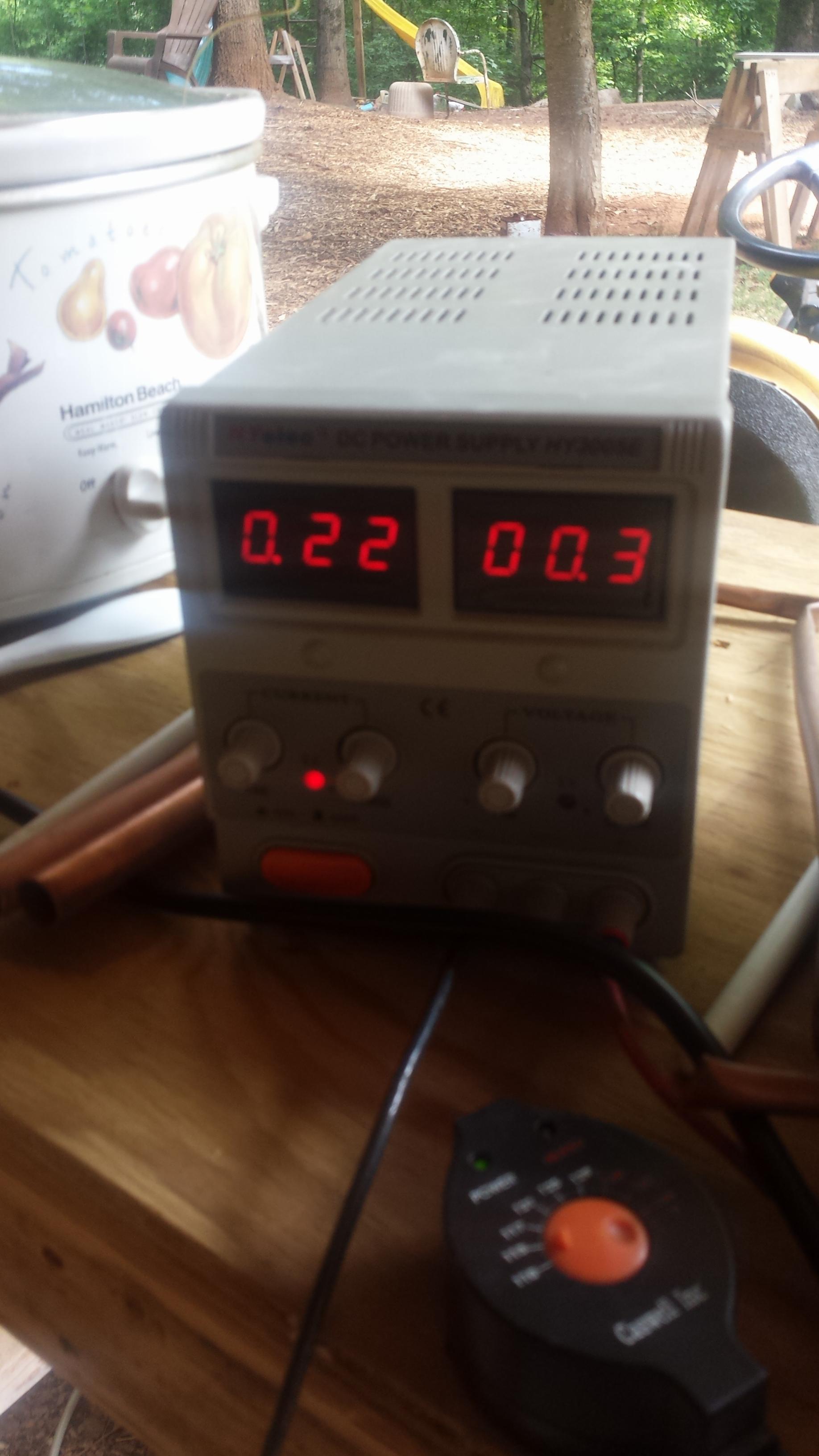

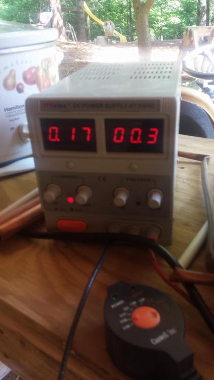

May 28, 20168 yr Author comment_495856 Ok. Today I messed with this some more. Set the Volts all the way up, Amps all the way down cut it on. Tried to crank the amps up and this is all I got without the resistor Added a 1 Ohm 100 Watt resistor, this is what I got Tried just the 1 Ohm resistor and tried to get the current up but no dice. According to this my power supply is bad... http://forum.caswellplating.com/forum/electroplating-questions/6724-my-power-supply-has-me-confused-can-t-control-current?t=6535 Edited May 28, 20168 yr by Patcon Link to comment https://www.classiczcars.com/forums/topic/51280-caswell-plating/?&page=5#findComment-495856 Share on other sites More sharing options...

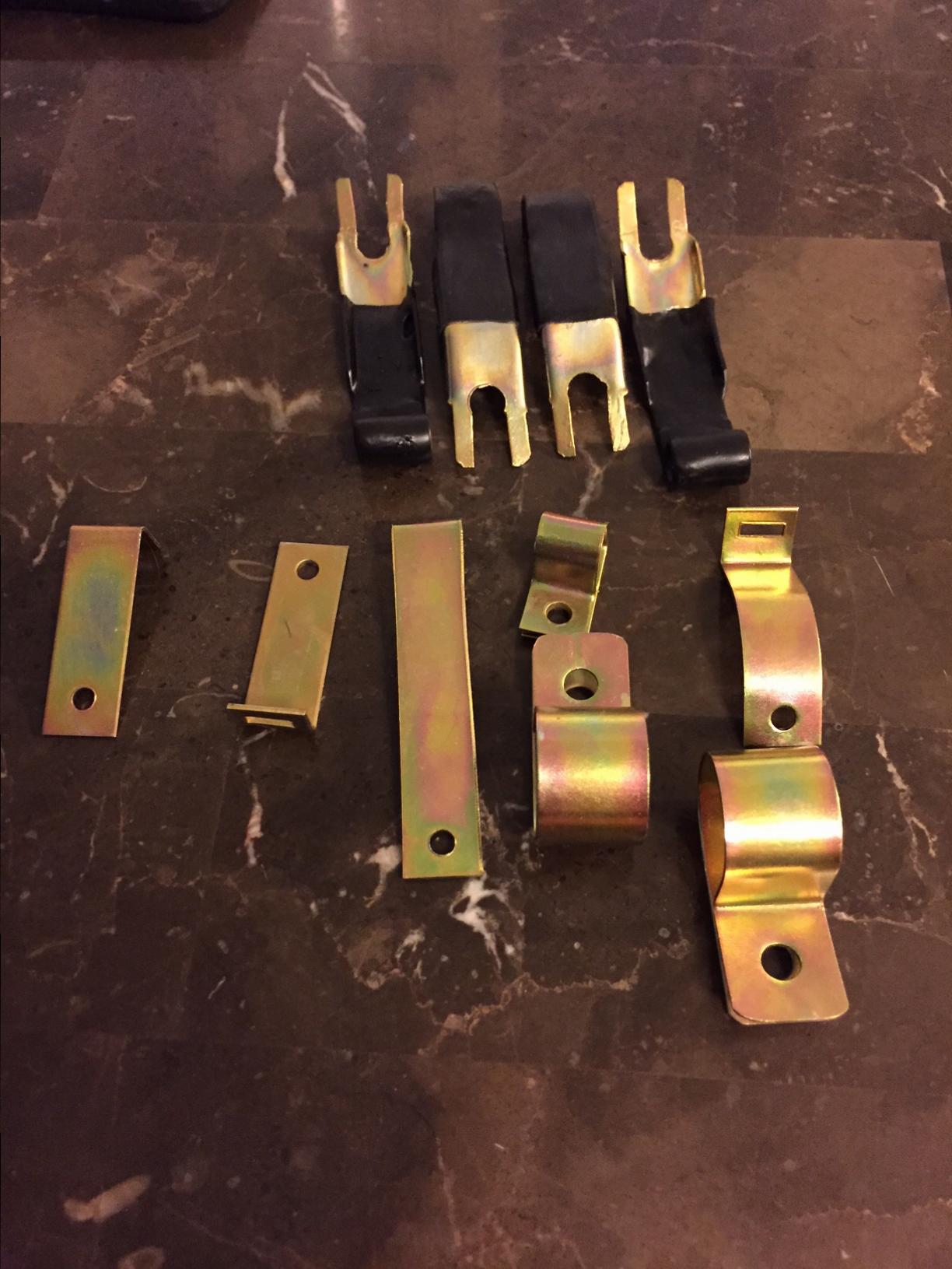

May 29, 20168 yr comment_495880 What is the part that you're trying to plate? Can you possibly add more surface area to your zinc anode? Pieces of zinc can be joined together by mechanical means, with a jumper wire for electrical connection, or - preferably - by a solder joint. Zinc takes solder very well, BTW. After reading the Caswell forum narrative, I'm inclined to agree that your power supply may be toast. Nevertheless, perhaps you could try exercising it with a more typical small-resistance load, just to see how it performs. I've used a double-filament #1157 bulb (front park-t/s or rear taillight) to good effect before I got access to a controllable-volt/amp power supply. They're surprisingly robust. Just solder 12" insulated wires onto the shell and end contacts, add some alligator clips and you're good to go. The cold resistances are 0.7 and 2.5 ohms (altho maybe higher with the filament heated up). I got my plating project fired up again late yesterday afternoon. I'm using a vinegar-and-epsom-salts bath rather than the Caswell electrolyte. I tried one 'big' part (ignition coil mounting clamp) and one 'small' part (brake line hold-down clip). Surprisingly (to me), the big part was easier to do and plated very nicely (it's about 20 sq.in. and I used about 3A, IIRC). The small part has proved to be a lot more challenging. I had to re-do it three times before I got a decent result. And I still need to do it a fourth time to try to get it right. I've confirmed that 0.3A is about right for this application. The L-shape of this part makes it challenging to get both legs plated and on both sides. On Attempt #1, the zinc wasn't really depositing. I had wire-wheeled the part prior to the acid bath and I now believe that my wire wheel causes problems (it's brass, mounted on my bench grinder). Maybe it's a burnishing effect, maybe the brass loads onto the part's surface, or maybe my wheel is contaminated with other stuff, I don't know. I do know that I'm not going to wire-wheel anymore parts before plating. Before Attempt #2, I took the part pack to clean metal by re-blasting (I'm using ground glass media). That helped a lot and now, back in the bath, I had plating happening. Unfortunately, I got greedy and cranked up the current to see what would happen. The zinc started to turn black. For Attempt #3, a re-blasted once again. Current now back to the correct 0.3A. After ~ 5 minutes I had a fairly good result -- except around the ends. The part was suspended in the bath using a copper wire hooked through the holes at either end of the clip. Apparently, the electrical field set up in the part doesn't 'flow' into the small areas at the ends of the clip (i.e. the parts of the clip that are 'outboard' of the holes). There's a very distinct 'half-halo' boundary around the hole where the plating visibly stops. For my next -- and, I hope, final -- attempt with this part, I'm going to solder the copper wire to the very tips of the part (on the back side, of course) so that the electrical path comes in the from the very ends of the piece. I'll let you know how it turns out. Link to comment https://www.classiczcars.com/forums/topic/51280-caswell-plating/?&page=5#findComment-495880 Share on other sites More sharing options...
